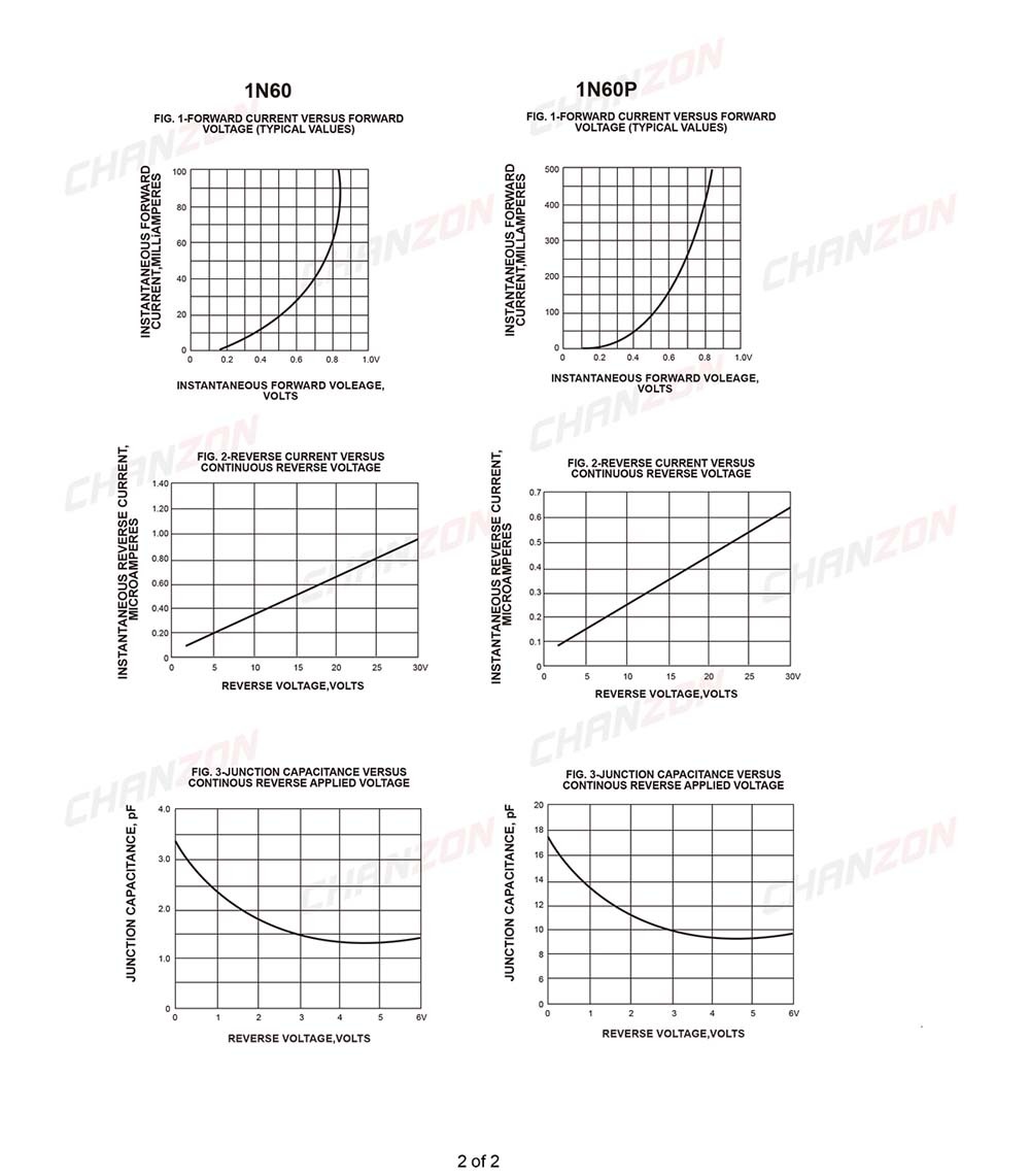

Attached are the best datasheets, I have found, of 1N60 and 1N60P. 1N60 is a low current diode and have higher Uf at a given If, compared to 1N60P. However, 1N60 has extremely low capacitance and is extremely fast. In most cases, I am interested in 1N60P, although,1N60 is, still, very useful.
The Japanese manual, which giver the dependance of Uf ( If ) at T, is for the low power 1N60. I would be happy to see a similar graphics for 1N60P. Most likely, the temperature coefficients are the same at scaled currents.
