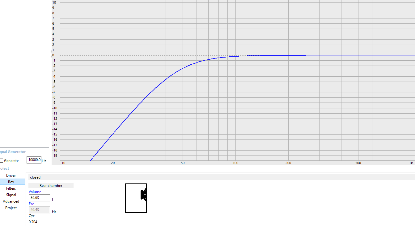

Hey Anmet,
I have attached a sim for this: Eighteen Sound - Professional loudspeakers, a superb 8 inch driver that I have used in small sealed box as part of an active system and using a little bit of Eq the results over the 80hz to 650Hz band are superb.
The Mms 14.9g / Bl 10 ratio is very good and the build quality is fantastic.
A pair hold 110dB continuous SPL (AES rated) and hit 116dB peaks if required, I used two per side in an MTM with a full ranger in between.
Hope this helps and good luck.
Alex.
