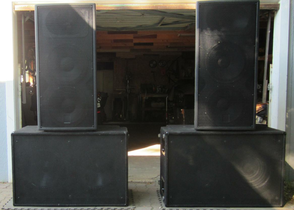

You can certainly get good results with a system like this, I have something similar that has no problem covering several hundred indoor or out.
My dual 18 boxes are flat to about 35hz but even with 2 drivers only manage about 100dB sensitivity so I'm not sure how they think a single L18G401 driver can produce a 102dB@1w sensitivity in a reflex enclosure.
The MT-130 is vey efficient but I think it will need a separate kick bin to fill in the 80-250hz range, that would help get the mid highs up higher when ground stacking but it adds another level of complexity and cost of course. Maybe a better solution is a dual 12+2(or 1.4) reflex.
My dual 15+2 mid/hi boxes cover from 80hz up and despite being just a reflex box they have no problem out running the subs, but of course the bass boost everybody likes to hear in a sound system is the main factor in that. The size of these things results in a stack almost 8ft tall when the subs are standing vertically, and this simple 3 way system sounds effortless and is very much a blank canvas that works well on any genre. It's probably not the ideal technical solution on paper but it handly outperforms every other speaker system I own which includes a whole bunch of modern pwered PA speakers, it literally is better than the sum of it's parts which are mostly unremarkable... the one exception are the CDs which are B&C DE750s. The system is triamped with a DCX handling processing and a rack of Yamaha P series amplifiers for a total of about 3kw per stack.. 2kw to the subs, 750w on the mids, 350w on the highs.
