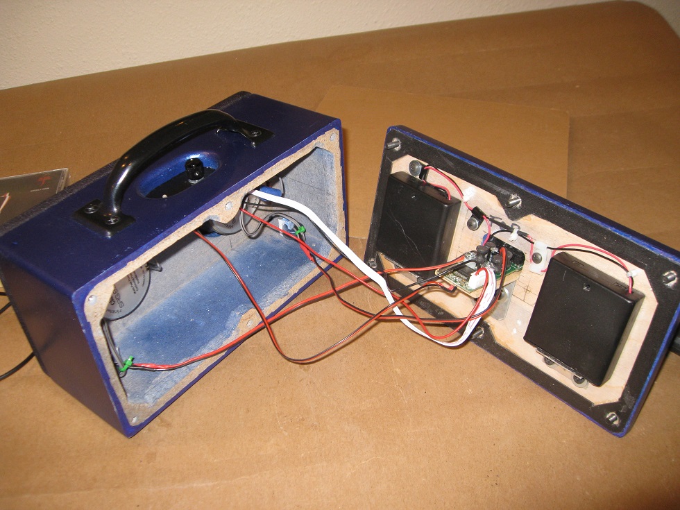

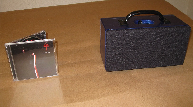

Here's a small boombox that I made. It uses a stereo amp module, and a pair of 3.5" coax car audio speakers. (not mono) Rear panel is removeable.
There are a lot of options for amp module boards to choose from (mono, stereo, 2.1, bluetooth, rechargeable batteries, etc.), and kit packages with everything you need for your own custom assembly. Dayton (PE), Sure, etc. are some to look at.
Happy building!

Thanks Dave!Here's a small boombox that I made. It uses a stereo amp module, and a pair of 3.5" coax car audio speakers. (not mono) Rear panel is removeable.!
If I wanted mono and a smaller size, I guess I could just cut it in half?
General question, I thought you'd need a divider between the drivers for stereo?

It does look like a great speaker! But even if cut in half to make it mono it's too big for my purposes. Thanks anyway! 🙂Have a look at Dayton Audio MKBoom portable bluetooth speaker kit.

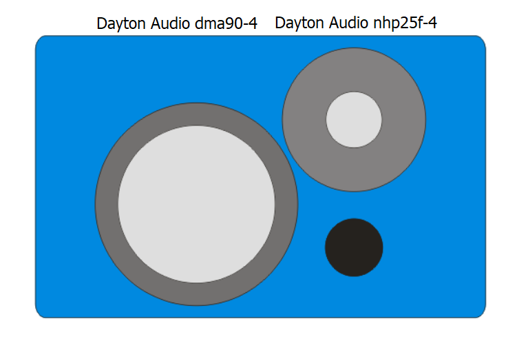

I'm happy to change some parameters! I'm also not married to the 2-way idea, if you think a fullrange speaker makes more sense.
Just to have some measures (external) to work with:
W: 20cm, H: 12.5cm, D: 10cm
panel thickness: 12mm, as Galu suggested
I made the size of the box just big enough to house all of the components, and still easy enough to assemble or disassemble to access everything. Sound quality was quite good even without a separate compartment for each driver.

Dayton Audio DMA90-4 offers good sensitivity, decent wide band capability. Simulation in 1.7 litres cabinet (8mm panel thickness), vented, tuning frequency Fb=75 Hz (vent 1" by 5.6" in L shape to fit better) should provide you with cut-off frequencies F3/F6/F10=98/77/61 Hz. There is absolutely no need for a PR plus the vent works better in this example, compared to dma90pr and dma105pr. Internal volume is still too small, 2.5 litres and the same Fb=75Hz (vent 1" by 3.5") achieves F3/F6/F10=75/64/56 Hz.
I would advise to first try this drive unit and the 2 way option leave for later if HF performance proved to be inadequate.

Thank you so much Lojzek! I'll put some more thought into it and figure out what electronic components I need to get. I'll reply here if more questions arise (I'm sure they will 😀)
