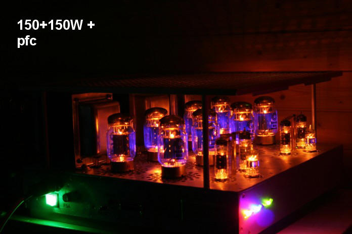

Garage foreourt enclosd

wow that amp is........ PORN......
My amp will be with dark wood and the trafos&tubes mounted on a polished bronze layer :devilr: with the trannys painted them black.
I want it to look really good as I'm spending lot of money on it... I live in Argentina, so... parts are far from cheap, imagine for a moment that building this amp will cost you U$s500... but for the money type change, it will cost me like to you u$s1500... :bawling:
Just to note; the amp in the pic can effectively shove 200W per channel, uses Svet winged C KT88's. I find these tubes are already pushed into the orange glow sector when Iq=60mA at 530V B+ and the anode heating power is reduced when pushed.
This isn't really KT88 performance, the NOS can easily breath 600V at the same quies current without fuss..
On the otherhand JJ Tesla 88 versions show no sign of sweating but give slightly higher thd. Despite the non attractive bulb shape they are more durable.
Building amps in this power class is a law to themselves.
richj
