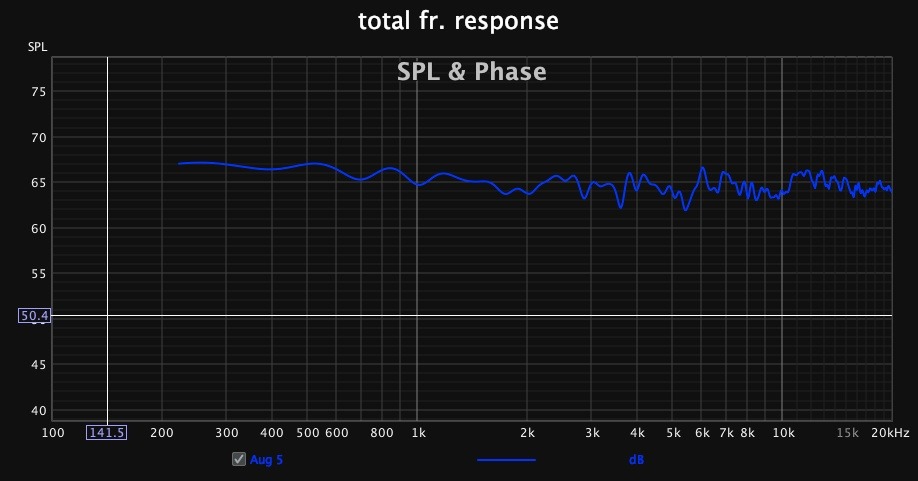

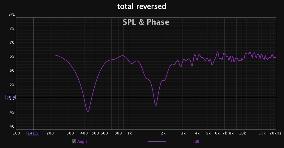

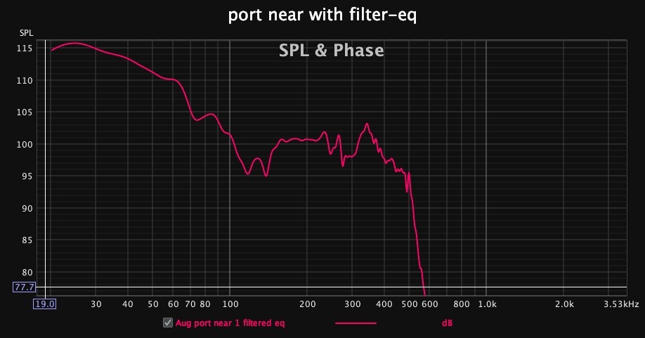

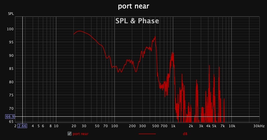

Hello to everyone, it is been a while since i last postet on this forum. I recently build new speaker cabinet for my seas excel drivers. I just need your opinion on the port frequency responce. I use the W26fx001 woofer in 60l cabinet with 70mm diameter and 260mm port lenght (front port). The port measurement shows that the port is working just fine in the low end but there is something at 200-500 hz. It doesn't affecting the overall speaker responce but what is that? port resonances? The woofer near responce dont show significant cabinet resonances. Or just the port noise due to the air blowing at the mic? You can see the port responce with the crossover filter aplied also. the cross frequency is at 400Hz LR24db and at 1600Hz LR24db. The other speakers are the W15ch001 and the T29cf002 tweeter. The speakers is active with electronic crossover using IIR for the filters and EQ and FIR for the LR filter linearization. And of course delays are also applied on the mid and tweeter. The speaker sounds great but just wanna know where the port energy at 200-500Hz is coming from.(can't sleep at nights 🙂 )
That looks like pipe resonance all right, with the half-wave resonance at 500 Hz and the full-wave resonance at 1 kHz, although 260 mm is short for those frequencies -- I'd expect 360 mm (speed of sound = 343 m/s so 1 kHz wavelength = 343 mm).
It will somewhat mess with your frequency response below crossover since the port output is only about 7 or 8 dB down at the crossover point, so about -13 or -14 dB from passband sensitivity.

So one solution seem to be lower the cross frequency? But i really do not want to do that. Stuffing the speaker cabinet lowers the overall port output, i have tried it. I have one EQ filter at about 500 hz with gain -2dB to lower the peak, that seems to work just fine. Are there any other solutions?

Greets!The speaker sounds great but just wanna know where the port energy at 200-500Hz is coming from.
What's tuning (Fb)? Regardless, the vent's (open cylinder) 1/2 WL resonance is < ~661 Hz once all end corrections are accounted for, ergo its output is between these two F's based on varying box acoustic pressure. A 7 cm dia vent = 7^2*pi/4 = ~38.485 cm^2 and the woofer's (Sd) = 330 cm^2, so with a good ROT of a min. 4:1 ratio unless there's only 'flea' power available your ~8.575:1 vent is apparently acting as a variably tuned whistle at typical box pressures.
