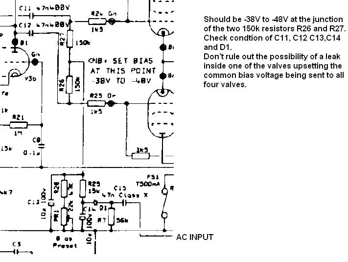

hey, so i have bought a Marshall jcm 900 sl x 100watt , re tube the amp head with Sovtek 6L6WXT , bought a bias probe kit, plugged in the probe, and the tubes are measuring 70mA! that's hot right?! i tried to adjust the bias trim pot, but the bias reading isn't moving! can anyone on these forums help?
If this is a second hand amp you could have a leaking coupling cap to the power tubes! Or the bias supply may be at fault.
As Hi-Q says you need to start by measuring the bias supply!🙂

hey, the slx is a 5881 tube amp, but thought the 6l6wxt was a 5881 type/ new replacement of the 5881, as for the coupling cap what is that, i have an understanding of tube amps but might need help with some parts of the amps, as for the attachment i will measure the resistors thanks for the schematic, thanks

The coupling caps are C11 & 12 on the drawing from Hi-Q. If this has only happened since a re-tube of the amp then tube type is suspect! Linked to bias voltage.

i threw the other tubes away as one of them blew when i used it for 2 hours /the tubes where already in the amp, the amp was bought second hand but the original tubes where tube amp doctor 6l6wgc, as for the measurement of resisters 26 to 27 i could only get a measurement of 140k ohms i dont know what setting to put the multimeter on
Its voltage DC that you need to measure.
It is the bias voltage between r26 & r27 to ground that you need to check.

Just for interest, if you can increase the current through the tube but not decrease it, then the -bias voltage is to low. This would require a mod such as a voltage doubler on the bias supply.
Also check Fs1 fuse is not blown!

i measured the current of r26 and t27, both measured 42volts, ii put croc clips on the resisters and one on the ground so i did not have to put my hands in the amp, so the measurement of r26 and r 27 is fine right?

All my Marshall JCM amp circuits I have indicate EL34 output valves. Your last post is confusing as you should be measuring Voltage and not Current. The correct voltage monitor point is shown on the bias circuit I attached, namely between chassis and the junction of the two 150k resistors. This voltage should be adjustable using the bias control and I would suggest you set this provisionally for maximum negative voltage. Then check that a similar voltage is obtainable at the junction of the 150k and 1k5 resistors i.e. Junction of R24 and R27 then junction of R25 and R26. Any large shift to a positive value could be caused by leaking coupling capacitors C11 and/or C12. Also a leak within either of the output valves or their bases may cause this.
Remember you are working with parallel pairs of valves, a good one with a bad one beside it will upset the good one!
Heed the warnings given about high voltages, the energy stored under certain fault conditions could very easily attract the attentions of your local undertaker.
Take care!
P.S. As there is only one control for biasing, it would suggest that a matched quad set of valves may be required because you ideally want all four valves to draw roughly the same current with the same common bias applied.

hey, i will just re tube the amp with new tubes, as some of you said it could just be the tubes right? but all the tubes are reading 70ma
also when i was measuring the r27 and turning the bias pot the current did change, does that show the pot and resistors are working?
it would seem its working, but it seems there isnt enough negative voltage for a much lower current
