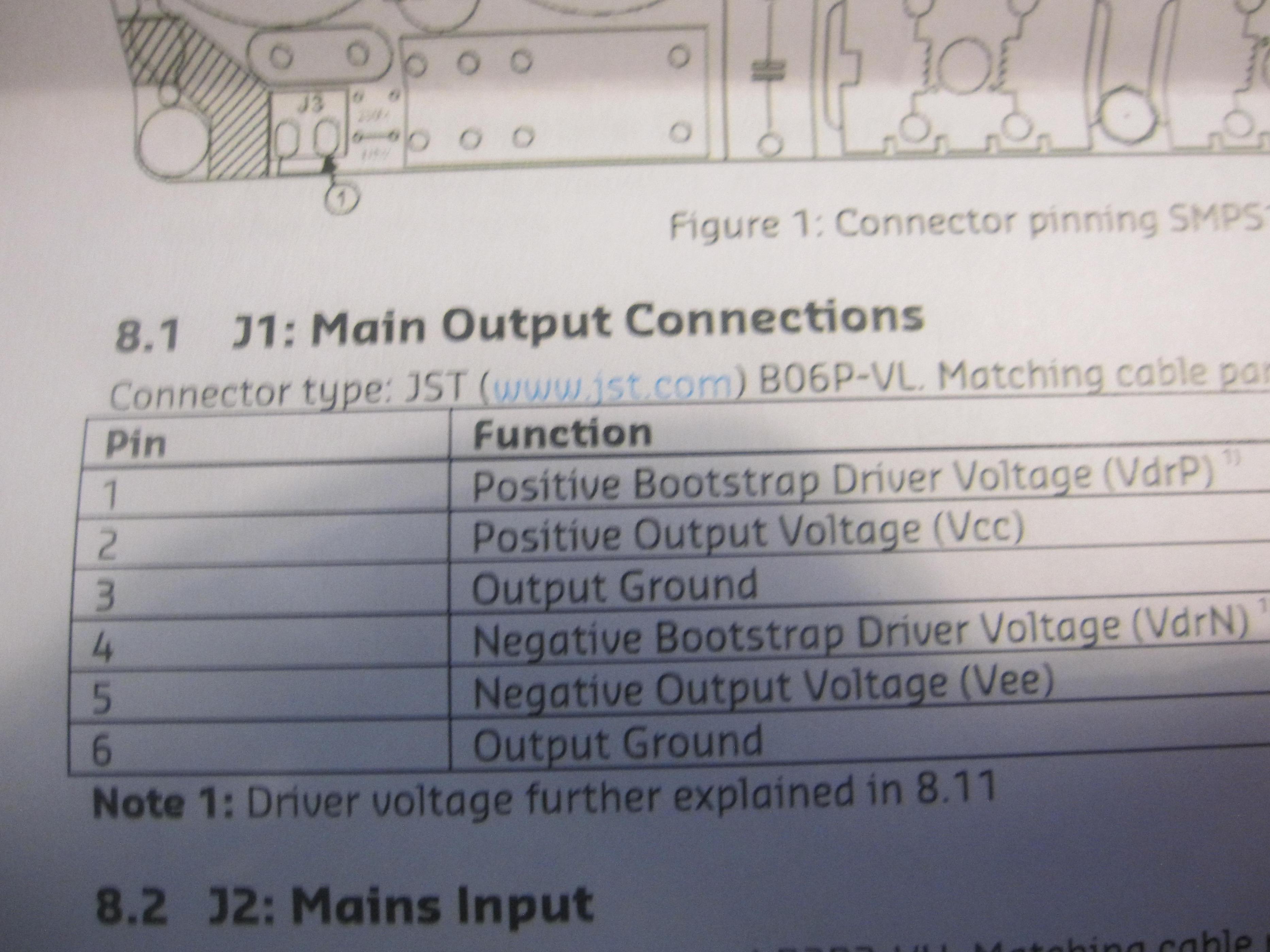

I connect 120VAC to J2, install jumper on J3 and relay clicks but I don`t get any readable voltage on J1 . Is there some kind of trigger needed?

Are you testing between pin 1 and pin 3 or 6 (ground)?

I`m testing 2-3 and 5-6. according to Hypex papers that`s where main voltages are.

got reply from Hypex:
Supply should switch on once the mains is applied on J2. For 115 operation J3 should be shorted. Other connections are not required.
Tested and got about 66V on pos and neg side, so it works.

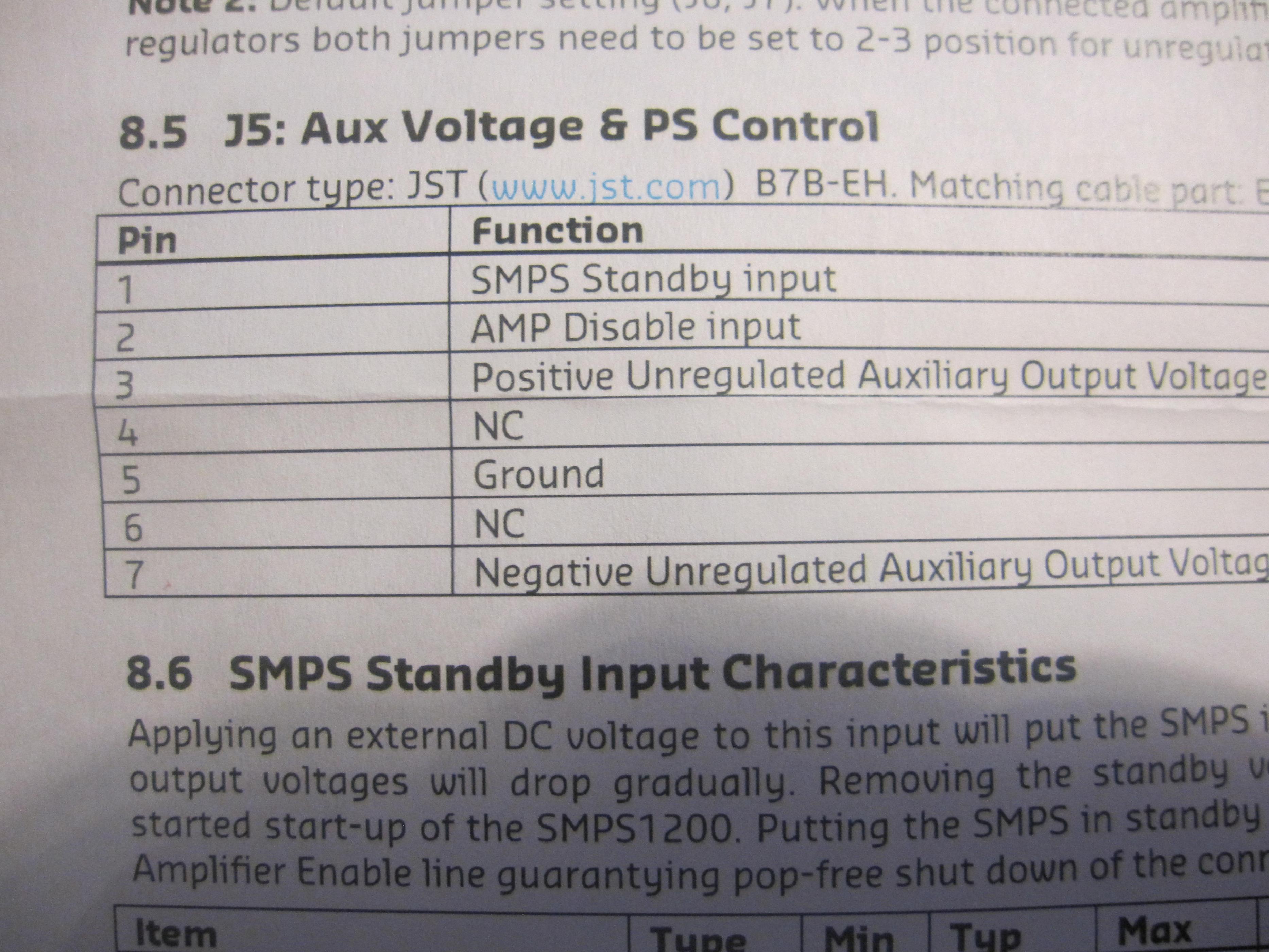

I did nothing appears damaged at all on the back. I shorted pin 1 to ground with my multimeter. I had the stupid thing plugged into the MA hole instead of the DC Volts. And pop!
mosfets? shorted mosfets will show shorted in PCB. no need to desolder. If there is no relay clicking on turn on I`d check that rectifier as well.
Bootstrap is secondary voltages,correct? What about mains?

It powers something on the amp that requires power to operate 🙂. It must be tied into the auxiliary voltages as well. As I have no power coming out of the Aux supply anymore either.
