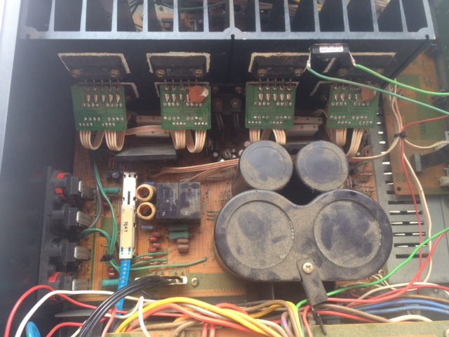

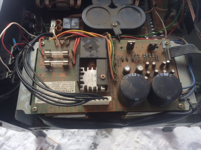

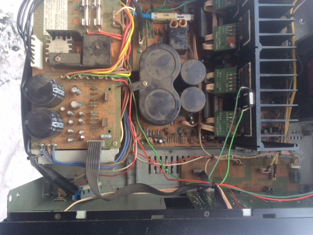

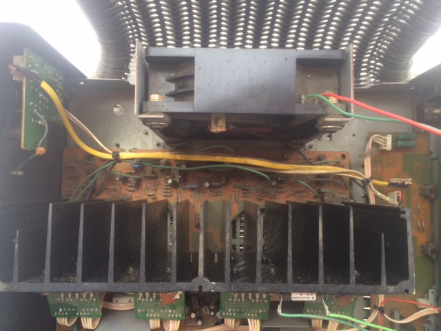

I just got a hold of a Kenwood M2A amp, hoping to fix it. When the unit turns on the power LED flashes (speaker protection circuit?)

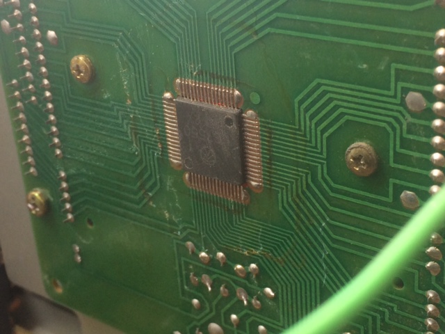

Everything inside looks clean except for 1 patch which controls the front panel meters. Any help on where to start much appreciated! Thank you.
First thing I would do is give that unit a thorough wash and clean... internally it would come up like new... I hope the case work is unmarked 🙂 It looks to have had a hard life tbh.
As to fixing, get yourself a manual (HiFi engine ?) and check the basics. Rails, DC offset and the quiescent current of the output stage.
