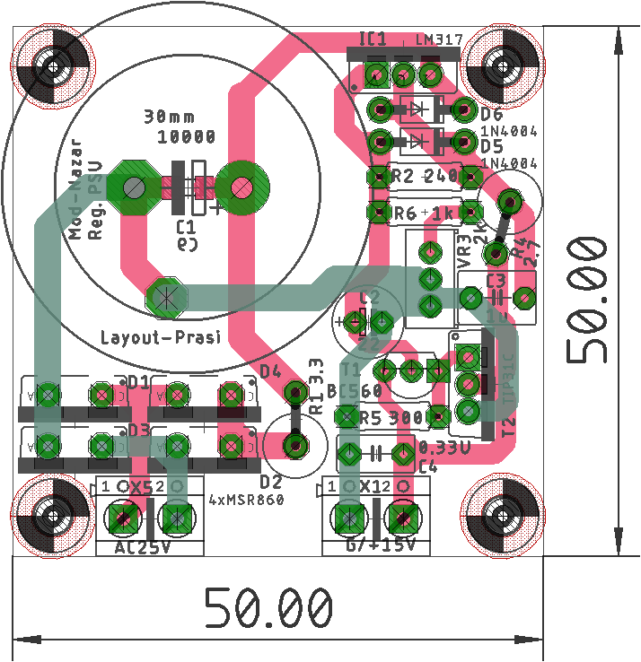

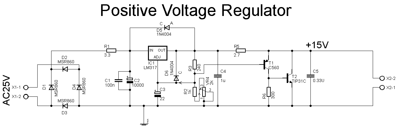

here is a simplistic and compact lm317 pcb design that i did long ago.

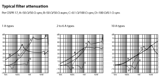

RFI rejection -- Are you concerned about high frequency noise on the AC mains, which is not rejected by your voltage regulator IC? This noise is beyond the right hand edge of the PSRR graph in the regulator datasheet, i.e., higher frequency than the chip is designed to handle. Do you want to install countermeasures which attenuate incoming noise above 20 kHz? How extensively?
I am using this power entry module which has some filtering built in. The datashett is here. https://au.mouser.com/datasheet/2/355/FN 280-707113.pdf
I have included a graph of the attenuation below.

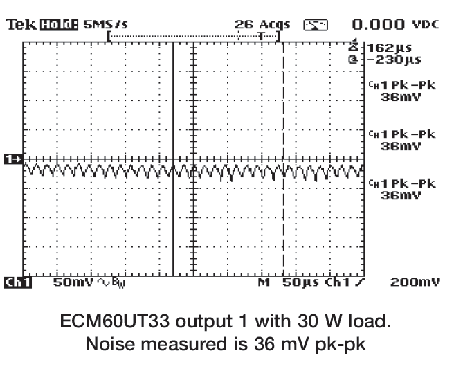

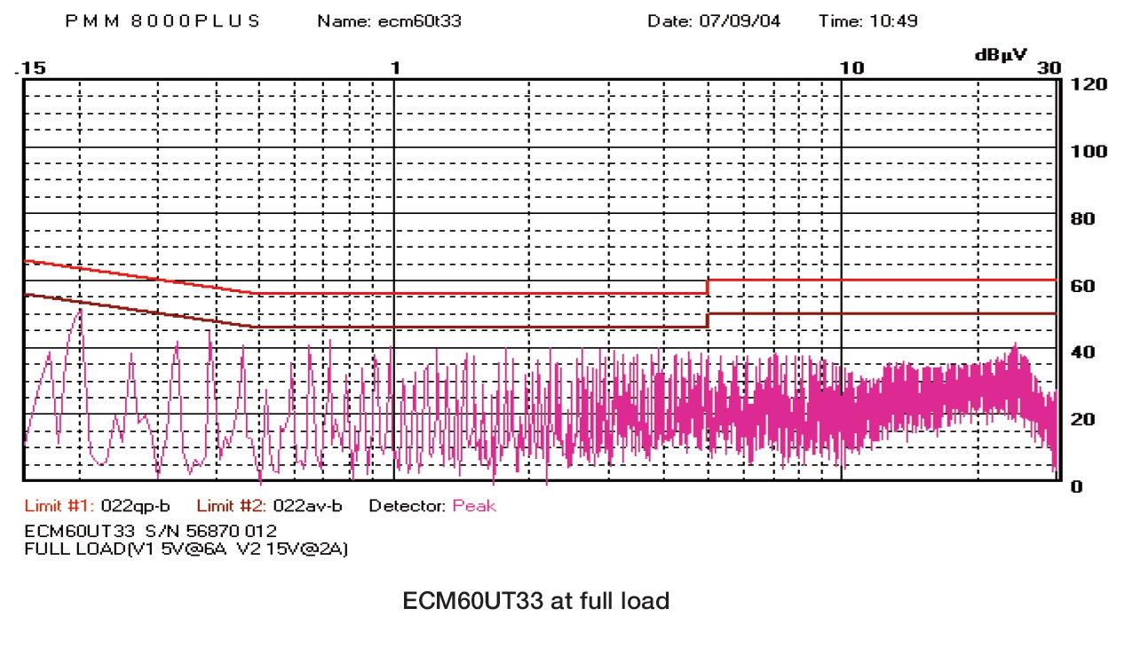

Thanks Rick. The SMPS has 70K switching frequency. Below are some graphs of ripple and noise (slightly different model number but same 5V primary output circuit, different voltage secondary output to mine). What approach do you think I should take to "moderately filtered" with this as a starting point.
