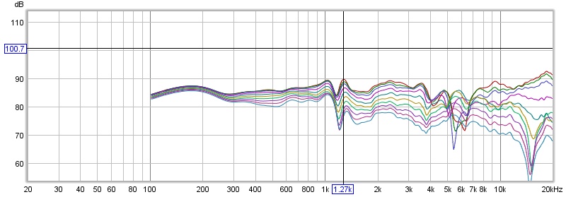

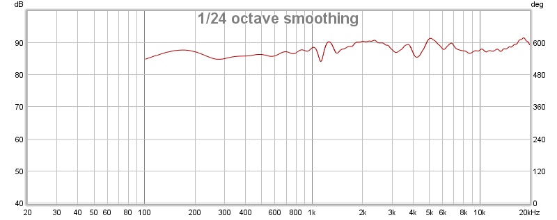

I used to have a pair of R15's, so if they are the same as the T15 as was suggested, I would recommend designing a new crossover for the speakers you have. As I recall from the analysis I did of my R15's, the tweeters are pretty decent and measure pretty flat, if I recall. The woofer has an a resonance around 1.25kHz that adds some coloration and I highly suspect that it's a major contributor to the "voices sounding like they're coming through a tube" described in that review, but I can't say how objectionable it sounds to you.
The big issue with them is the first order crossover at + 4.5kHz, in their stock configuration, they're at their best with the listening axis about 20 degrees below the tweeter, that's about where the drivers sum properly. Redesigning the crossover should make those speakers sound much nicer.

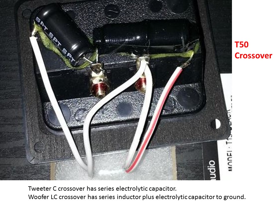

It would be worth the effort plus education to design a superior crossover with modest cost L-R-C parts for one pair of T50 drivers and listen before you make a larger investment.
1) Open up a pair of T50 speakers and confirm that the tweeter crossover is a series connected single electrolitic capacitor..... and the woofer LC crossover is a series connected inductor plus electrolitic capacitor to ground.
2) BIG GOOGLE search for alternative T50 crossovers already built by smart people.
NO LUCK.... THEN
3) Study how to make basic T/S measurements of each driver. If you have a mic you can also learn how to make SPL measurements.
4) With these measurements.... Ask diyAudio community to design a good crossover. probably 3rd order C-L-C on the tweeter and 2nd order LC on the woofer. A series resistor in front of the C-L-C tweeter crossover will allow SPL balance with the woofer.
Interesting information. I am definitely hearing a midrange resonance but just going by ear I thought it was around 2khz. Okay I like where this is going. I’ll open one up and see if I can indentify the cross over components.

The woofer crossover is just a series inductor. Can you measure the inductance on this part? The DC resistance of tweeter and woofer? There are several tutorials on measuring T/S parameters and SPL/freq. Download free sine sweep generator + voltmeter + known mass(coin).
Design a good crossover, like C-L-C on the tweeter and LC on the woofer. A series resistor in front of the C-L-C tweeter crossover will allow SPL balance with the woofer.

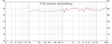

Okay, can I just proceed with @aslepekis measurements or Better to do my own? I have a multimeter, oscope, signal generator, recording mics, etc, but if this is already the info needed would rather save some time.
I’ve read a bit about crossover design. There is definitely a lot going on. One question I have is this.. what I’ve learned working with music and recording is that things that should sound good don’t always, and vice versa. What I’m getting at is do any of you find it is more productive to do a general design and then just trial and error component values to find the sweet spot?
