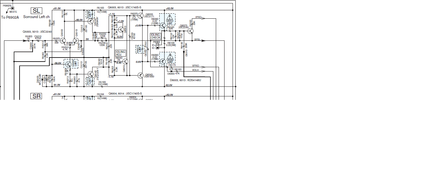

I recently picked up an onkyo ht-r667 to try to repair. It powers on but turns back off right when the relays click with a blinking standby light (i assume thats protection mode.) at first i suspected a damaged dsp because it seems like caps were added to the dsp to fix the hdmi problems that is apparently common to these units. But i found a pair of shorted output transistors, so i have removed them. Can i power on the receiver without the transistors in place to see if it will go into protect? I want to be sure they are the cause before i try to locate a replacement. i also have plenty of MN2488 + MP1620 in my parts bin, could i drop those in as temporary replacements to see if it will power on? the originals are c5242 + a1962. Thanks for any help!

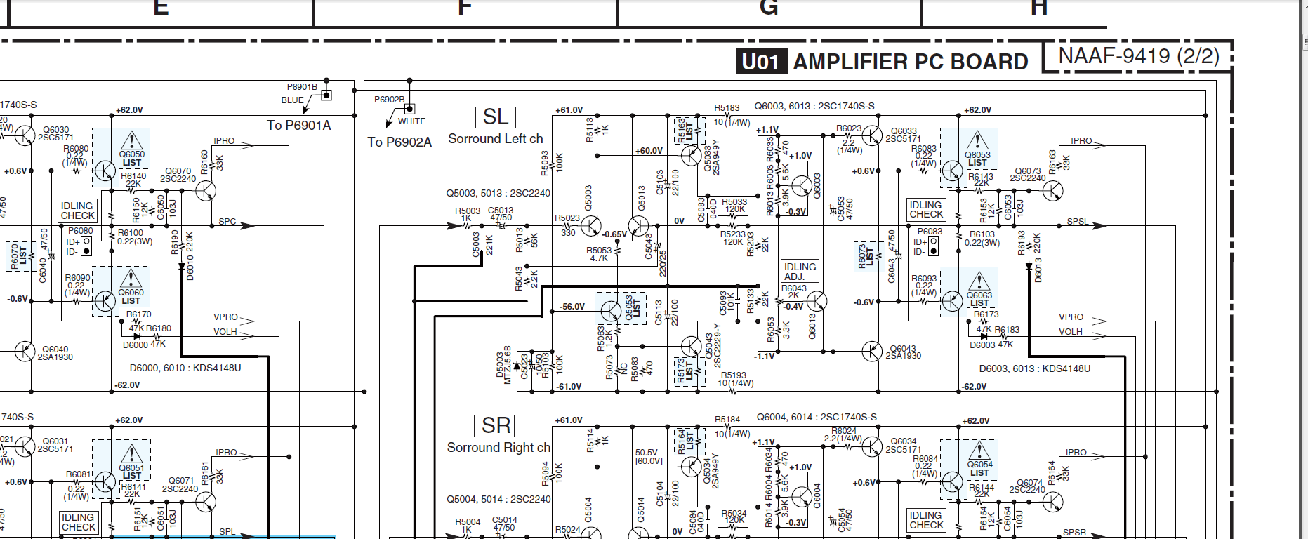

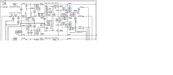

Thanks! hopefully thats all there is too it, i do not plan on using surround channels. I have attached the schmatic for the damaged channel. Thanks.Yes, it will work provided you remove the faulty transistors. But then, you will have take care of any supervisory connection that detects fault.

if you connect a 1500 ohm/2W resistor between each B-E connection of the place where the output transistors go, it will close the feedback loop and you can test the channel that way. you can apply signal to the channel and get a waveform out.... but make sure you don't connect a load.....
Very helpful info, thanks! i do not have 2 watt resistors though, i have lots of 470ohm .25 watt resistors. ive put 12 of them in series parrallel to give me a 1.41kohm resistor at 3watts, is this value close enough? I put it across the two outermost legs of where the transistors went? and the waveforms i hopefully get out will be at the speaker terminals? Thanks, hopefully ill have it running soon!if you connect a 1500 ohm/2W resistor between each B-E connection of the place where the output transistors go, it will close the feedback loop and you can test the channel that way. you can apply signal to the channel and get a waveform out.... but make sure you don't connect a load.....

I have decided to continue working on this amplifier over my holiday break, so far i have reset the idle currents on all of the non blown channels (they all are in spec now) I tested the output signal of the blown channels with resistors substituted for the blown power transistors and there is a clean audio signal present on the speaker terminals of the blown channels (so that means the drive circuitry is fine?). I just installed new power transistors, but the amp draws excess current upon power up, it shuts down after 2secs. The idle current on the channels i replaced goes up to 1.6volts. I checked the adjust pots, and they are not the issue. What other components do i need to check next? thanks for any help! and forgive my ignorance, im still trying to learn.
