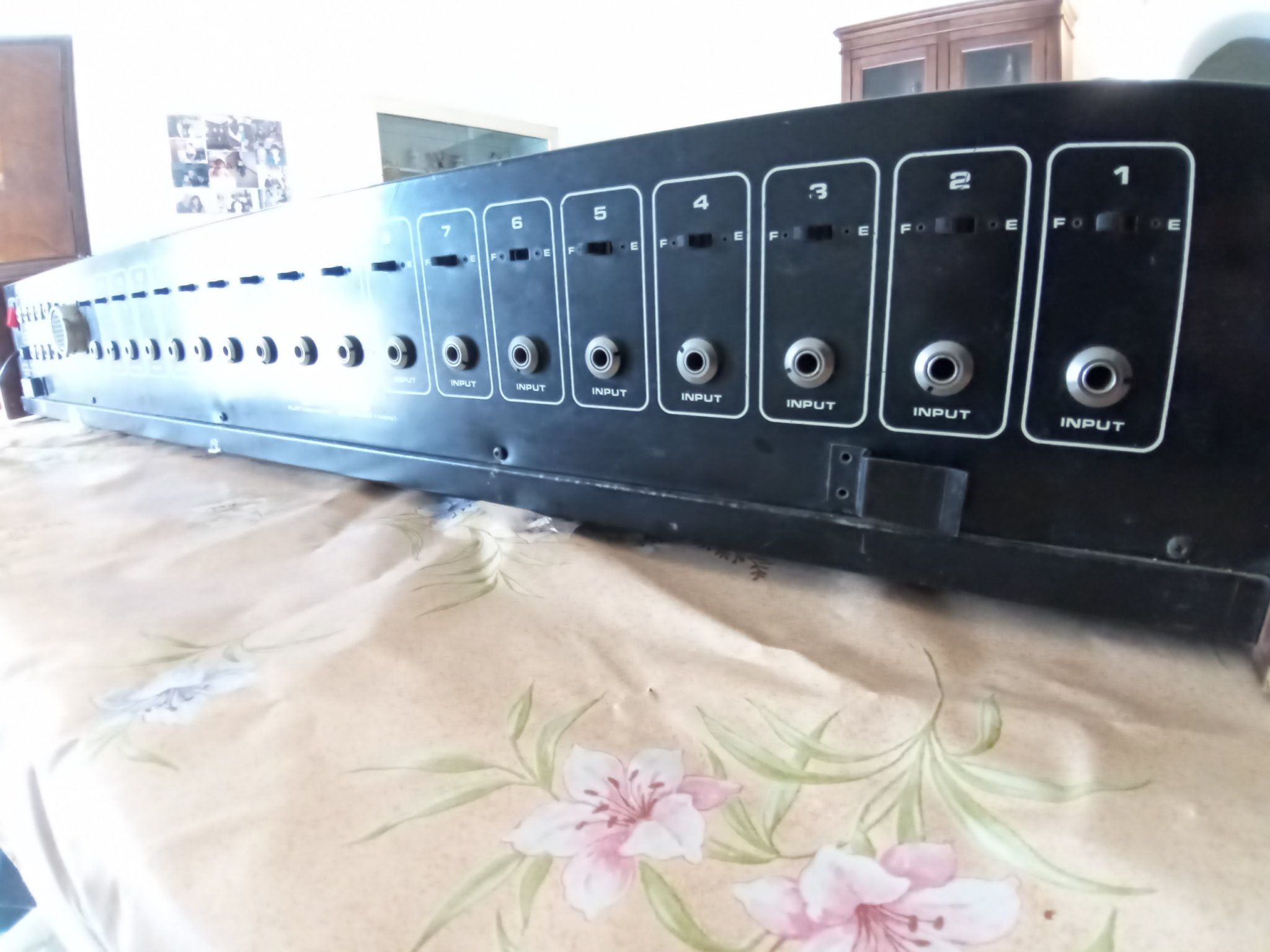

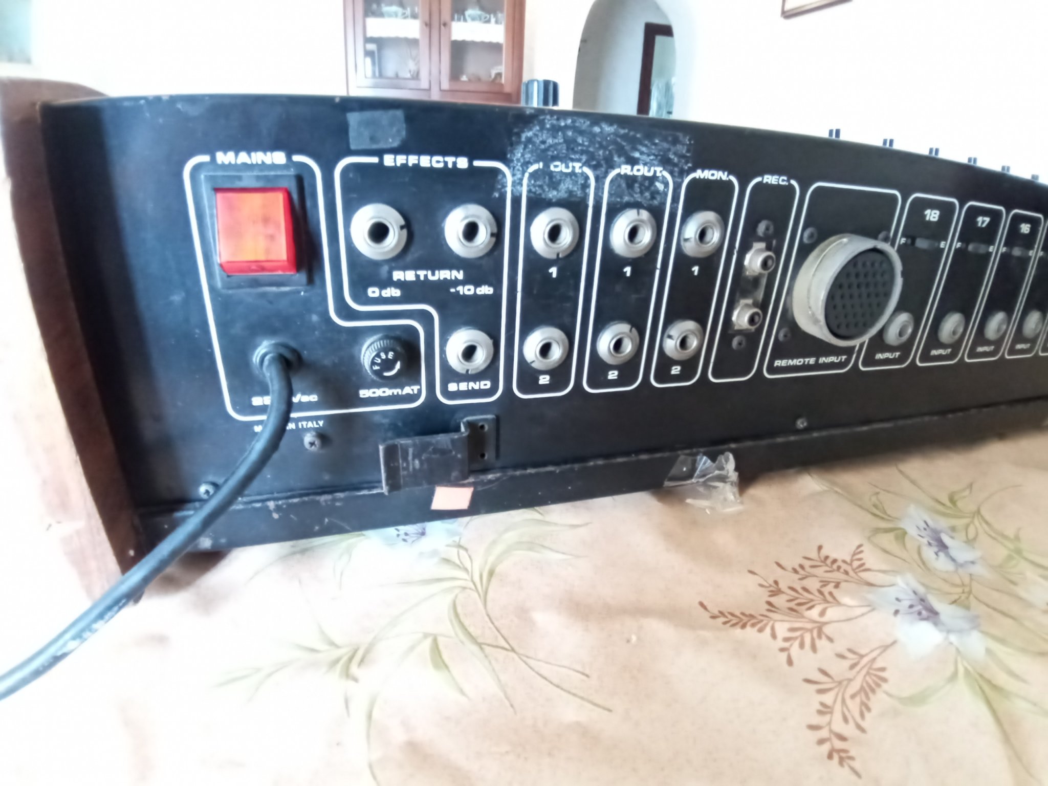

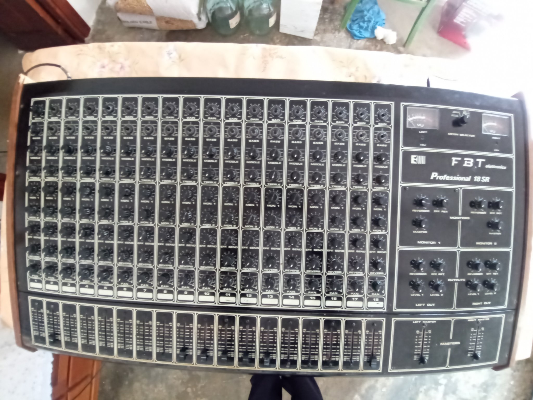

Decided to finally pull out from the shed my old analog mixing desk , it's an italian FBT 18SR from the 70's , 18 channels , I'm planning to use it for my drum kit , but before that, I want to test all channels real quick.

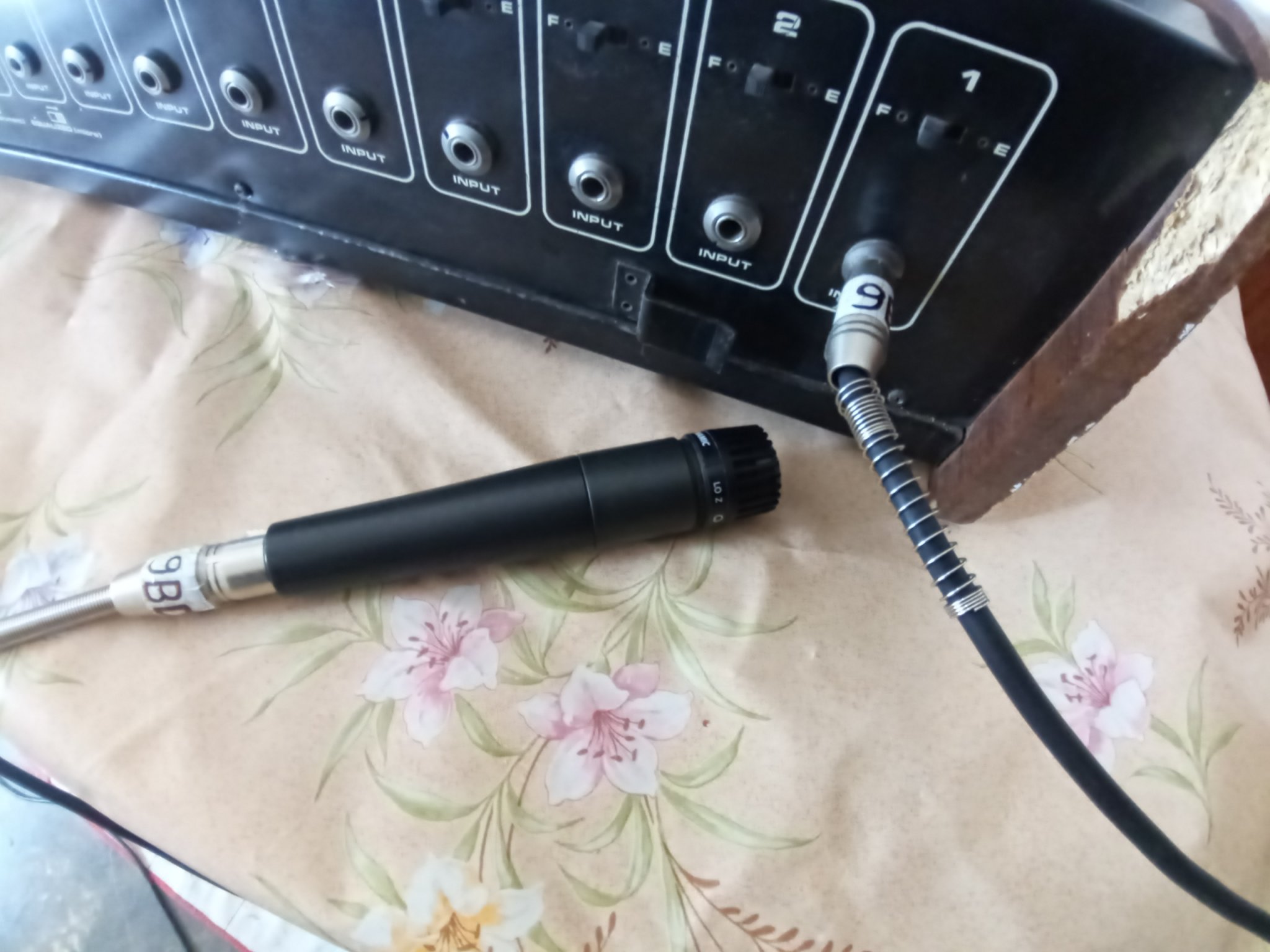

Being a very old mixer , it only has TRS jacks (mono) ,to test it, I was thinking to hook up an SM57 to channel 1's input , insert a mono TRS cable into one of the outputs (Either Mon 1/2 or L/R outputs and connect it to a guitar amp (in this case a VOX AV60 , or a couple of speakers (w/preamp) that use RCA jacks. Not getting any results , (because I have no idea what I'm doing) , so I ask you kind experts: what are the different ways to hook up this mixer to test it? Just to get a sound.. , I'm sure I'm making ridicolous mistakes!
Apart from trashing this old lady , I'm willing to hear your opinions!

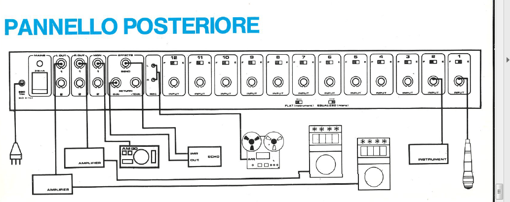

You might try contacting FBT to see if they can provide a manual, since it doesn't seem to be freely available on the web.
short of knowing more about the console and it's pinning standard i would try a different channel, insuring that standard things like gain and other appropriate things like the faders both channel and master are at nominal levels that should allow signal through...
this poor thing looks like it's lost many of it's knobs and fader caps!
TRS jacks can be used for "stereo"(but that's a whole different application) but in the case of a mic mixer they would be "balanced" just like an XLR with "tip" being" positive", "ring" being "negative" and sleeve GND, so depending on the pinning of the cable you have you may not actually be driving the "differential" input of the mic pre's. and that could also apply to the outputs...
i must confess i'm stumped as to the function of the switches on the channels designated "F" and "E" i've no idea as to whether or not they are a pad or gain type selector (try switching those?)

Don't worry I have the rest of the original knobs! (not the faders though , sadly) , that "F -E" stands for "Flat" and "Equalized" , I saw this switch in many 60s/70s Italian mixers , "E" cuts low-mid frequencies off the channel , nothing special
I see what you mean, all about the right cables.. what about in a stereo application? How could I quickly set this up for testing?
Are you sure the inputs are meant to be microphone inputs? If they are line level, you will have to shout very hard.
I had the same question... usually mic inputs have XLR connectorsAre you sure the inputs are meant to be microphone inputs?
I don't wanna be spitting lies , but I believe so! I just had a long phone call with the phone-lady at FBT , she put me in contact with this old tech and I managed to get my hands on a basic "manual" of the 18SR, check out the wiring:Are you sure the inputs are meant to be microphone inputs? If they are line level, you will have to shout very hard.
What is a mono TRS ? Do You mean XLR to TRS balanced cable ?insert a mono TRS
Use a XLR to TS cable not TRS unless ring and sleeve are shorted.
Do the VUs move when speaking to the mike ?
If they move, Your problem is in the output section /cables /power amp.
Try a line level source like a CD player or even Your phone.

0) I am "an old Tech from way back then" so pretty familiar with this kind of mixers, including FBT, LEEM, and all other Italian mixers (including the mythical Semprini).
And TRS 6.35mm jacks were the most used ones
Same era American mixers (think Peavey or Acoustic or Kustom) even used plain TS jacks, go figure.
Proud Germans (think Dynacord or Echolette) stood by their own very impractical DIN connectors.
1) make an adapter cable.
2 versions, one or the other should work with your mixer
* Plain TS plug (unbalanced similar to Guitar type):
XLR TS
1 Ground/Sleeve
2 Tip
3 Ground/Sleeve
try this one straight into your VOX guitar amp, it should work.
Maybe not too loud, since output is weaker than a guitar pickup but you must hear sound through speaker anyway.
If not, either microphone is damaged or wiring was improperly made.
TS plug cable should work in FBT input, since it also accepts Guitars with obviously that kind of plug.
IF it works, then rewire to TRS simply to have better hum rejection.

Ok JMFahey, before making the adapter cables here's what I did:
I plugged my guitar into the FBT's channel1 input (with a basic TS cable) , then I extended another TS cable from the FBT's Left Output1 into the VOX's main input (maybe I was meant to plug it into the VOX's "External Speaker Output" or "Phones" or "Aux In" jack , dunno) , no sound at all , THOUGH when I fiddle around with the TS cable that goes into the FBT's output it starts humming and suddenly it becomes ground "ground sensitive" (pass my stupid term) , when I touch the guitar strings OR the FBT's chassis the humming gets much louder .. no guitar output though.. VU meters never moved
I never claimed to be anything 🤐 off topic anyway ,let's get back on the mixer!weird if a guy claims to be a drummer but has guitar gear what can you believe...
Thanks so much for your help! I took a peak within the chassis and I noticed that many ceramic caps have big cracks on them (not that circuit issues can be detected with a naked eye), I have spotted different ICs , tomorrow I'll test themNice find. Good collection of jacks, pots, case. Could be useful in a home studio but not for field recording. At least it is stereo.
