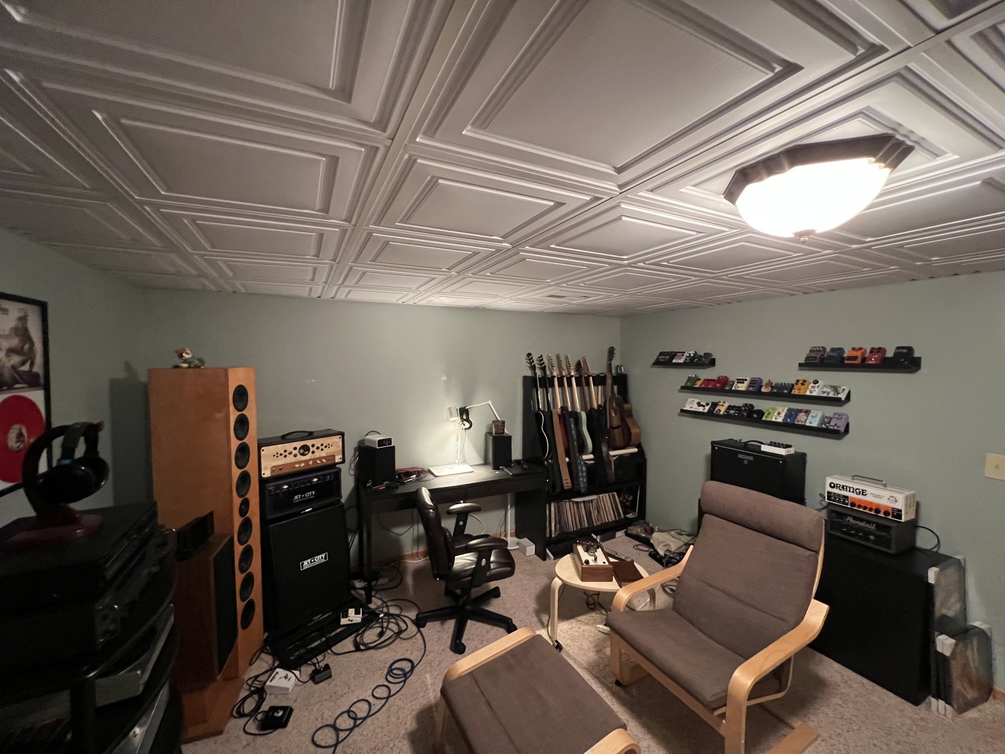

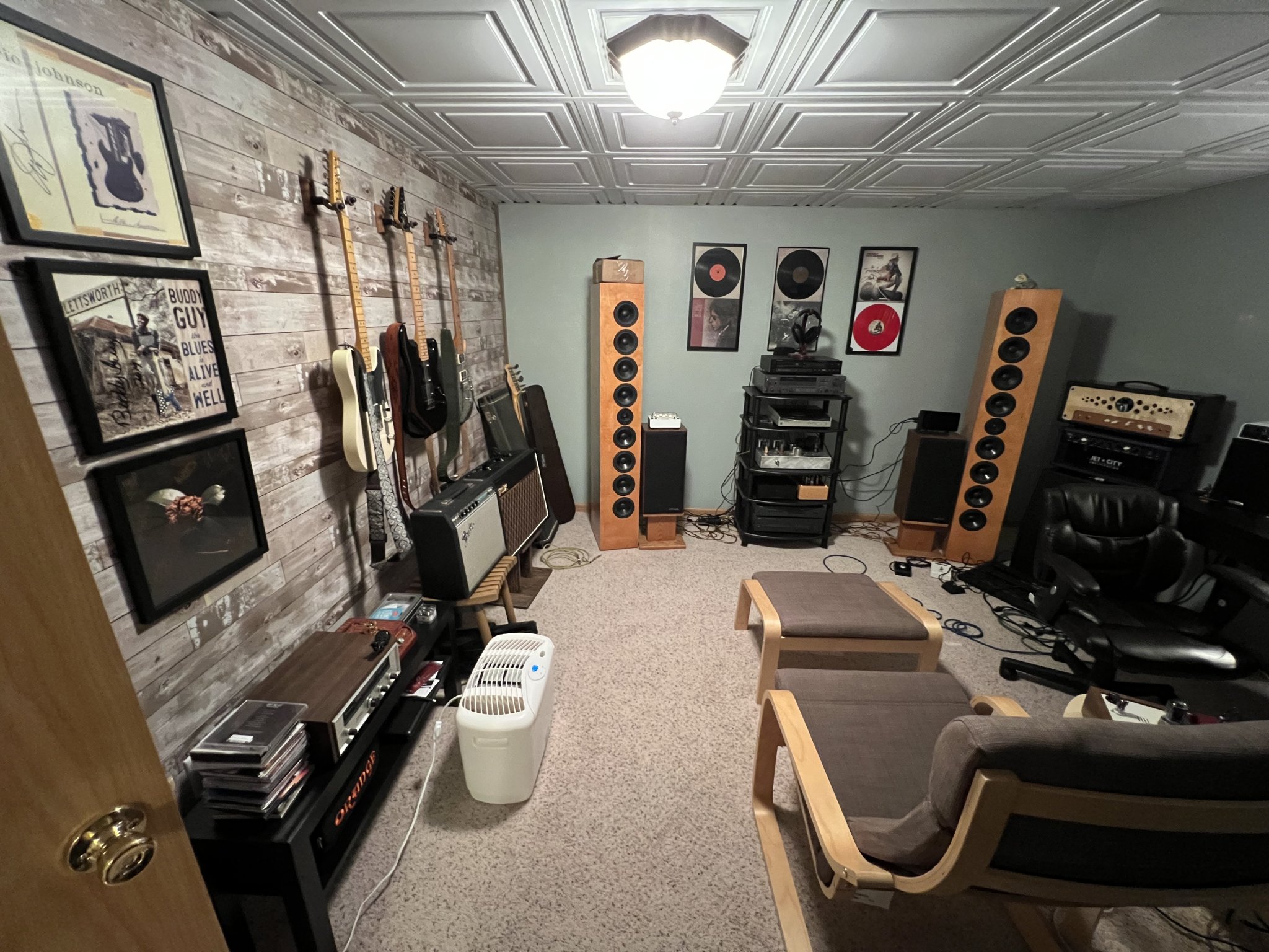

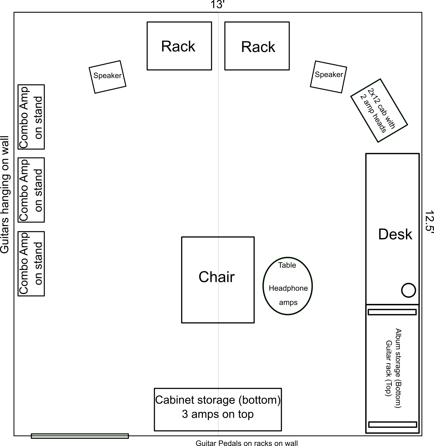

I downsized in the last few years to a 12.5’ x 13’ room in our basement. It has a suspended ceiling with the thin plastic decorative tiles in it. Unfortunately this has to be my music and audio room combined and I’m at a loss as to what to do with it. Essentially every square foot of floor space up against the walls is taken up by something so I’m thinking I may have to go near field. No room treatments and I’m thinking about ditching my mostly budget stuff to start over (except my old Polk Monitor 5B’s which are currently getting a complete xover redo with upgraded tweeters - nostalgia). Here’s a close approximation of what I have going on.

Check the line of acoustimac absorbers for the wall behind your speakers and possibly to the sides. Something to deal with first bounce on the ceiling as well. My basement room is quite crowded and not a whole lot larger.

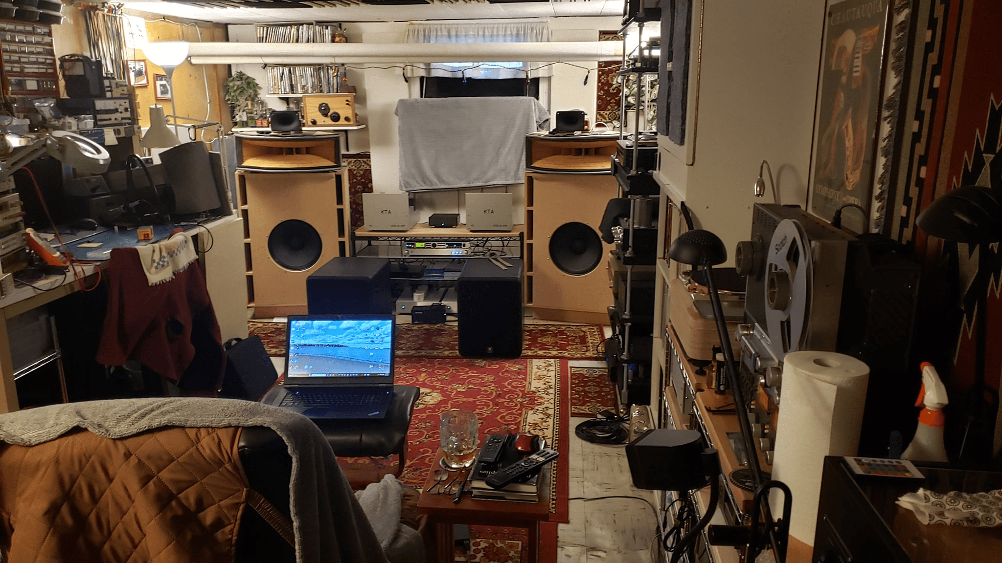

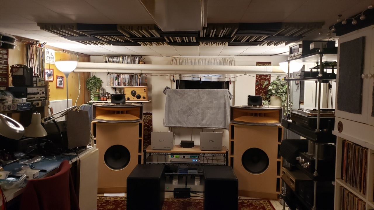

Here is a diagram of my room, clutter does not quite describe it. I somehow manage to get fairly decent sound in here. If you look closely you will start to notice a lot of things relating to room treatment, and just how many obstacles are present in the sound field. (Main space is 200 sq feet, and about 21 sq ft on the left side which opens into the rest of the room. Undesirably there is a door sized opening directly to my left which needs to be blocked during listening. (Measurements confirm a benefit, but how to do it conveniently has not been solved yet.)
View from my listening position.

I was able to arrange stuff along the walls a little more. Let me pull my speakers out about 3.5’ from the front wall. 5’ apart, 40” from the side walls, with my ears about 9’ from the front wall which leaves 3.5’ behind me. They are toed-in an 1” and tilted 1/4” up (about 1.5 degrees). Much, much better. I used to run them this way (pulled out) but farther apart. I’ve been hesitant to do that in this small room, but screw it.
