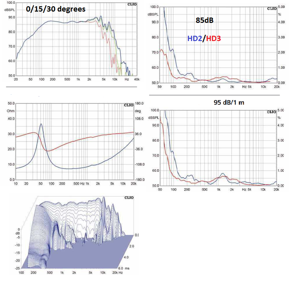

Here it is:

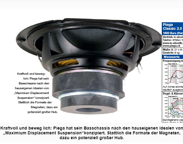

Niklas Baur (CEO of OmnesAudio and BPA) probably got hold of some woofers used by Swiss firm Piega in their Classic 3.0/5.0/7.0 speakers.
I have had LoCo6.1 in my hands and it is exactly the same. It measures great and distortion is low even at 95dB/1m. Paper cone. I think that there is no way to get something nearly as good as LoCo for 2 times the money.
Good luck.
Good luck.

Here it is:
Good luck.
