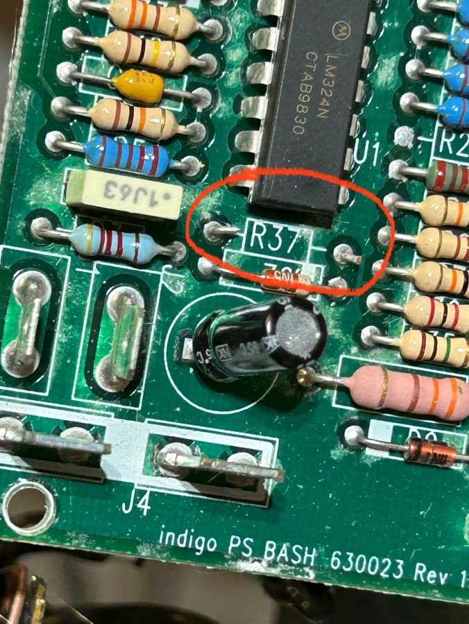

I took out 12" woofer and tested it by connecting it directly to my AVR and the amp in the other working speaker and it sounded fine. then I pulled the amp out and went over every board to see if there are some obvious burned out components. Here is what I was able to find:
1. Missing resistor on input board (indigo PS BASH 630023 Rev 11 amp), someone cut the resistor out?

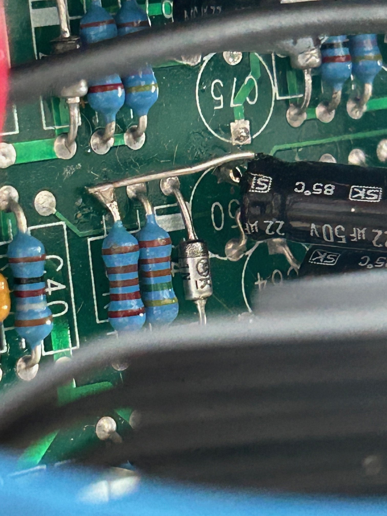

2. One of the caps on the output board was jumped to one of the resistors?
other than that everything else looks fine on the amp boards that I could see.
I was not able to find service manual for the speaker/amp :-(, so any advice how to look for problems would be helpful.
What do the wise diy audio gurus suggest how should I go about troubleshooting this?

I am going to recap PS and other boards. PS is outputting only 19V compared to the 29V I get from the healthy amp PS. Once you warm up the caps, the voltage jumps to 29 V. I suspect some of them are bad. It is 25-year-old speaker.
