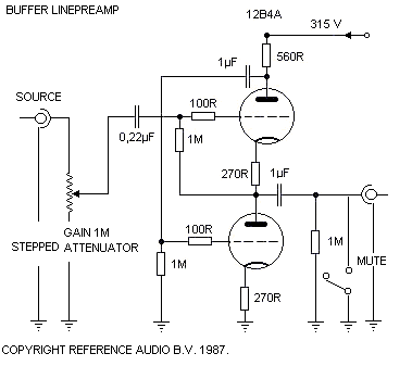

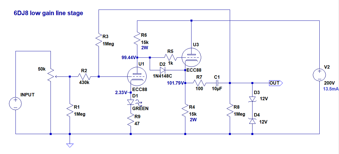

I was just playing around with an 'anode follower' (aka 'plate follower' in the US) using a 6DJ8 (same as ECC88). That uses local plate-grid negative feedback to reduce the gain and distortion. You can set the gain using a voltage divider (2 resistors).
Follow that with a cathode follower to drive your 2.2k ohm load, which practically requires a cathode follower, a MOSFET source follower, or an opamp.

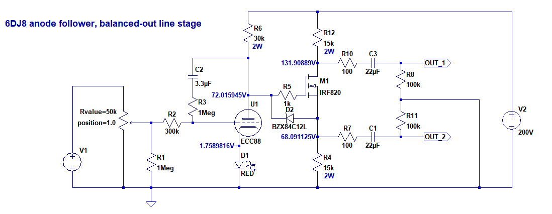

Something like the attached audio circuit should work very well for driving a Class D amp. The way I have it pictured yields 2x (6dB) voltage gain. You could adjust R2 and R3 to get to the gain you want. For instance, change R2 to something like 330k to get 3x (10dB) gain. The output impedance and distortion will stay low thanks to the cathode follower on the output.
The volume control in front is optional.
In something like this circuit where the cathode is 100V above ground, you'll want to lift the heater supply so that it's about 50V above ground, so that both cathodes are within the cathode-heater voltage limits.

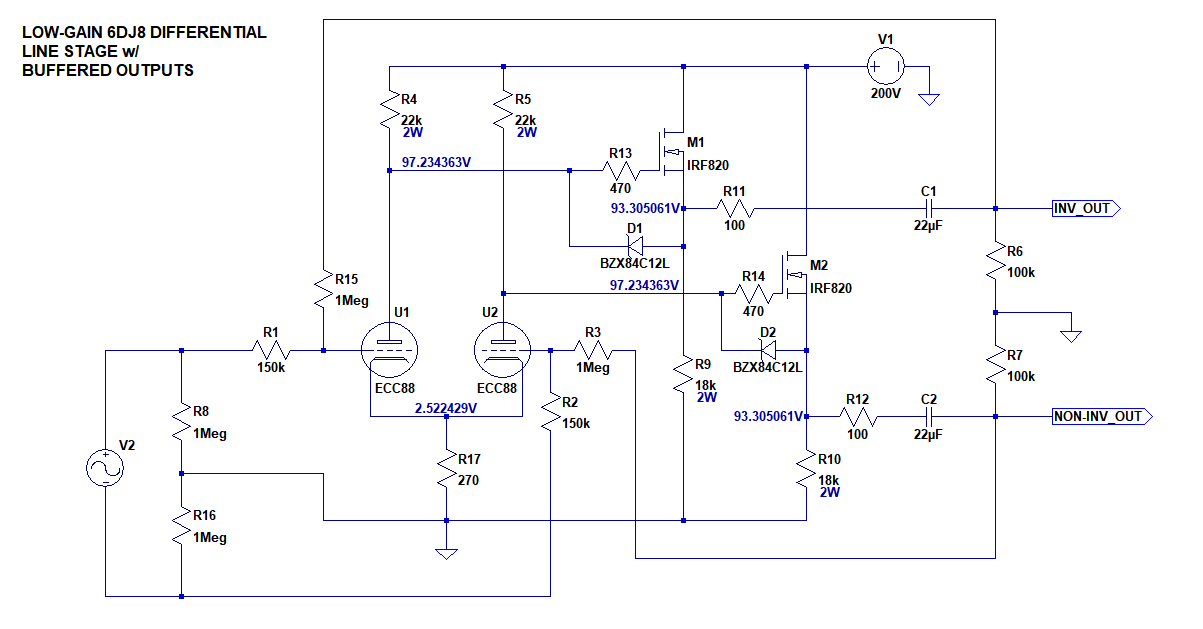

How about an anode follower with MOSFET 'source-o-dyne' output? Very low distortion this way...
Differential input too?
Then Eli's idea of a long-tailed pair with some kind of solid-state output buffers likely is the way to go.
The problem will still be how to get only 3x gain.
I wonder if plate-grid feedback can be applied to an LTP...

How about this?
Balanced input 6DJ8 LTP DC coupled to IRF820 MOSFET source followers, with negative feedback from MOSFET source outputs to tube grid inputs. Gain calculates out to about 2.5x. This looks like it should work really well, even into 2.2k ohm loads.
