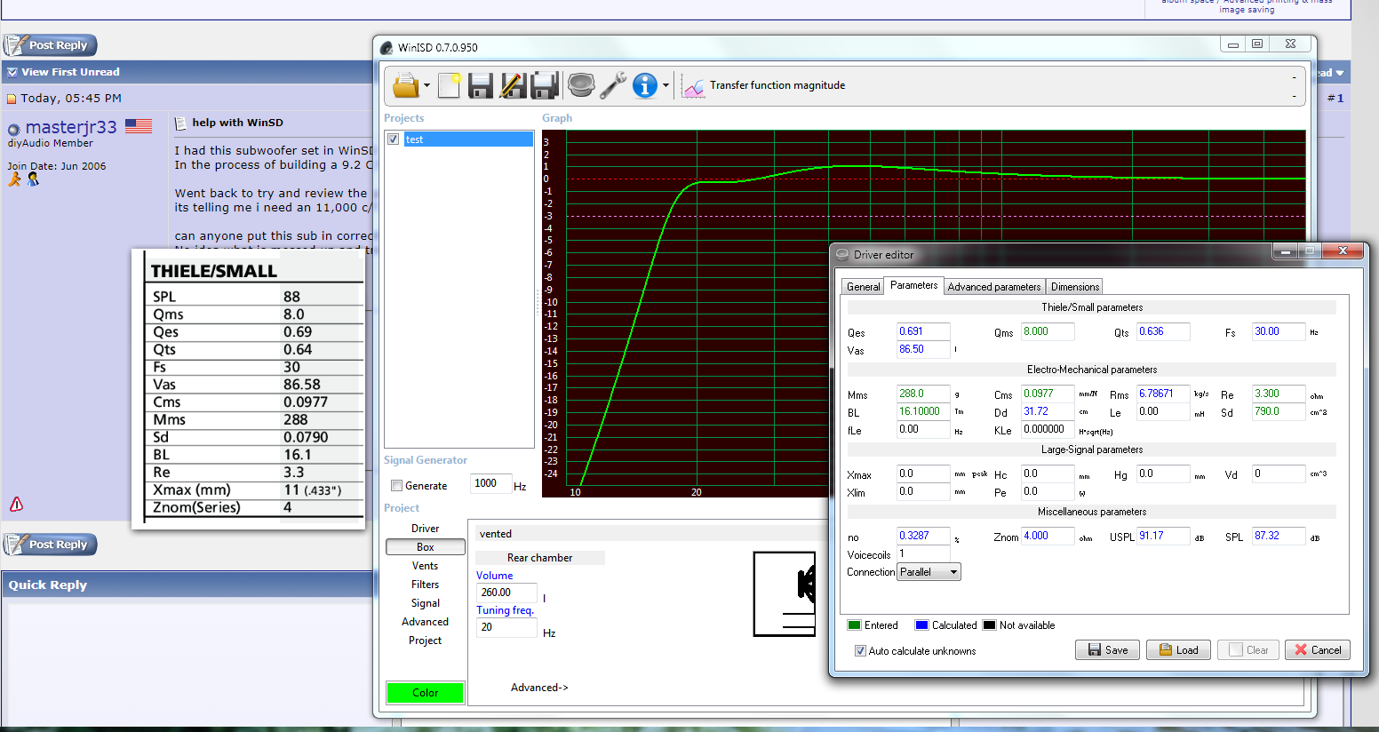

I had this subwoofer set in WinSD for a while.
In the process of building a 9.2 C/f box for it.
Went back to try and review the port sizes and options and I some how messed up the paraments in winSD.
its telling me i need an 11,000 c/f box now..
can anyone put this sub in correctly and maybe share the file or screen shot for me.
No idea what is messed up and tried to add it again. and it's still not getting me set right.

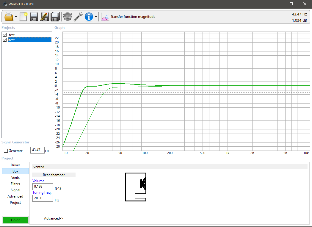

Most of those TSP's are in metric units and I see you seem to work in imperial, so it's probably a conversion issue.
Making sure all the units in WinISD are set to match your source info will usually sort this out (OK, that's just the nice way of saying "learn metric" I guess 😉 )
Screenshot should show how it should all go in I think.
Good luck,
David.
Edit PS: Also, try to follow the recommended sequence for entering driver data if you're not already doing that - WinISD will happily calculate derived parameters from the more fundamental electro-mechanical ones which may also help reduce the chance of a glitch.

9.2cu ft (260.5L) for a ported tuned to 20Hz should be good btw. i think you did like said above, entered it in imperial while the specs are set in metric. I got a reasonable flat response as far as you can get that from a driver with such a high qts. But the peak is only 1dB, so that is not bad up there.

Thank you so much . going to try these later.
I assumed it was a measurement issue to give me these numbers. I continued to tripple check that the digits were correct to no avail.
Never knew there was a recommended sequence. I just went down the list.
