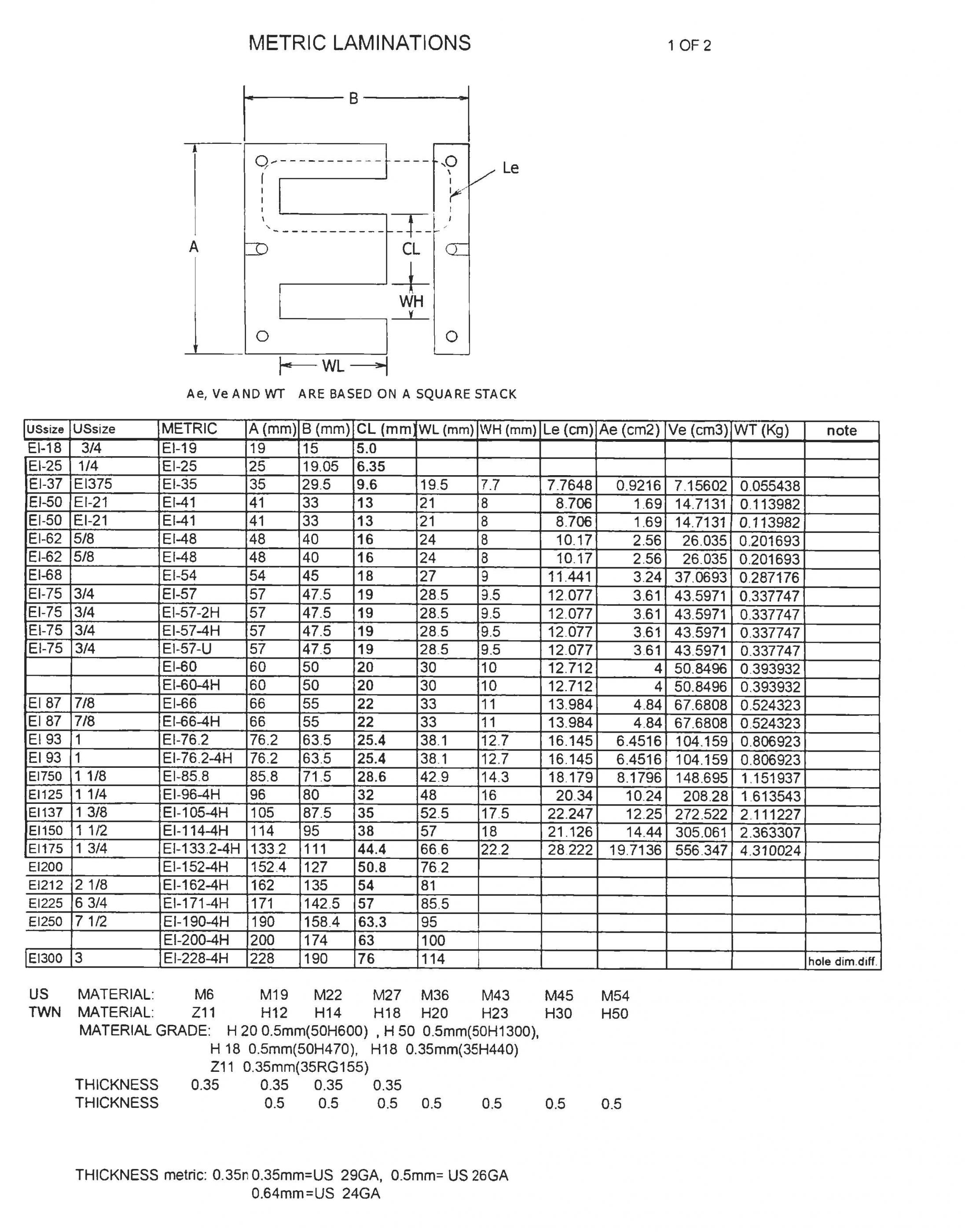

What is center leg and thickness? and what is the unit for what? (Inch or mm)??

What is center leg and thickness and what is the unit, they are used for what?
and what is the corresponding core size fore the calculated transformer above

is there no other formula?coz i have that kind of table here but only for 1000 watts trafo.i want to make 3000 watts of trafo.
The table on the left is using an EI core flux of approx 0.5T to 0.7T
This is a good value to use for an unknown material.

Transformer cores are measured in inches. You're right the pages are old but still useful.
there are also metric dimensions...
a 3000 watt traffo will have a 2.25 inch center leg stacked to 4.5 inches...

The old fashioned formula/guide for core size is given bya 3000 watt traffo will have a 2.25 inch center leg stacked to 4.5 inches...
finished traffo will weigh in at around 45 pounds estimated...
VA ~ 31 * (core area)² * max usable flux.
using AJT's number of 2¼ by 4½ gives core area = 10.125
max power = 31*10.125² = 31 * 102.52 = 3178VA if max flux = 1T
for 0.7T that core reduces to ~2225VA
for 1.1T that core increases to ~3500VA

- Here is the Computation of EI core Transformer Philippines Base
