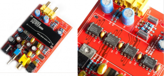

While on the subject does anybody know how this works? It looks like it has 28pins?
Its a reclock as well... I'd be interested in a schematic.
I may use it in another project but I might just use a usb asynchronous Amanero board on its own... I'm confident the necessary measures are employed in the amanero, to do what that 28pin thing otherwise does... (reclocking).
