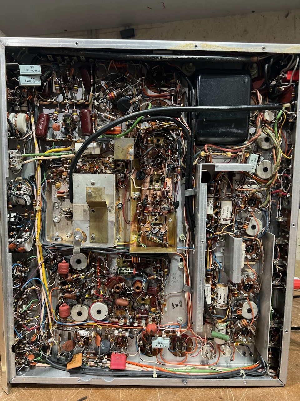

Hello. I'm fixing this amp.
the owner claims he bought it working.
as he was fooling around with it he dropped it, broke the 7591 and a cap.
the shock also took out the bridge and the 5 watt 20 ohm on the high voltage side.
now replaced and working as I think he got it.
horrible hum increases as volume is turned up.
also finding lots of AC riding on the DC of the 12ax7.
I really don't want to get to deep into this.
I need some voltage specs on the transformer.
looks like the hum is being introduced to the preamp. possibly all coming from the phono section. looking for some hints.

I have been. It's an interesting unit. built in 1963. the wiring is very nice its a piece of art. but a killer to work on. just testing voltages is stressful. right now I'm seeing way to much AC on the DC. About 20 volts at the 4 12ax7. they use resistors not inductors. i might have used a bad bridge ill find out later. still trying to trace and follow the schematic. very tight. I'm pretty sure this is a cap problem I'll keep looking. I'll end up posting all the videos on YouTube. I am going to separate the power amp from everything else and give it a know clean one tomorrow. just to know what I'm up against. I'm pretty sure the power amp section is fine.

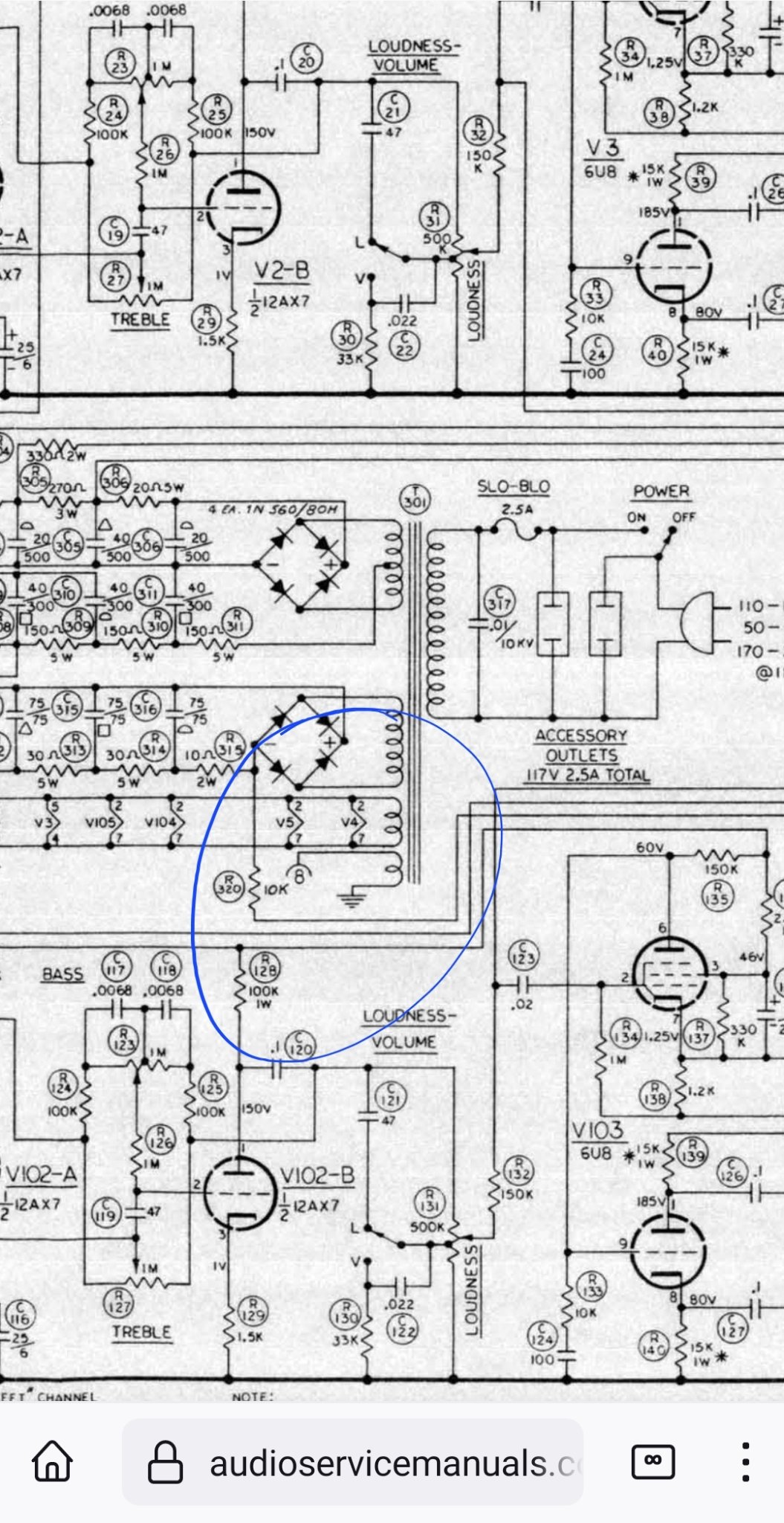

Whenever you have no specs on the power transformer you can use a variac to dial in the main voltage with all tubes inserted and measure the AC voltage on filament winding until it hits 6.3VAC. Once stabilized then measure the high voltage windings and bias windings and other extra windings. Write down all the voltage points, AC and DC. Normally you get in the range between 105-115VAC on the primary because most vintage gears were expected to be powered below 120VAC. Of course this should be done AFTER you slowly reformed all the filter caps with the variac.
All true under normal conditions. the 4 12ax7 are in series and tap 9 not used. the bridge was low. the bridge was bad.
replaced the bridge. ac voltage about 58 not sure its all wired in now. dc voltage was low about 50 volts . not knowing if the 58 was correct is why I needed specs.
so voltage on the 12ax7 was low and high ripple.
all of the can caps were bad. open.
should be 75/75 each.
made a new filter for the DC.
DC now at proper voltage and the voltage on the 12ax7 is about 12.23 each. all previous hum from the preamp is gone.
A very slight hum on the output still exists but it's very slight and doesn't increase with volumes.

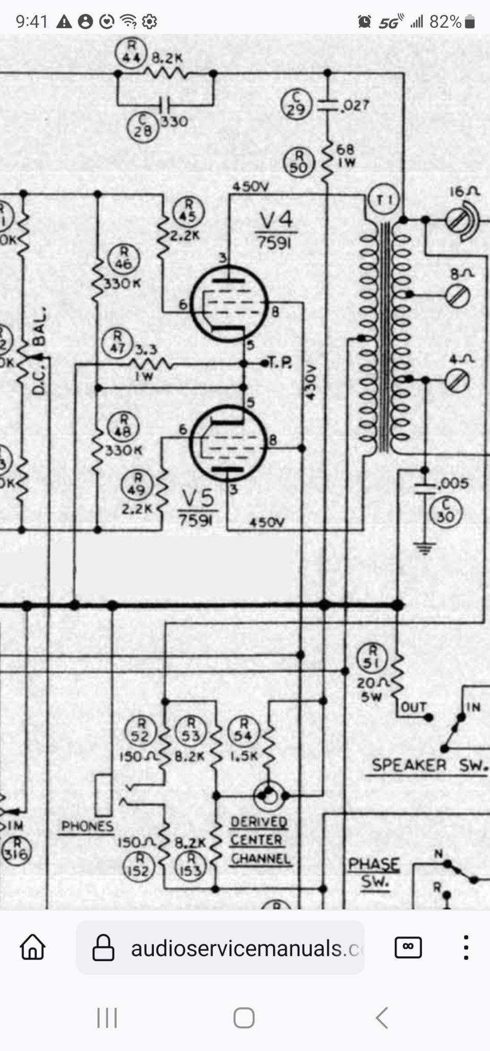

I would use a 10 ohm resistor for each 7591 cathode to ground for easy bias and balance check on the test points, instead of a single 3.3 ohm resistor (R47 & R147) for both tubes in each channel. The four resistors can also act as fuses in case of catastrophe to protect the output transformers.
So take the 3.3s out? and put the 10s in? what should I see on the test points. ? I haven't looked this up so I'm not familiar yet.
thank you for the pointer.
Dave
Dave
Each resistor indicates how much current the power tube plate (plus screen) is drawing. 7591 total plate dissipation is 19 watts (total screen dissipation is 3.3 watts but let's just use plate only just to be conservative) since plate is 450V so 19/450 = 42mA. So you do not want to bias each tube exceeding 42ma or 10Ω x .042 = .42V on cathode. 10 ohm is just easier math without calculator. In stock circuit with 3.3 ohm for BOTH tubes, 3.3 x .084 so you don't want to exceed 0.2772V at the test point. Having separate resistors for each tube is just easier to balance bias.

3.3 ohms for two tubes' cathodes tied together would be 6.6 ohms for each tube. You can of course use 6.6 but why when 10R is readily available and easier math. Unless the test point voltage is labeled on the chassis at a specific value based on 3.3 calculation but you can always relabel the value with 10 ohms. Dynaco ST70 chassis is label with a specific voltage for bias, for example. Also, make sure the resistors are precise and highly matched so you won't get misreading of the bias.
3.3 ohms for the 2 tubes tied together r47 replace with the 10 is fine, im missing something when you mentioned the 6.6 ohms. the 10 makes more sence to me any way you want to look at it.

this is the section you are talking about , correct. 1, 3.3 ohm,
