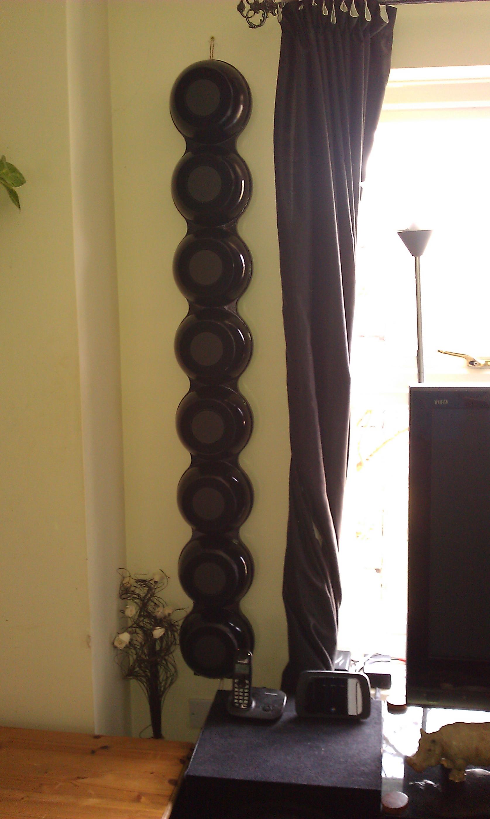

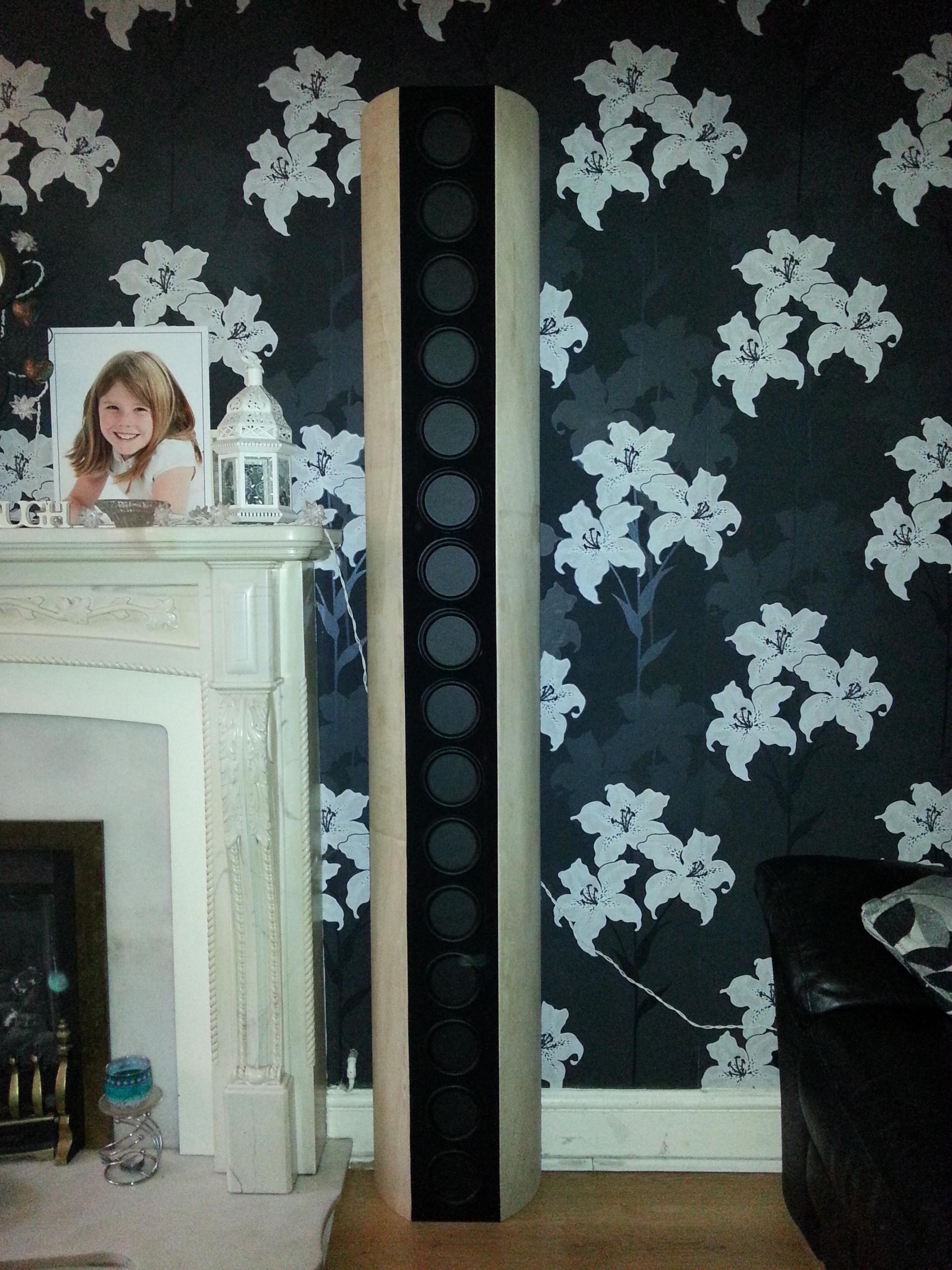

Hiya,
A single full range driver will always fail to satisfy the main criteria for true high fidelity or life like reproduction of music ( dont even think about home cinema...!)
In order to have a good mid and top end you need small and light cones.
In order to get a good low end you need bigger stronger / heavier cones....Or lots of small and light.
Its not rocket science, " If you want true full range sound with dynamics and low distortion you need lots of Sd.
" There is no replacement for displacement " Well actually thats not quite accurate or even appropriate but you get my point.
One key benefit of a large Sd is that each cone is only moving a tiny amount so minimising displacement is a great advantage of having a large surface area, or lots of small surfave area's.
The attached are very efficient, very dynamic, sound astonishing and work with 5 watt SET's or 1,000 watt class D's and everything in between.
Cheers
Derek.

Size matters...A lot!
In order for a speaker to function as a true Line Array, the length of the driver array ( not just the cabinet length) must be at least 75% of the floor to celing height of the listening room.
There are a lot of fake or "mini arrays" (like the one pictured in Normans post) which give true line arrays a bad reputation. These fake arrays are a waste of money and not worth building as the floor and celing bounces mess up the imaging and there are not enough drivers / Sd to generate low distortion high SPL's.
Garbage in = garbage out...Forget using a bucket load of cheap 2 inch or 3 inch midrange drivers and hoping / praying that they will turn into a seamless line of full range high end drivers if you use enough of them...
50 times a crap driver will always sound 50 times worse!
All drivers will require Eq to give the best results, some are so good you may not need it, but they would still benefit from it.
Some drivers are so bad / not suited to a full range line array that no amount of DSP & Eq will help.
Choose a good driver with good specs and build quailty, this is vital as cheap " bucket" drivers have very poor tolerances, often plus / minus 15% or even 20% spec tolerances.
This is a sonic train wreck for any line array design. You really need plus or minus 5% tolerances to build a good line array.
As a rough guide to number of drivers / Sd required I have found that anything below about 550 Sd ( a typical 12 inch driver area) requires a sub crossed in around 80Hz to give medium to high SPL's with low distortion full range music.
550 Sd to 750 Sd is depending on taste.
Above 750Sd you can Rock...No sub required!
I use 16 BMR's ( 4.5 inch ) per speaker, 60 Sd per driver so 960 Sd per side, this is equal to a 15 inch driver and I can assure you they play loud, clear and with very low distortion!
Hope this helps and all the best
Derek.
