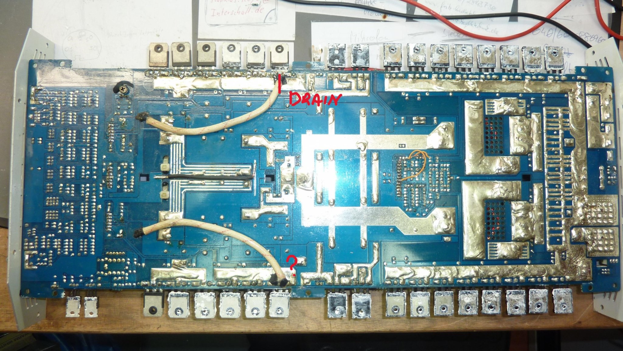

Currenly working on my Hifonics BXI6000d.
Maybe someone can helpme with this.
Someone was working on this pcb, and i think he soldered the wires from the feedback resistor on the wrong spot.
Looked at many pics of the two wires. But can't see clearly where its connected to..
Is it connected on both rails on the Drain (center pin)

It's supposed to be connected between the drain of the 'low'-side output FETs to the 1 ohm resistor.
Thanks Perry,
So if i understand well, both wires coming from de 1 ohm resistor should be on both banks connected to the centerpin of the FQA38N30 (Drain) correct!
The wire connects the rail-rail waveform of each bank to the resistor. The connection is to the high-side source terminal which is also the low-side drain.

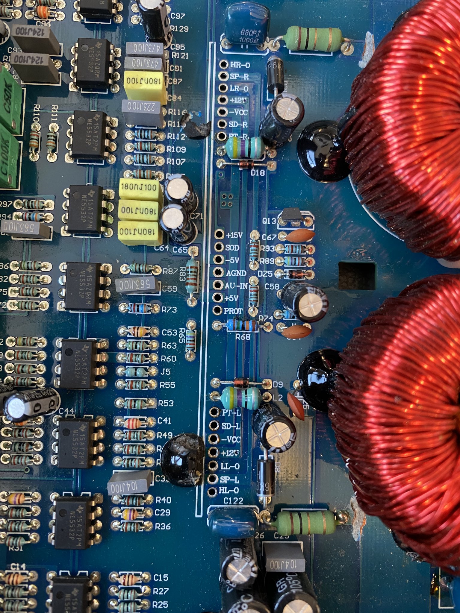

Looking at photos online, it appears that they cut a trace on the top of the board and re-routed the signal from another point. I have no photos (of my own) of the top of this amp so I don't know if this trace cut is common to other revisions.

But still don't know where to connect the other wire to.. One pic again. Of one side i know where it should be, cause is wasn't soldered yet. Is there a schematic around that show how the feedback is connected..
Both serve the same purpose (but for different 21844s). They both connect to the low-side drain terminal.
Thanks Perry, now i know what theybhave done wrong. One side they soldered it to the Gate. Checked allready the powersupply. Starts up fine. But have to change the 21844's right channel makes a short. And don't trust the left. Thanks for the info Perry..
