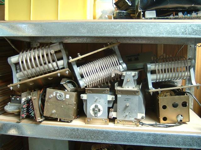

I play with RF stuff; here are a few of my silver plated copper tube coils. The one in the middle is 15.5uH.
Without some hefty shielding, in a 50A SMPS application you'd be running into trouble with any sensitive control electronics nearby (just think of a 150uH 1/4" tube coil......)
