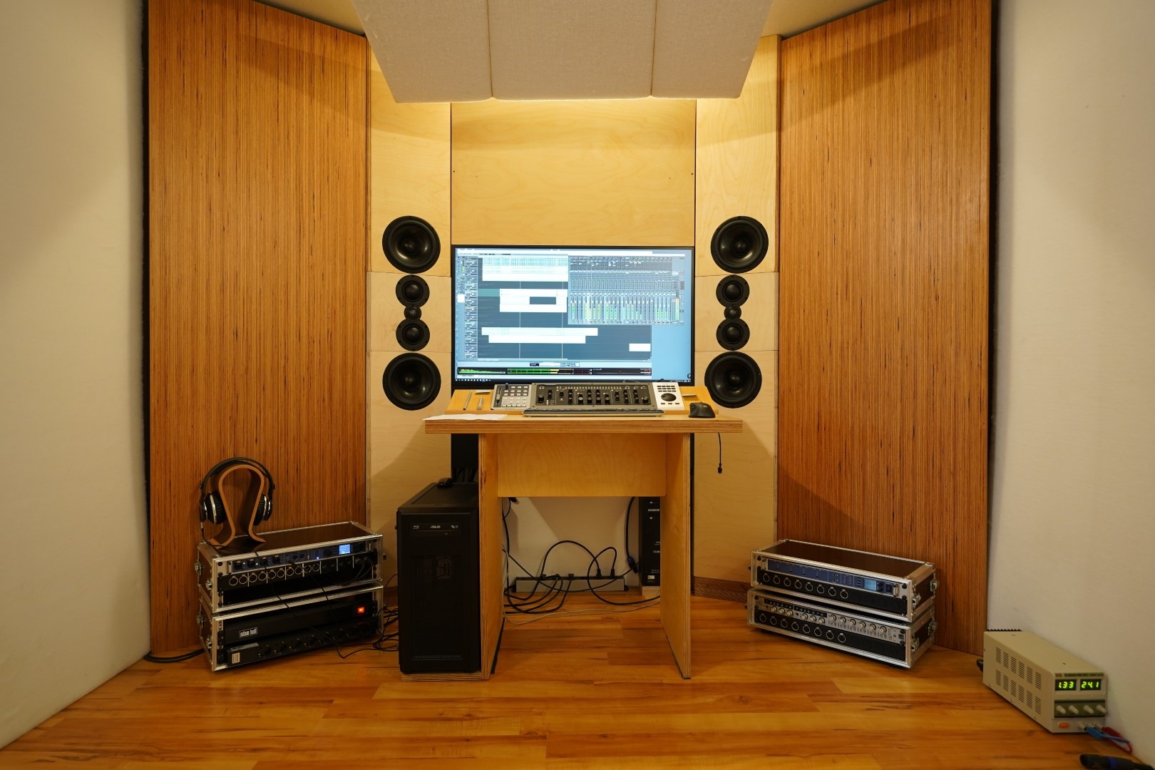

There are a lot of corners in this design you could avoid! Put the speakers directly to the TV, make them as high as the TV.
You could extend them to the edges of the backwall or make some smoother transition.
From an acoustic point of view you sould create a seamless wall with the speakers included.

The monitor + speakers + frontwall build a seamless surface. You design has a lot of edges and resonances there and it would be easy to at least connect the speaker with the TV. Also the "board" of woofers isn't great cause it's one reflection more ... maybe you get some ideas to "streamline" it a bit more.

http://cowanaudio.com/finale.htmlAlso the "board" of woofers isn't great cause it's one reflection more ... maybe you get some ideas to "streamline" it a bit more.

Yes I agree on most points. The door on the right side can't be moved and on the left side there are windows with designer curtains so that remains a limitation. The sketchup images show the original plan with coaxial drivers and my wife already told me that the drivers need to be flush mounted so that's what I'm going to do anyway. The sharp edges on the concave wall can be round too to minimise diffraction.
The subwoofers on the back left will be sealed instead of ported. I was thinking of building a dual opposed slot (up and down) for each subwoofer pair but I want them to remain easily accessible for serviceability when needed.
The enclosure for the lower speaker will remain in place as support for the 85" TV but won't be full width and it'll only contain the center speakers.
The L+R speakers will have the same flush mount vertical WMTMW layout as yours but the tweeter will be at ear level for mixed home theatre and stereo listening. One single Bliesma M142A-6 would simplify the driver layout though. Especially the lower PTT6.5M08 in the center speaker will sit awfully close to the floor if I respect the MTM placement.
