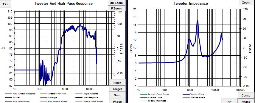

An issue with tube amplifiers is that due to the DCR of the windings of the output transformers, the output impedance is higher than one would see with a typical solid state amplifier, which is assumed to be near-zero ohms. At it stands, the majority of loudspeaker crossovers are designed with the assumption they are being driven with a solid-state amplifier. An advantage of DIY is that one can work around this and design the passive crossover of a loudspeaker to accommodate a specific, known output impedance. Additionally, one can also design a crossover that flattens the impedance curve of a loudspeaker driver. The result is a more constant impedance being reflected back on the output transformer’s primary, which is the load your output tube is working into.
A varying impedance in a loudspeaker isn’t typically a problem for a solid state amplifier but for a tube amplifier, that impedance manifests itself as a varying load on the output tube, which in turn causes measurable frequency response aberrations in the amplifier itself. Some of these aberrations contribute to that “tube sound” coloration which some people may find pleasant on some types of recordings. If your philosophy allows for non-neutral sound reproduction, this may be something you might enjoy.
I mention this because your current tweeters have an impedance as shown by the blue line in the graph below:
It’s actually fairly flat and probably isn’t wreaking havoc on your SETs frequency response. A typical compression driver, on the other hand, has an impedance that looks something like the graph on the right:
These impedance variations can be tempered somewhat in the crossover design, whether or not to do it (and to what degree) is something still debated on forums. Most people are running solid state amplification so it stands to reason that most loudspeaker designers wouldn’t waste their time flattening the impedance of a high frequency driver.
I bring all this up to drive home the point that tube amps and loudspeakers interact with each other as a system in much the same way a pair of loudspeakers interact with the room they’re placed in.
