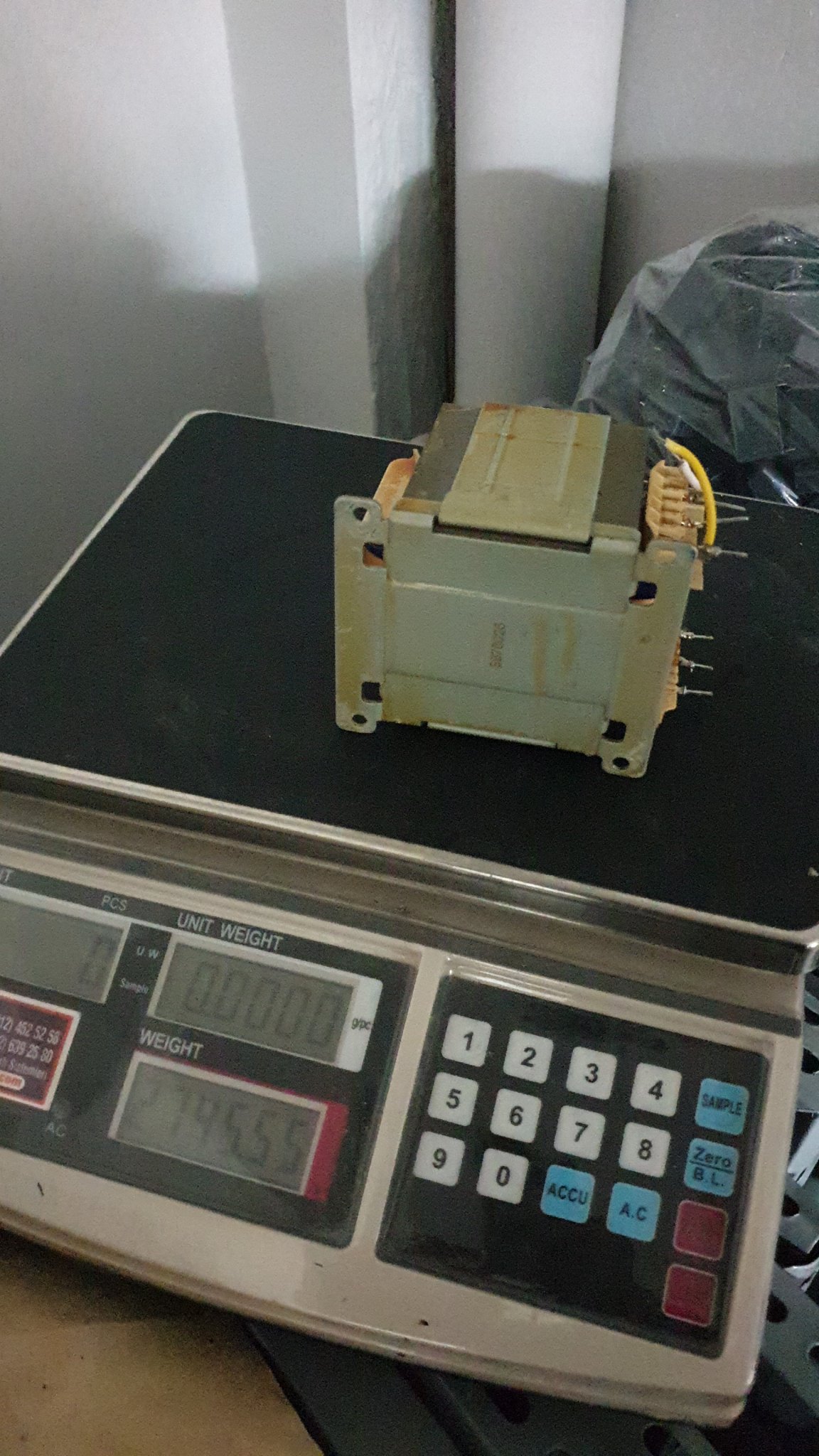

Hi.I modded my Denon PMA495R amplifier a lot but i still did not like the sound.I is dry sounding amp.Finally i broke it into pieces and now i have a very good quality transformer now.It have zero noise. I like it. It has 2x31v Ac. It makes about +-41v after rectified.I think transformer is about 200watts but not sure. I could not find a good schematic on internet for40v simetric class ab amp for 4 ohms. I want to make a very good sounding Class ab amplifier.I will connect it to my 4 ohm full range speakers. Please advise.
That's the way I would go, but it will make another dry amplifier without any distictive character. It will sound identical to what was removed. I'm not sure this is what the op is after.
The "dryness", and not yet mentioned "scratchiness", is result mainly of the construction: bad solder joints, unnecessary contacts, unnecessary bridges and more, but also unnecessarily complex circuit.
From the original, I would use the power follower (I think it will be one) and from all the many "unnecessary pre-stages" only one or two. These Denons should have some (many unnecessary) single ended preamps. And then connect the input directly, without switches and relays and such, to this se preamp.
Hi. I do not know why it is dry sounding. I liked lm3875 sound more. Even Tda2050 sounds better than Denon amp as i remember. I will buy this one then.It seems it is blameless amp.

No doubt: lm3875 and TDA2050 sound much better than complex discrete pp-designs - krell, accuphase, madrigal, cello... too!
Comparing with what?Hi.I modded my Denon PMA495R amplifier a lot but i still did not like the sound.I is dry sounding amp........
On what speakers and with what signal sources?
With my old Wharfedale 6 ohm kevlar speakers and the other speakers which i diy with Nokia woofers and tweeters. LM3875 sounded better than Denon amplifier.Only bass was weak but treble and mid was better as i remember.
I have Quad405-2 ebay assembled kit but i heard that it does not have very good low frequency behaivour and not high end.Maybe consider a Naim clone...?
