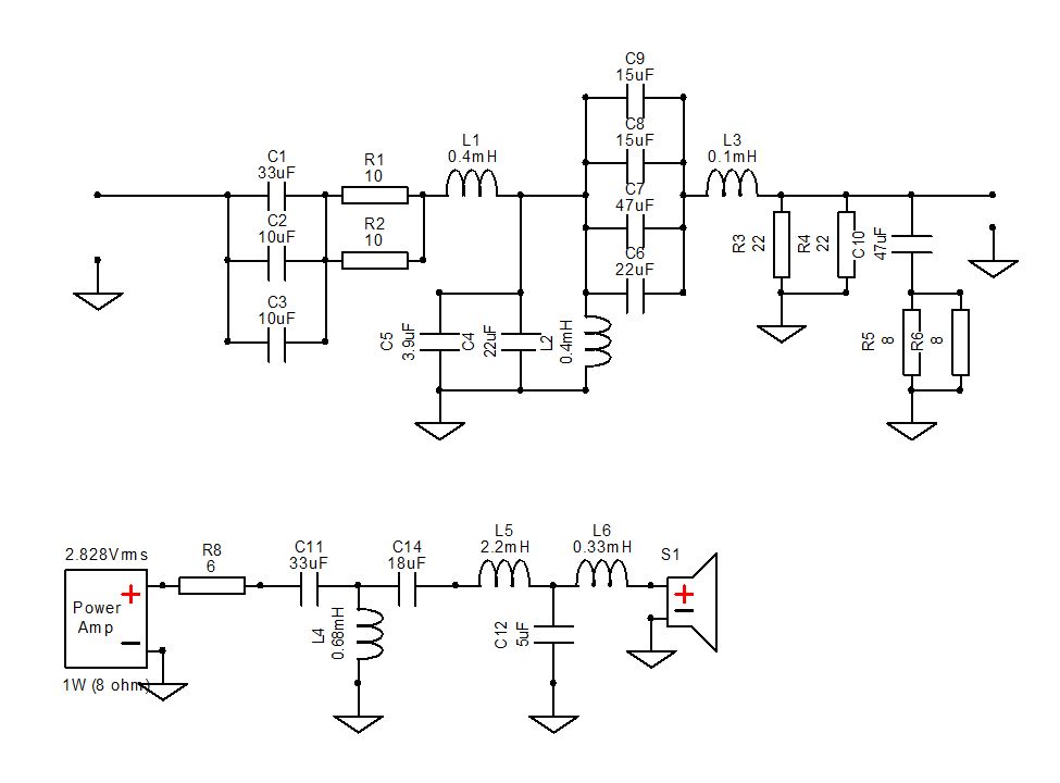

That is a nice set of drivers, but wow, those crossovers are complicated. Was there an attempt to completely flatten the impedance curve or something?

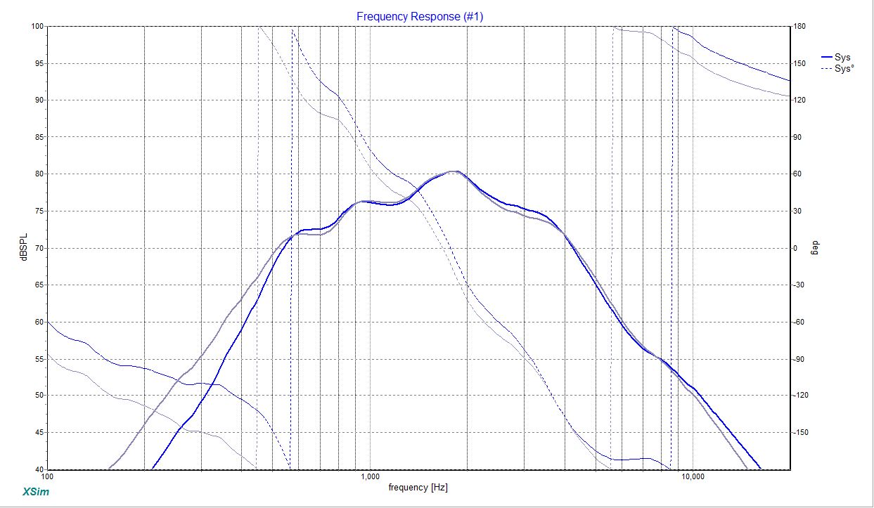

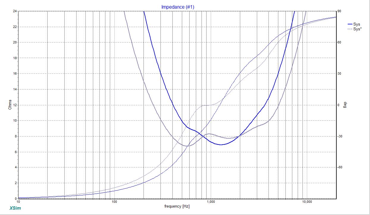

I have played around with accuton midrange original filter and come up with a comparable response using fewer parts. The blue line represents a modification.

Evil Twin said:~with the Duelund transfer function, the exact slope must be managed down to - 20dB or better for good results, and this requires much more "management" of the transfer function over a wide range, than a conventional midrange band pass - if one had a driver with ideal response from 100Hz to 10kHz or higher, than a simple LR2 band pass would roughly suffice, but with real world drivers, this isn't possible.
OH, he's attempting THAT crossover design.... hahahaha, now the part counts make sense, if not necessarily the contortions. 🙂
