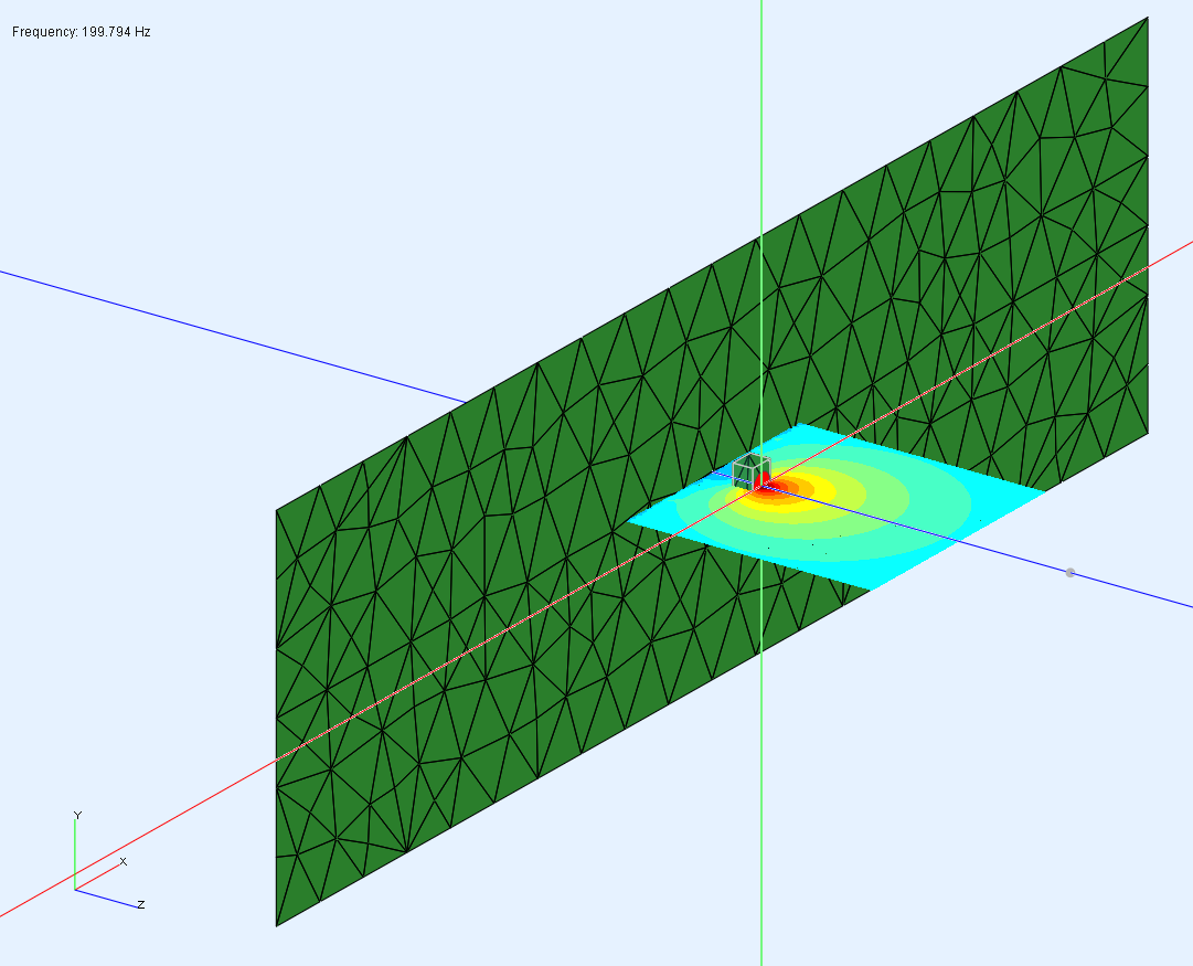

Handling the front wall well in the simulations may require a modified approach with BEM being one way to handle the 3D details. I have some experience with the open source acousto software though not all good. Others appear to have experience with AKABAK/ABEC. Is the latter suitable? Other options?
ABEC and AKABAK are suitable to see the effects and model any design whether it is theoretical with the use of pressure boxes or actual when the whole design is meshed with specific driving parameters.

Reflections, directivity and boundary interference are all within ABEC/AKABAK's BEM capability, COMSOL doesn't really offer more until it's multi physics or FEM are needed and without a commercial application or access to it in another way the price is pretty wild.
Thanks. Good to see these simulations and links to prior work.
COMSOL does have advantages over ABEC/AKABAK like better accuracy, faster for large simulations such as speakers in rooms, ease of use and support, hooking in to other software, runs on platforms I could use for crunching numbers (dual Xeon) not just Windows (laptop with Athlon),... but it also has disadvantages like availability which isn't one of ABEC/AKABAK strengths either.

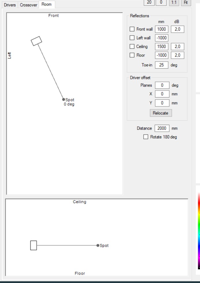

Vituix can demonstrate some of this too in a limited way.
I am unfamiliar with this software due to the Windows requirement but it is currently widely used and seems to be liked. Can someone summarise it's capabilities with respect to on-wall speakers?
^ Advantage of VituixCAD to me is that it is real time! I mean you can change the simple room model by mouse wheel and see the interference move around at the listening spot. You can inspect floor, ceiling, side and front wall reflections in relation to the speaker and listening spot but it does include the one corner of the room only so there is no means to see if late reflections from the back affect. This is a good thing I believe, we need data about the front wall proximity.
The simulated speaker works with real or generated measurements. It is just fast and easy to whip up and tune around to see what affects what. But, it is not very accurate to reality other than being simple math based on heights, widths, angles toe-ins, path lengths and what not to display sum of direct and first reflections at single observation point as single estimated in room response line. But for example it is pretty straight forward to test out if there is optimal height for a bandwidth in relation to floor and ceiling and listening spot (height) or not! Or what is effect of floor (and/or ceiling) bounce and does woofer height affect on that or what crossover point would be nice between woofer and mid try and smoothen the interference.
Lots of generalized information can be gained, like if something seems to be possible or impossible or what seems to be the phenomenon and what affects what in a very quick way. But, one has to be able to ask questions and figure out how to test them in simple form and if the test gives any valid information or is it something else. It is very interesting to see things move even if there wasn't enough understanding to interpret what that might be. First thing that will pop into mind is how it is all about wavelengths 😀

You asked if it could be done with ABEC/AKABAK and I showed that it could. Anybody can get a fully functioning student licence for either program for free on the condition that it is used for non commercial purposes only. What you choose is up to you as my interest in this project is purely academic.
Advantage of VituixCAD to me is that it is real time! I mean you can change the simple room model by mouse wheel and see the interference move around. You can inspect floor, ceiling, side and front wall reflections in relation to the speaker and listening spot but it does include the one corner of the room only so there is no means to see if late reflections from the back affect. This is a good thing I believe, we need data of the front wall proximity.
The real time aspect of Vituix is great, the room simulator is my least favourite part of it, basic questions on room placement can be answered but not much more. A BEM room sim is better but the more generic it is the less valid it will be for any given setup. I agree with what you said before, and I said the same thing above, that the front wall is actually the least problematic to deal with in a good on wall design, bad ones make everything a problem 🙂

This kind of stuff is easy to see and think upon in the VCAD 😉 And as soon as you enable both walls, floor and ceiling you'll notice the interference doesn't line up very well no matter the speaker / listening position... Well, at the low mids (where the room modes are not dominating anymore) it looks like careful positioning can average out the interference at listening spot (ignoring rest of the room, furniture and stuff). Roughly about 3kHz it looks like the comb filtering is smoothed in the brain. Between about 500Hz and 3kHz is a region that seems to be a mountain range no matter what. It is here you want the interference to minimum to make the mountains and canyons turn into to hills and ditches. This is true for any speaker though, not just on wall speaker. I made up the 3kHz, took some rough number. Might be 6kHz, or something.
Well, if you tune the VCAD room model so that your speaker is at the ceiling or floor corner there is not much interference. Just cram a fullranger there and call it a day 😉 Or figure out what the hearing system is capable of hearing. Maybe there is frequency range we could exploit, where all problems can be piled on and just rely brain cleaning it all up. ? I haven't looked too much into hearing system other than the basics that popup in the forums every now and then.
