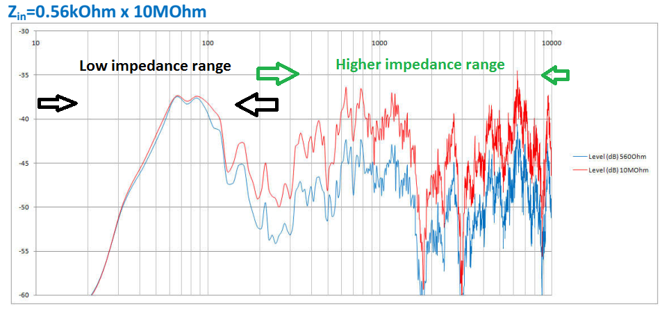

In my experience with buiding a low noise pre-amp for a ribbon mic, as we decrease input impedance, high frequencies indeed are killed first.
But, above 10kOhm input impedance, it makes not much difference. Below 4.7kOhms we clearly can see the difference showing up.

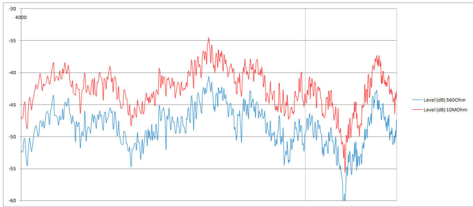

See attached some measurements I've done some years ago comparing different input impedance values versus the baseline of 10Mohm input impedance.
10k, 4,7k, 2.2k, 1k and 560Ohms. Charts zooming 10 to 10kHz, 100 to 10kHz, 1k to 10kHz and 4kHz to 10kHz so as to better observe the frequency response in each range.
These measurements must be observed from the relative perspective: same mic, same pre-amp circuit and same loudspeaker. The only variable changed was the insertion of a resistor at the input so as to vary the input impedance.
I ended up building this pre-amp with 2 pairs of JFET LSK389 (parallel to reduce noise) with 100kOhm input impedance to gnd.

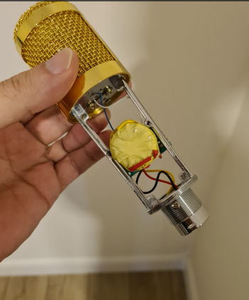

I didn't realize ribbon microphones normally have built-in step-up transformers. If the ribbon were driving the microphone preamplifier directly, the source impedance would be very low indeed and anything would do for the microphone preamplifier input impedance.
What does the impedance graph of a typical ribbon microphone (with built-in transformer) look like? It determines what kind of input stage would lead to least noise.
Hi! Yes, the ribbon in general has a stepup transformer.
See the one I used as a reference and see if my conclusions make sense.
The secondary winding DC resistance is around 4ohms - I measured at the mic final output leads.
I don't have the impedance curve - I'd have to think about how to measure it without damaging the mic.
But from load curves I took, this is what I observerd:
With 10kohms load, there is no change in the signal from 20 to 10kHz compared with 10Mohm load.
With 560ohms load, I see around 5 to 6dB drop starting around 200Hz-300Hz and up and it stays flat up to 10kHz.
It would indicate that impedance starts at very low levels (10ths of ohms), raises to around 500Ohms and stays there up to the high frequencies.
Zooming the high frequency range - we clearly see 5 to 6dB difference flat.
6dB in voltage is half voltage so the output impedance would be around the same of the input load applied (560Ohms)
