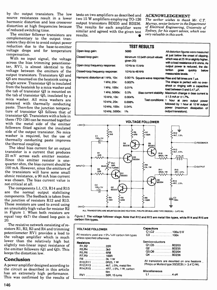

The day before yesterday I stumbled across an article by L. Stellema (University of Sydney, Department of Aeronautical Engineering & Electrical Engineering).
Published in September 1980, it's a pretty well-designed hi-fi amplifier with impressive specifications.
in advance
the final stage of the small, clever amplifier - All transistors are mounted on a common heat sink!

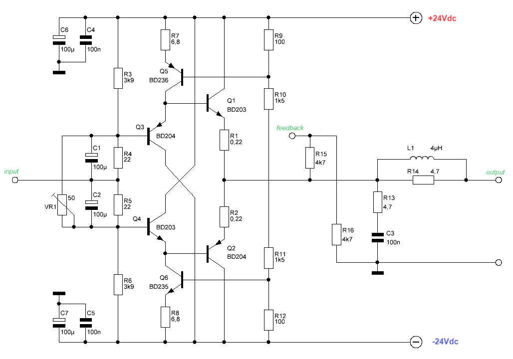

It's just a basic diamond buffer,
Q5 Q6 are current sources.
https://en.wikipedia.org/wiki/Diamond_buffer

The author simply calls the output stage a “voltage follower”, and we all know that it is a collector circuit - even in push-pull mode.
There was no fancy name for this configuration at the end of the 1970s. It is also generally better not to memorize names (alone), but to be able to read and understand the function.
I like the whole circuit and repeat my assertion to be on the safe side: a well thought-out, clever circuit.

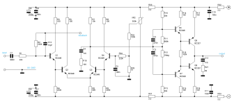

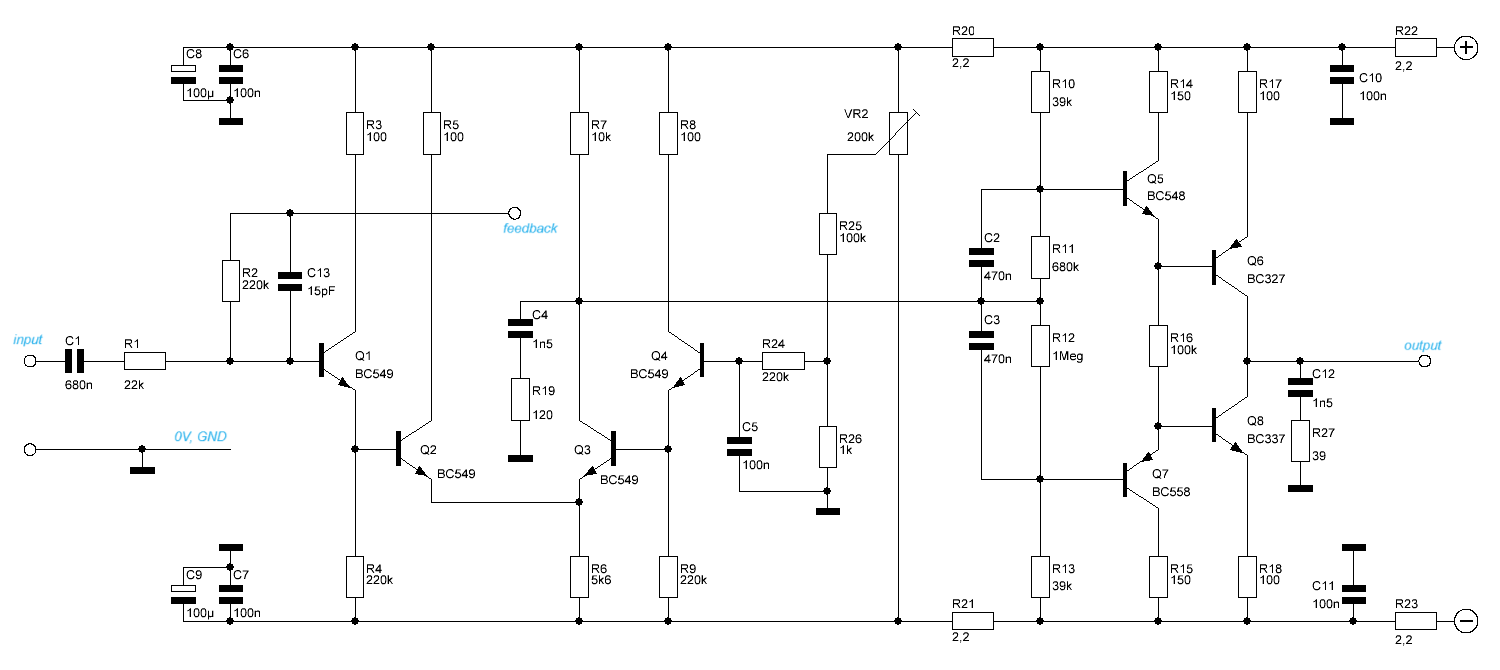

Let's simply scale everything to (more than sufficient) 20W and ask ourselves whether a commercial concept that is frequently used today is technically better than the present design study.
Better?
I have the /this amplifier on the shelf - it sounds fabulous and yet I don't like it, the entire construction is a disaster - not only that the power transformer hums and sets everything into mechanical vibrations ..., but that would be a topic for the “grief box”.

The advantage of the circuit in #1 is that both half-waves see the same two complementary transistors, so their audible different characters can be heard in both half-waves: The half-waves sound audibly less different.
Q5 and Q6 are not "identical". The largest audible difference between the half-waves is created here.
Joined 2009
The disadvantage of the diamond buffer as a power amplifier output stage is that the driver pair needs lots of quiescent current in order to provide enough base current to the output pair on signal peaks. You end up running drivers at the current and dissipation similar to that of the output pair.
In contrast, with the more common double or triple emitter follower, the drivers can provide more current on demand than the quiescent current, even if you keep them in Class A.
The diamond output stage works well where the peak output current is relatively small, e.g. in headamps.

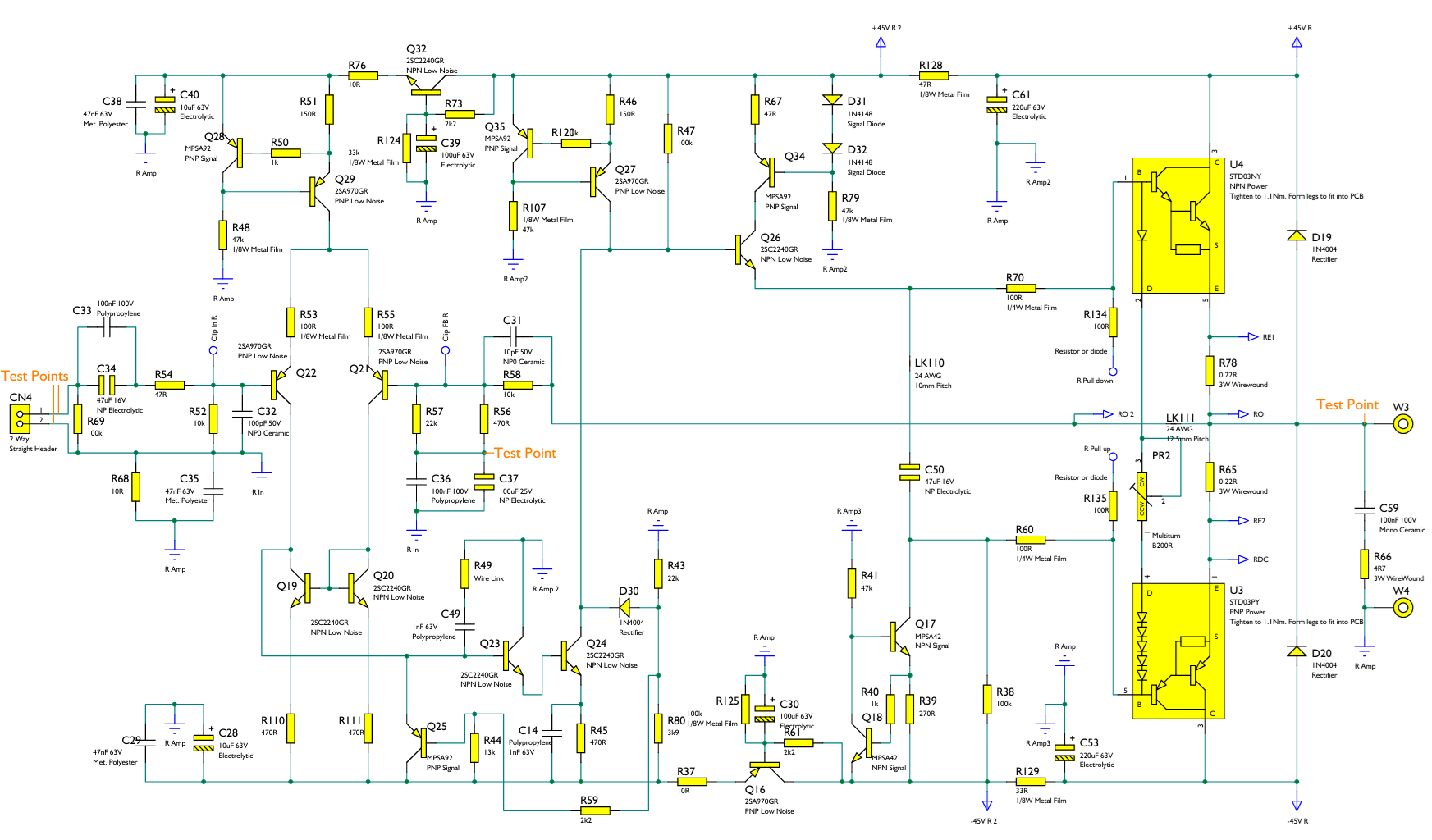

There should be a resistance that goes from Q23 emitter to the negative rail, otherwise the recovery is not good.
Also a serial resistance from its collector to ground would be a good thing.
Otherwise the value of R58 is too low and the parraleled lead lag cap is not strictly necessary, you ll have to check what part of the circuit has a frequency response such that it s required to render the whole thing stable, guess that it s a byproduct of the shunt compensation, see if a TMC compensation isnt better, it should be more efficient to yield a good THD number without resorting to such daredevils tricks.
By the way: bipolar transistors in particular have a fine veil in their sound. They generally sound "technical" - compared to many Fets, for example. A summation, regardless postition and function, of these is always audible and ends in a grey, colorless sound without joy and elegance. The supposed advantage of more current, for example, is bought at the price of a powerless, colorless, slowed-down sound.

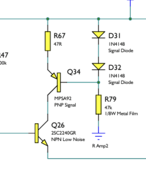

That s a current limitation for the predriver since there s a separate voltage rail for the driver stage, if there s no limitation
then the predriver Q26 will sink all it can in the darlington base if there s a clipping, with the consequences one can imagine
given that the predriver transistor is a small signal one with limited current capability.

This kind of buffer was used in the 70s by Bang and Olufsen in their Beocenter 2800 and in the hefty 7000,
eventually it s from these designs that Hbtaudio got the idea.
Like here they also used a shunt compensation centered in the IPS to wich was added an inclusive compensation
enclosing the OS and Vas, and last but not least a lead lag compensation from output to inverting input, but this didnt
prevent te amp to have a little frequency peak in the 500kHz region that they surely tamed with an output RL filter.
