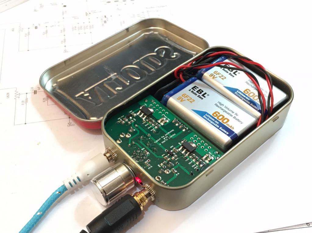

How would one mod the classic CMoy portable diy head amp project to output, say, 1-w. Say, for high-Z 'phones or otherwise non-sensitive cans?
It seems a seller on eBay has done this.
audeep CMoy model I - 1 Watt portable headphone amplifier US POWER SUPPLY BUNDLE | eBay
But how? Especially in a portable chassis?

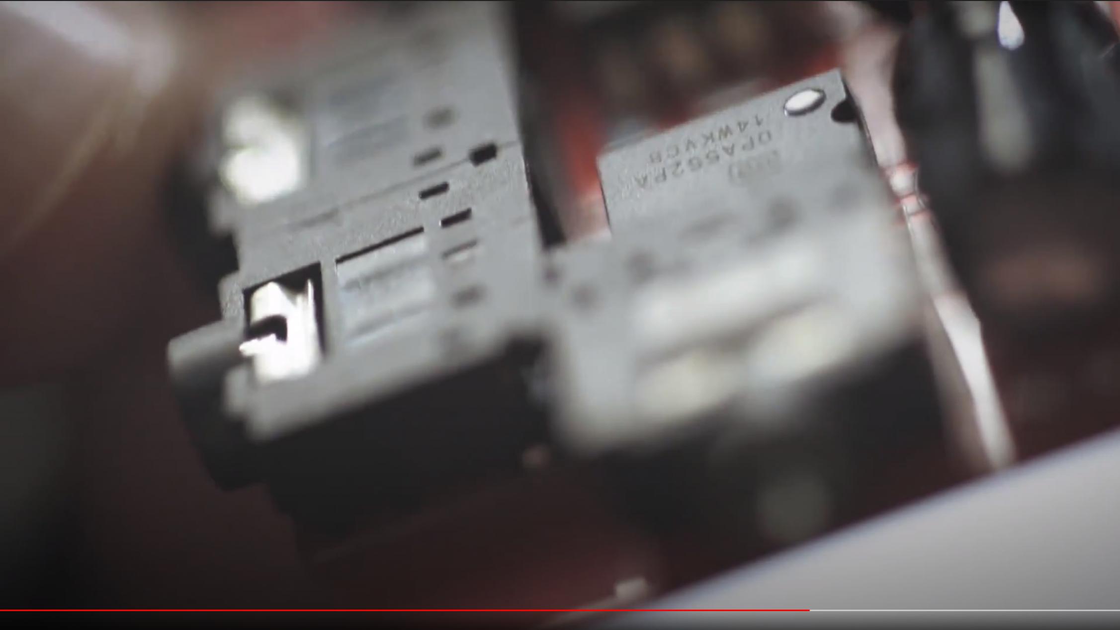

DontHertzMe: Good detective work on the OPA 🙂
Believe it or not, I created this thread not for full-sized headphones (certain models need even MORE pwr than 1-watt), but for certain IEMs (a new planar magnetic type that do seem to need gobs of pwr).

You can use DCDC step up for more voltage. But 500mW is more than enough unless using HE-4 82dB planars which need 3W. Really a speaker amp.
OPA6120A2 is capable of 700mA +/-15v and as low as 16ohm load, low distortion, and sounds great.

However I think your main problem is simply going to be power density in the power source: 10mA draw at say +/-12v is very nearly five times the power dissipation when compared with some small device running off a single 5v rail. But a 5v usb powerbank and something like Jan Didden's 'silent switcher' psu board could be a good start there, to give you up to +/-15v supply rails - from a single 'battery''source that can be charged off any available USB output.
