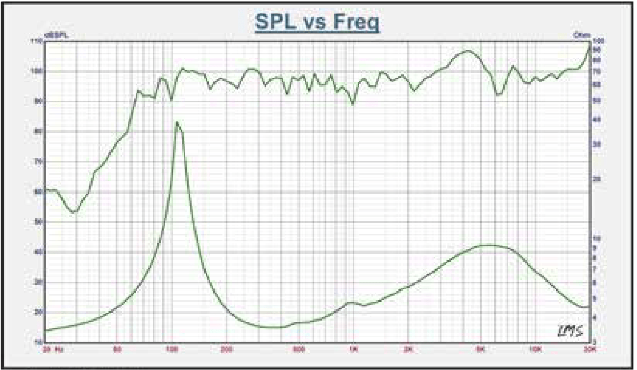

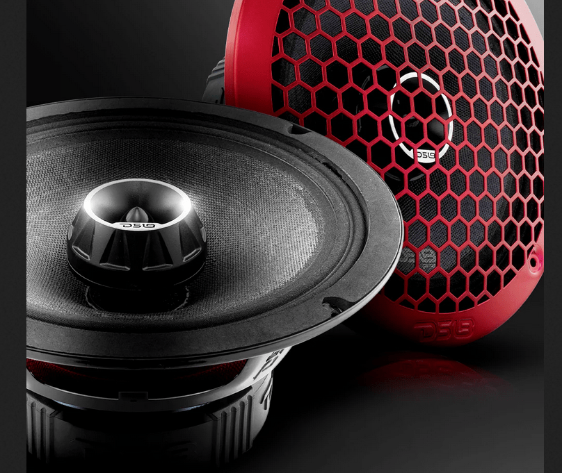

I have been eyeing this one for a while as shipping from US is very expensive for my location. Would something like this be any good for a decent pair of mains? Does anyone know what type of tweeter this is? If this thing can do well, either hung of 150wrms would be brilliant. The tweeter leads can be separated, and the unit used in an active two-way, which is how I would prefer to use it with DSP
That's another thing that I am getting a bit mixed up with, especially how much power would I need for the tweeter? Would 10w be enough to keep up with the woofer?
Apart from the high power use, how would this coax go with a small tube amp in a different use. I have been looking for a pair of coaxials to use in a battery powered portable with 10w + 10w

Is this a compression type bullet tweeter?

The racer version has a lower Fs of 85hz, and they recommend 80hz xover point for both

Art, trying to absorb what you have been saying about such things but struggling with calculating the biamping needs with these two drivers. Trying to figure out how small an amp can the tweeter use match with the woofer getting 150w. Will appreciate your help with figuring out this one. Thanks

It's difficult to tell but it looks like a regular direct radiator on a pod. 1" voice coil.Can anyone figure out if these are compression type tweeters?
Thank you. There is another 8" with a compression driver. Trying to decide between them. The PRO-ZT 8" and 6x9" appear to me as having a smoother top end and better low end. The 6x9" is most appealing from things within reachIt's difficult to tell but it looks like a regular direct radiator on a pod. 1" voice coil.

With no information about the "bullet tweeter" other than it having a 1" voice coil and aluminum alloy diaphragm, impossible to say.@weltersys
Considering the rising upper response, it probably narrows to ~30 degrees above 10kHz, on axis 1/w/m sensitivity could be in the 104- 112 range.
If it is +10dB more sensitive than the "98dB" mid, it would require 15watts to equal the mid's output at 150watts.
