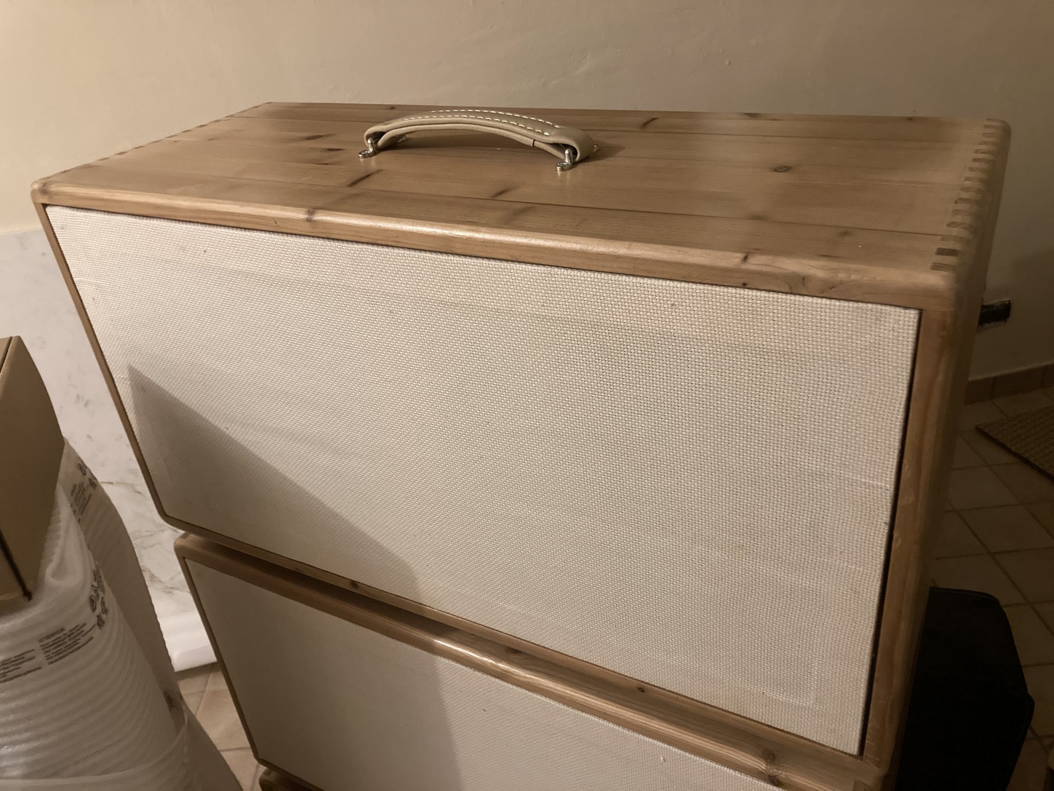

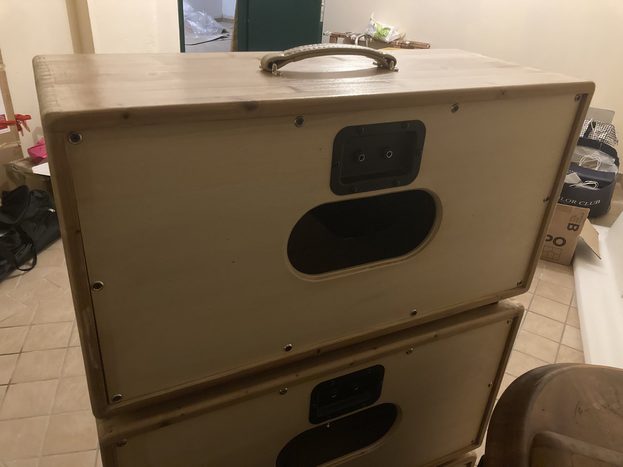

Actually I have one #1 and one #2 (it is quite common to mix different speakers in the same cabinet to have the possibility to have different sounds when close miking the two speakers) in the same cabinet, semiopen on the back as per photos below. Is it technically an open baffle?

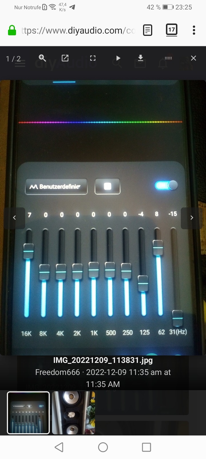

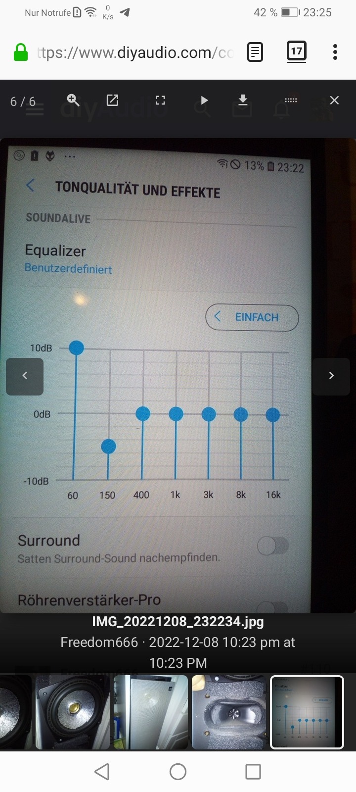

It is quite easy to EQ a resonance down and add some deeper bass with an EQ on a smartfone if it has to be cheap. Or you buy a Behringer DEQ2496 (or any other one) with its microphone you can EQ any speaker out

Thanks, but I would like to understand cabinet effects on speaker performance, not electronic effects.It is quite easy to EQ a resonance down and add some deeper bass with an EQ on a smartfone if it has to be cheap.

Thank you guys, so for speaker #1 and #2 what I can do first is work on existing rear baffle with:
The latter will be beneficial in raising the impedance below 200 Hz but limiting the peak: it will most probably work best with the "low-mid boost" circuit of most guitar amps, that reduces the feedback in that range of frequency (with the disadvantage of loosing control on lowest notes of the instrument).
Is the Karlsonator a possible choice?
- an hole at least of 2x Sd (being two speakers);
- an hole even smaller than the actual one;
- fill part of the cab and fix a dampened hole for aperiodic.
