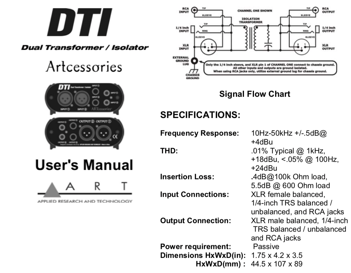

The DXR12s or any powered speaker should not have any audible hum unless the power supply is going bad or the system has a ground loop. If the hum goes away when the input is disconnected with the input turned down, the hum problem is a ground loop.2) My DXR12s have a nasty hum that's really distracting. Not a huge deal for a nightmare or club, super annoying for a living room. I know that I could run balanced connections instead, but my living room already has a mess of distracting cables and I don't have the time or energy to route everything through the walls.
Balanced connections can provide excellent common mode noise rejection, but are not insurance against ground loops.
With a mess of distracting cables connected between various units that may not all share a decent ground scheme, getting rid of the hum and buzz often requires galvanic isolation, AKA transformers, like this:
Note the input XLR pin one (shield) is isolated from the output, step one for eliminating a ground loop on balanced connections.
Can't eliminate the shield connections on RCA or 1/4" TS connectors without loosing signal unless using an ISO transformer.
I use Ebtech Hum Eliminator™ transformers with similar specs, but they may not be currently available.
ART makes good stuff, but I'm not associated with them in any way other than as an end user.
Anyway, transformers may be a passive solution your wife will approve.😎
