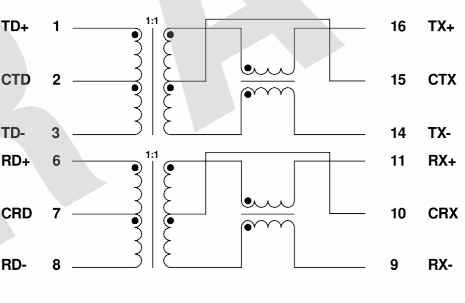

I need to isolate the spdif signal from a noisy source to a WM8805 transceiver. I have been reading that the toslink connections available nowadays aren’t able to do 192khz anymore. So that leaves me with ‘normal’ spdif.
Since my two boards are in the same enclosure, i was thinking to just use a high speed optocoupler to do the isolation. Something like this https://www.mouser.com/pdfDocs/Renesas_RV1S9960A.pdf
Do you see any issue with that? (Or is there a better solution?)

Why not use a pulse transformer? The issue with optos (and Toslink) is the pulse width distortion - I guess how much jitter results depends on which edges of the input signal the S/PDIF receiver uses to regenerate the bitclock.

I’ve actually bought some ethernet pulse transformers but i am confused how to use them in this application. The differential pairs are the issue for me. I got these Blocked the combination of differential and common mode confused me. Do you have experience with these?

No ethernet transformers are for a different purpose: ethernet.
I'd suggest not - the main issue is the primary inductance is showing as 300uH. Whereas for a purpose designed S/PDIF pulse trafo, its roughly 10X that. PE65612 is what I use on S/PDIF.

Perfect. Thanks. I recognize that part. I found a thread where people recommended a newava part as well https://www.digikey.com/en/products/detail/newava-technology-inc/S22083/555461 i’ll pick one up to do some experiments for the future.
