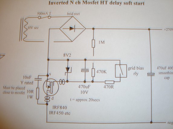

One of my 5 minute design slow turn-on circuits using an upside down mosfet in the rectifier AC neg leg and the negative bias supply to actuate a small relay as a self protect B+ shutdown in fixed bias systems. Mosfet selected for max voltage.
This circuit works well but haven't tried it with a power IGBT, but the concept should work for other voltages with a bit more workin' out. Those round circles in mosfet legs are ferrite beads. I love'm.

richy - have you checked what time duration and peak current level pass through the fet during soft turn-on, and how that compares with SOA? Ciao, Tim
