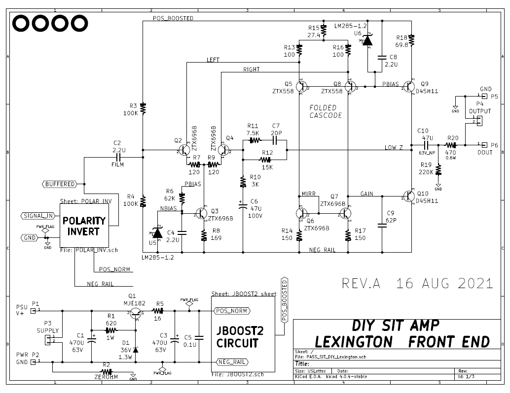

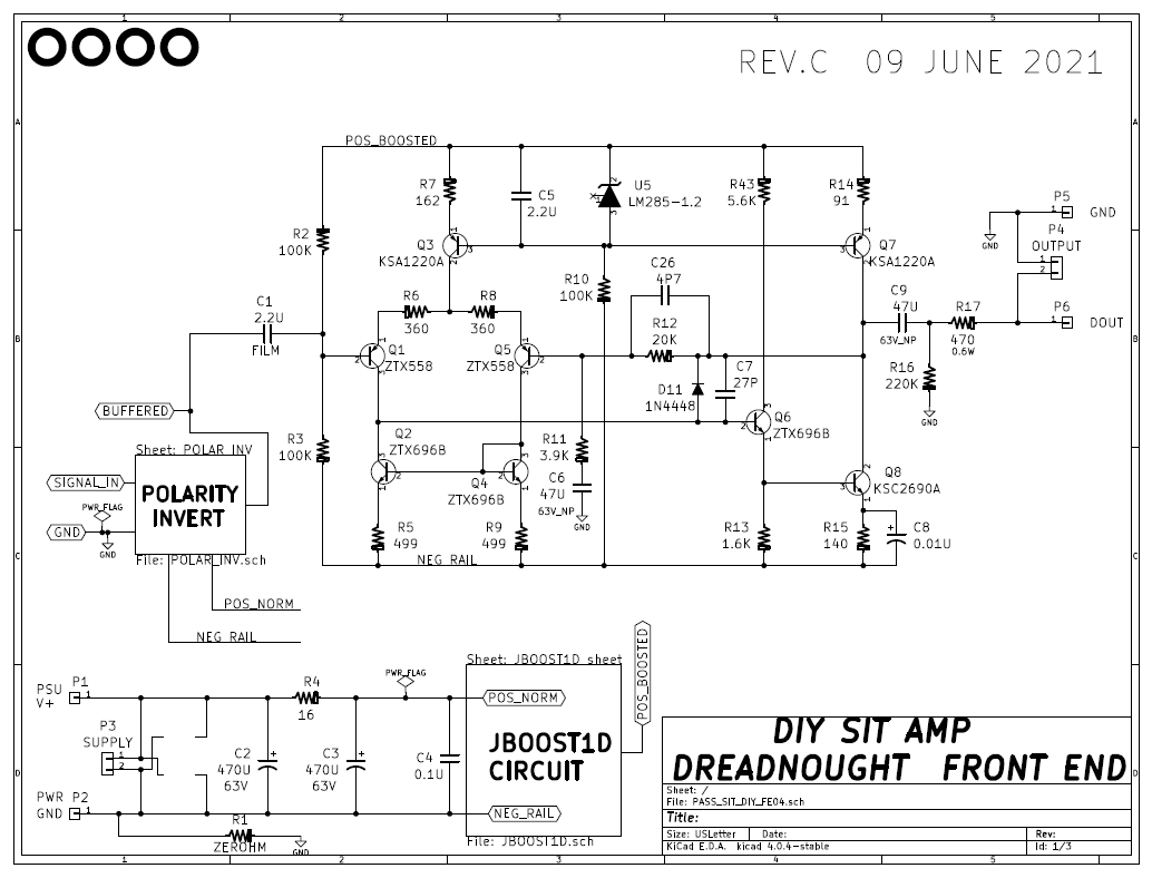

One of the (many) Front Ends for the VFET amplifiers that diyAudio sold last summer, is "Dreadnought". It operates from a 60 volt, single ended power supply. Easily reconfigured to +/- 30 volt rails. Maybe you might think about starting with circuits similar to it. Pull the datasheets for the semiconductors, I think you'll discover they all are >100 volt rated, so if you upped the voltage (and turned down the bias current to keep device power dissipation reasonable!), you probably don't need to hunt around for higher voltage replacements.
(for the purposes of this thread you can ignore the blocks labeled POLARITY INVERT and JBOOST1D. What you are interested in -- the preamp circuit itself -- is here on this page.)

Another VFET front end with a different topology. BEWARE the D45H11 output transistor is "only" rated for 80 volts. Maybe you'll feel better with the KSB546 which is rated for 120V. (All the others are >100V though). Designed for 60 volts single ended supply (+/- 30V dual rail), extensible to +/- 45 volts straightforwardly.

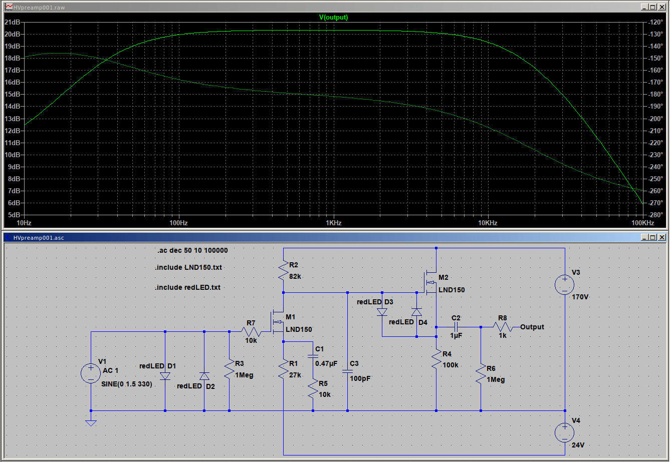

I've seen 'scope captures here on diyAudio, showing 10 volts peak-to-peak, straight from a hot humbucker pickup!When you strum the guitar strings heavily, you get a peak to peak voltage exceeding the bias setting.
10 volts is definitely unusually high. But 1-2 Vpp is not unusual.
So I agree, the input stage has to be designed to cope with signals in that vicinity.
Now, what did Leo Fender do in his most famous tube guitar amps? The input stage was half of a 12AX7, with the grid tied to ground, and the cathode floating up to around 1.4 volts.
Grid current begins to flow when the grid voltage gets within roughly 0.5 volts of the cathode. So any positive signal peaks bigger than about 0.9 volts will cause some grid current to flow. That grid current flowing through the guitar electronics (volume pot, etc) will round off the voltage peak a little bit. Transients from the guitar are already softened a little by the very first preamp tube grid!

Just for fun, I drew up a high-voltage guitar preamp input stage using two LND150 MOSFETs. I've built similar circuits for other purposes.
The +170V DC supply rail is easily obtained by rectifying the output of a 120:120 line isolation transformer. The -24V rail is easily obtained from a 12-0-12 transformer, or a voltage doubler connected to a 12V AC transformer.
The use of a 24V negative supply rail simplifies biasing, and makes the operating point rock stable against parameter variations in the MOSFETs, and/or temperature variations.
The two pairs of red LEDs are used to protect the MOSFETs from excessive gate-source voltages in either direction. You can use green LEDs here if you want to allow wider Vgs swings before protection kicks in, but it isn't necessary.
The 10k series input resistor reduces the chance of picking up local radio stations via the guitar cable and internal wiring.
Voltage gain is set to 10x (+20 dB) by R1/R2/C1/R5. C1 also sets the lower -3dB frequency, chosen well below the 82 Hz lower limit of a guitar in standard tuning.
R5 can be reduced if you want more voltage gain. I wouldn't go for more than 50x gain (+34 dB), which will be achieved if R5 is reduced to 1k. C1 should be increased to 4.7uF if this is done, to maintain bass response.
C3 rolls off high frequency response above roughly 20 kHz. There is nothing good from an electric guitar above 5 - 10 kHz, and by limiting excessive high frequency response, we get a stabler amplifier that's less prone to be bothered by RFI or electrical noise.
R8 is a build-out resistor to keep the second LND150 (M2) stable, and stop it from oscillating at radio frequencies if the output of the circuit is connected to the wrong sort of load (a long coax cable, for instance).
C2 can be changed, depending on the impedance of the load the circuit is feeding.
The circuit will easily handle 3Vpp input signals from the guitar (hard strumming with hot pickups) with no clipping anywhere. There will be tiny amounts of good-sounding harmonic distortion in the output, particularly if you raise the gain by using R5 = 1k.

Thank you very much.
I studied KMG's designs, heard the mp3 demos but found too complicated for me.
I do not play distortion at all. My amp is 2 x 40 watt capacitor coupled, driving 2 nos 12" speakers in open back cabinet.
I find most speakers do not sound good if driven more than 30 watts.
Speakers with thinner cones sound beautiful.
Wanted to do the same as your design with bjt, but there are not many choices for a low noise hv transistor.
Will look in to this. Thank you again.
Best regards.
