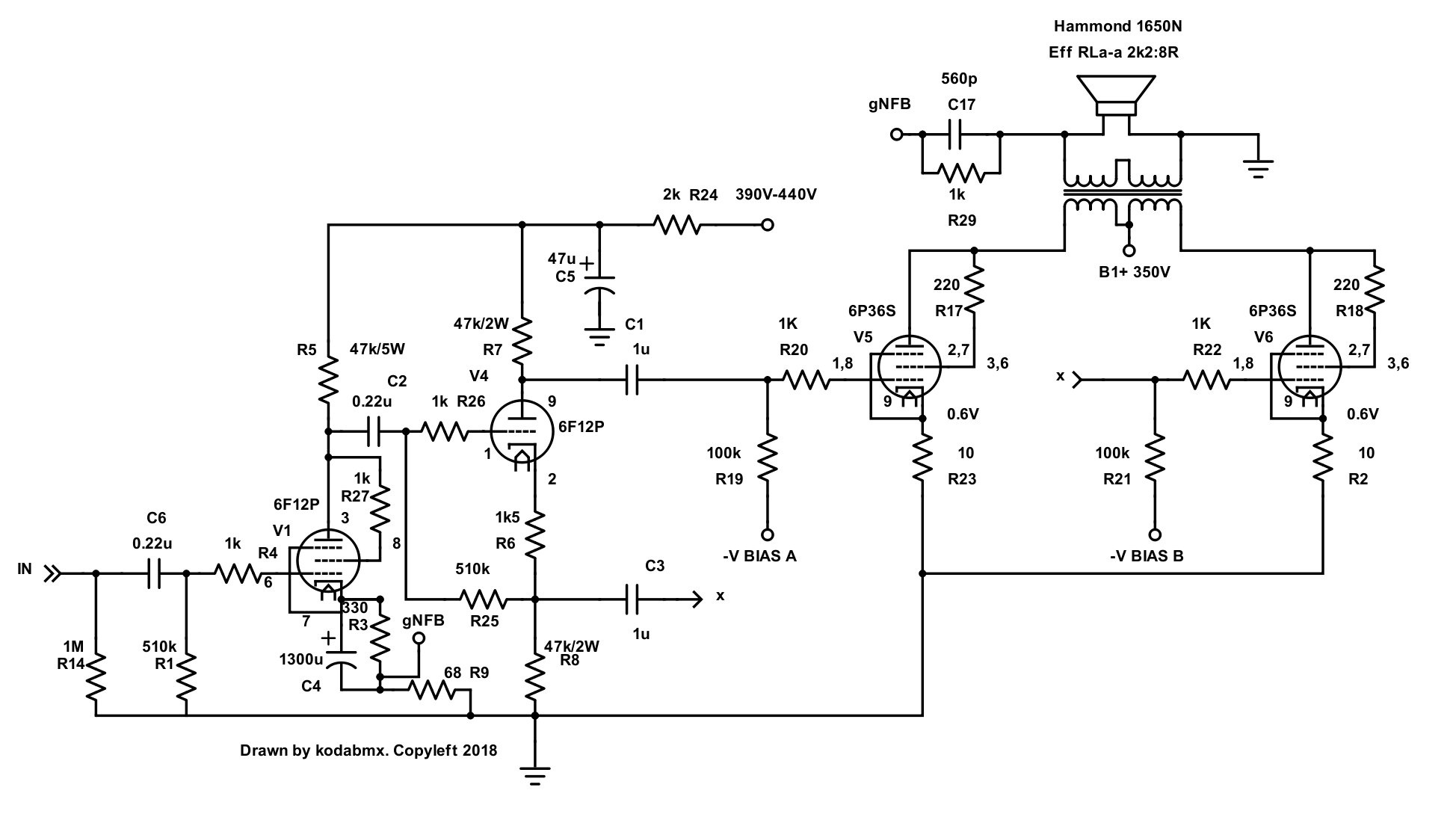

There are many high power designs, some of which I've designed myself including the attached.
Low cost to implement, low distortion, and pretty simple for a push pull amp.
It uses triode connected 6P36S Soviet horizontal sweep tubes for the outputs.
The tubes can be bought for under $10 if you look hard enough.
The OPT is a 1650N with the with the 8R speaker on the 16R tap to reflect 1/2 the 4300 Ra-a it's designed for.
The bias is set now set to 80ma/tube instead of 60ma.
