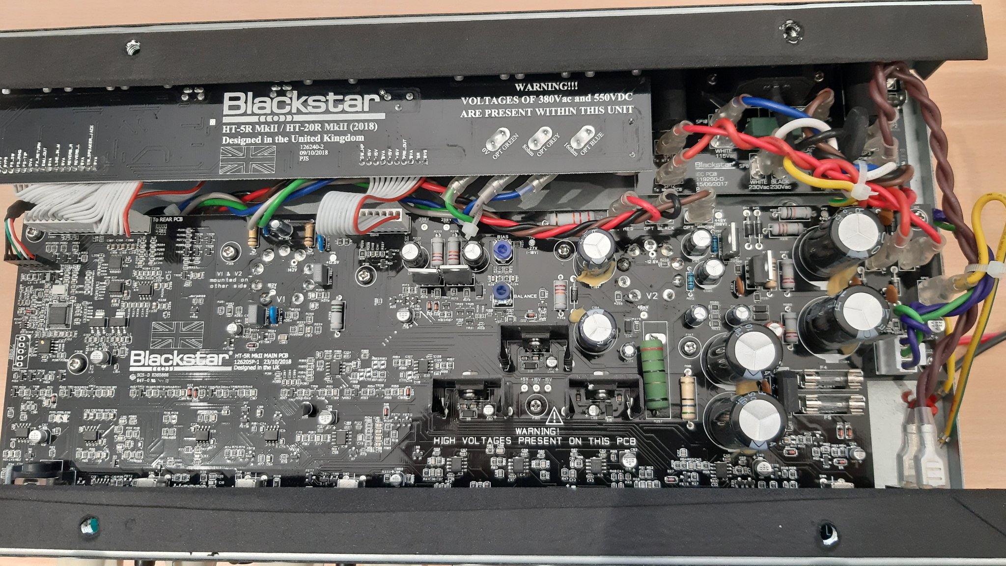

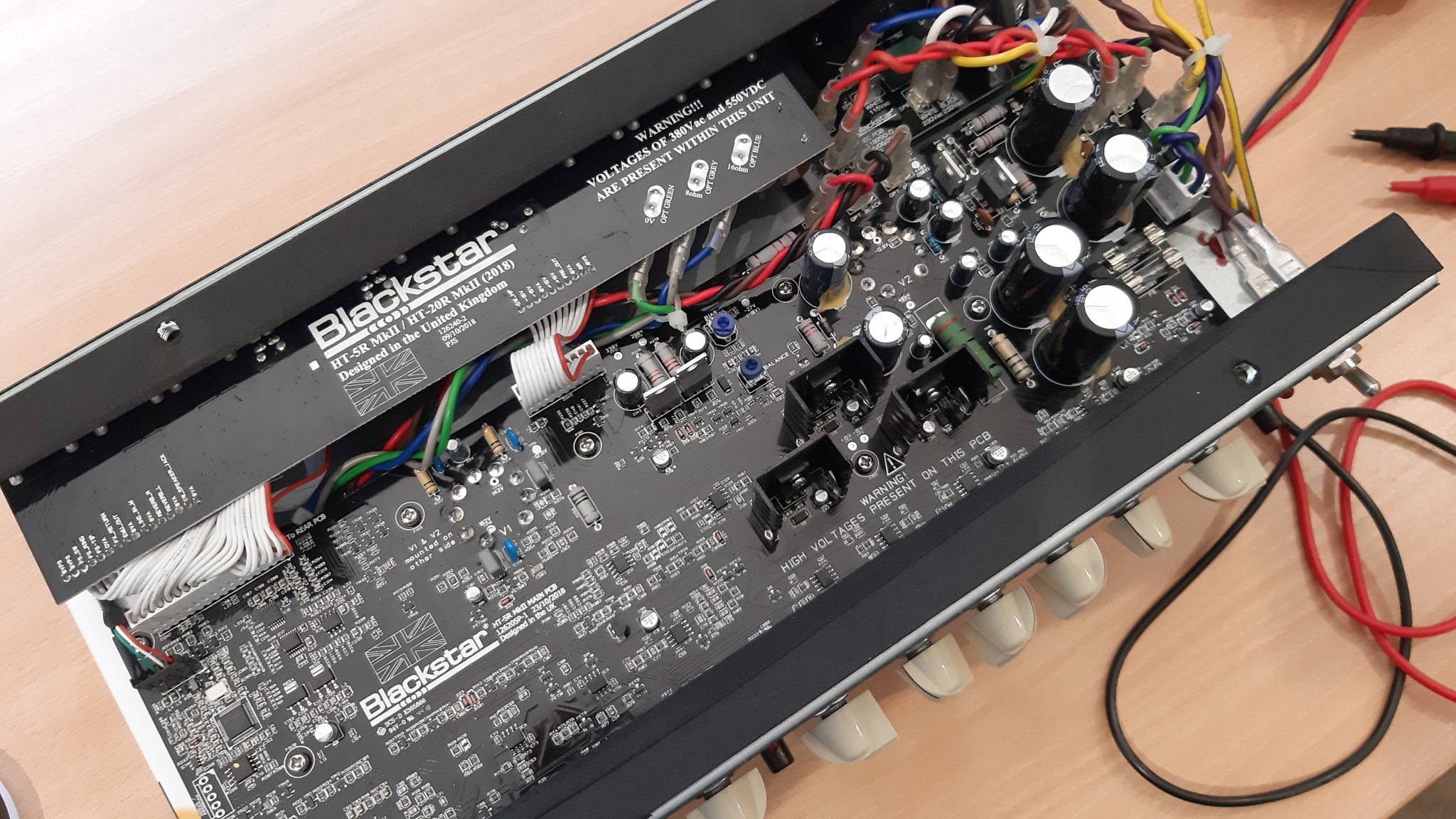

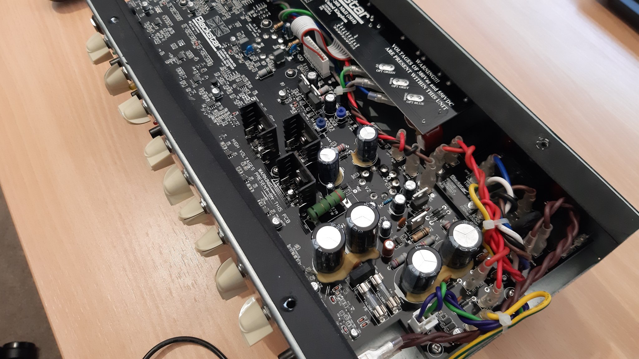

I started to play the guitar a few months ago and got a second hand HT-5R MkII at a good price, but it has a significantly loud hissing problem, especially on the dirty channel when cranking the gain up.
The noise on the clean channel is really low, so I am not worried about that one, but I am wondering if the "hissy" overdrive is something that could be considered as normal or not as my experience with tube amps and guitar gear is limited.
As far as I can tell, the hiss comes from the preamp section.
I replaced the stock preamp valve (Ruby 12AX7) with a Tung-Sol 12AX7...no changes.
Touching up the overdrive EQ changes de colour of the noise slightly.
If I bypass the preamp by connecting my guitar multieffects (Boss GT-1) output to the effects return of the amp, I can play and there is no hiss I can hear.
If nothing is plugged to the amp's guitar input, there is no hiss at all (this is what makes me wonder if there is an actual problem).
I opened the thing to take a look and there isn't any obvious sign of damage or component degradation, at least on the top side of the PCB. I did not look underneath as this requires some additional effort, so I decided not to do it for now.
