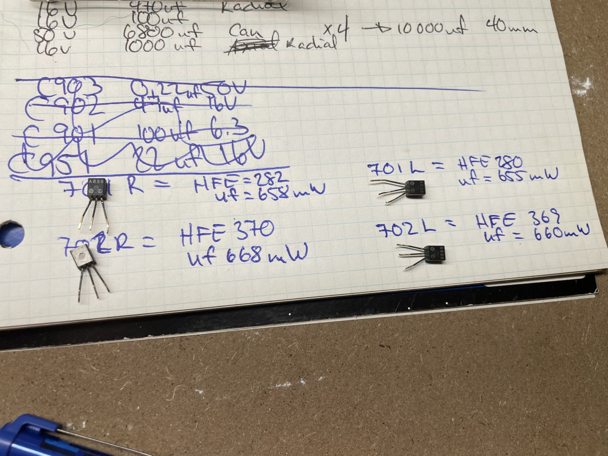

As the title says, I have a ha-330 with quite a lot of dc on the outputs. It has 215mV and 250mV. I’d like to be able to identify the problem without replacing a lot of random parts until I get it. The amp still plays music "fine" but obviously not at its best right now. Could somebody help/guide me through this ? I verified a couple things but there’s not an obvious problem that I can fin. What would be a good procedure to follow in order to find the problem ?
I checked the voltages at all the transistors following the schematic. Most of them are a little off but nothing seems completely wrong. The voltages coming from the power supply are like 1V higher than what they should. All the electrolytic caps are new and good quality.

I suggest taking DVM measurements at bases of Q701, Q702, and junction R707- C705, and output at L701. Careful measurement should reveal a lot of what's going on. Make sure meter negative probe is consistently connected to local ground, eg. at bottom of R703.

Those are the measurements I did of the original Q701/702. Left and right measure about the same, but there’s a big mismatch within each pairIn this case, high DC beta is more important to minimize base currents, and hence DC voltage drops across the resistors,

I need to find a good replacement for the 2SA836. BC557BTA looks about right but the legs aren’t in the same order…

Bases voltages :
Q701L : 188mV
Q702L : 165.5mV
Q701R : 288.2mV
Q702R : 280.4mV

Q701R : 296mV
Q702R : 285mV
Q701L : 252mV
Q702L : 229mV
So now base voltages are :
Q701R : 296mV
Q702R : 285mV
Q701L : 252mV
Q702L : 229mV the
