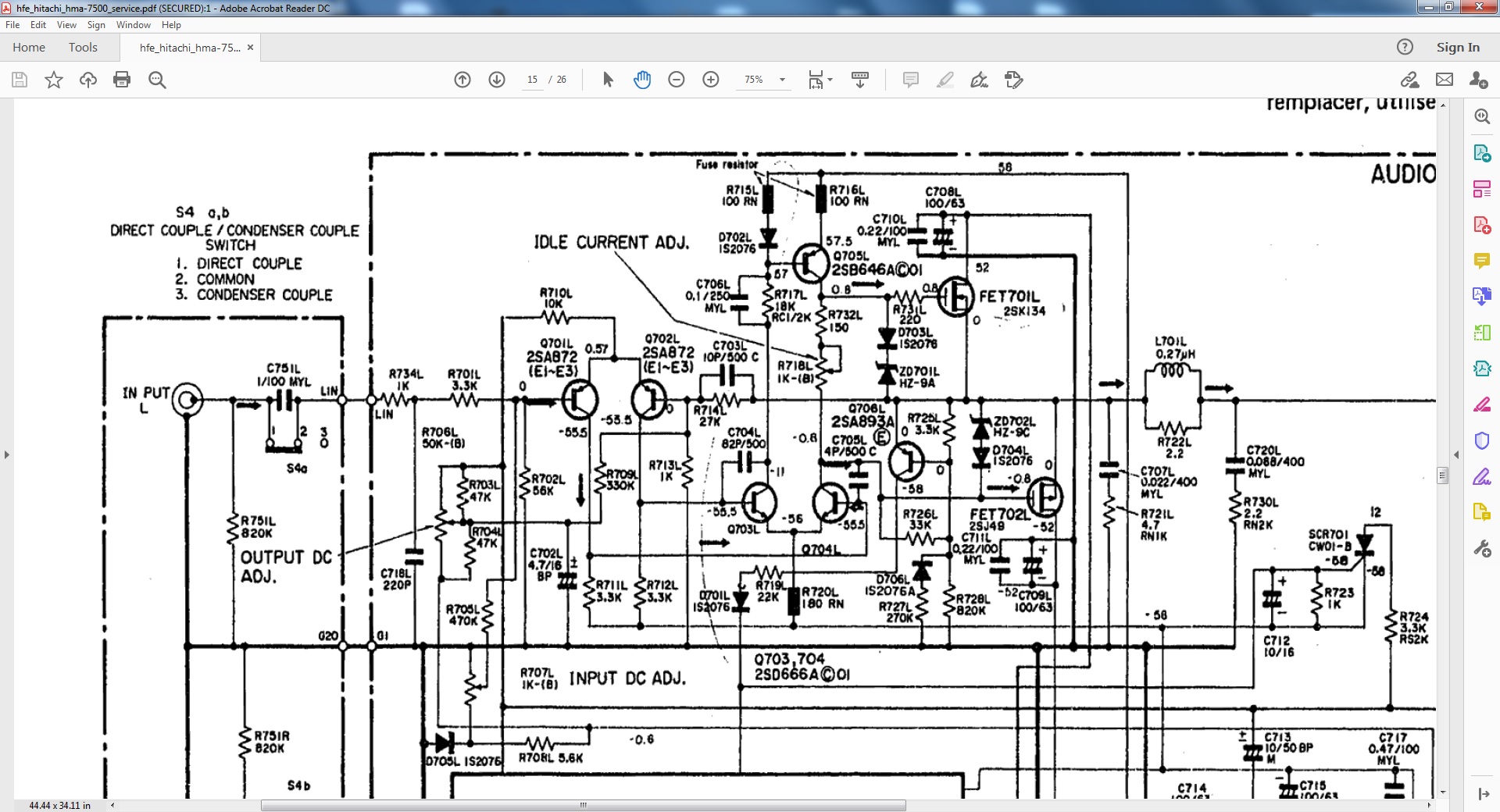

Collector voltages for Q705 and 704 are given, and they set the bias. Are they in range?
The fusible resistors in that LTP section may get tired, and increase in value. If they do, the bias current will drop. Meter check them?

Thats pretty much same circuit as Hitachi lateral mosfet data sheet.
Bias current is checked by removing B+ fuse and putting multi meter across the fuse on mA setting. I am pretty certain it was 100mA bias current.
100mA is standard standing current for a lateral mosfet.
200mA would be for 2 pairs.

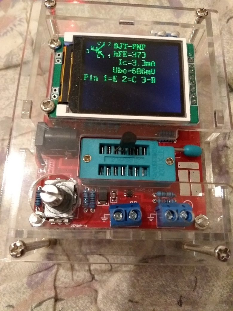

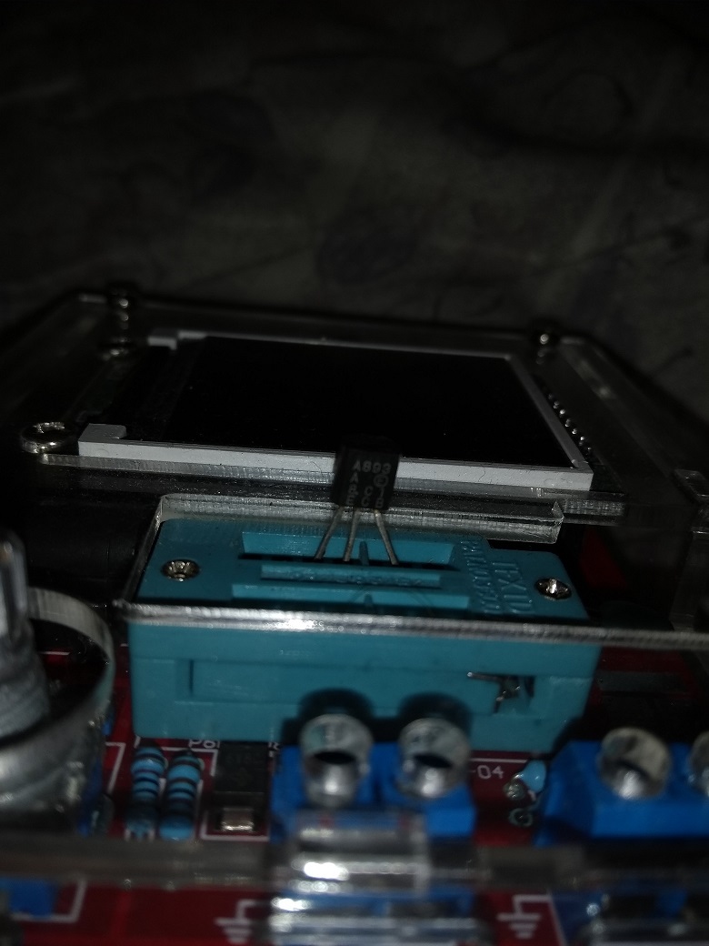

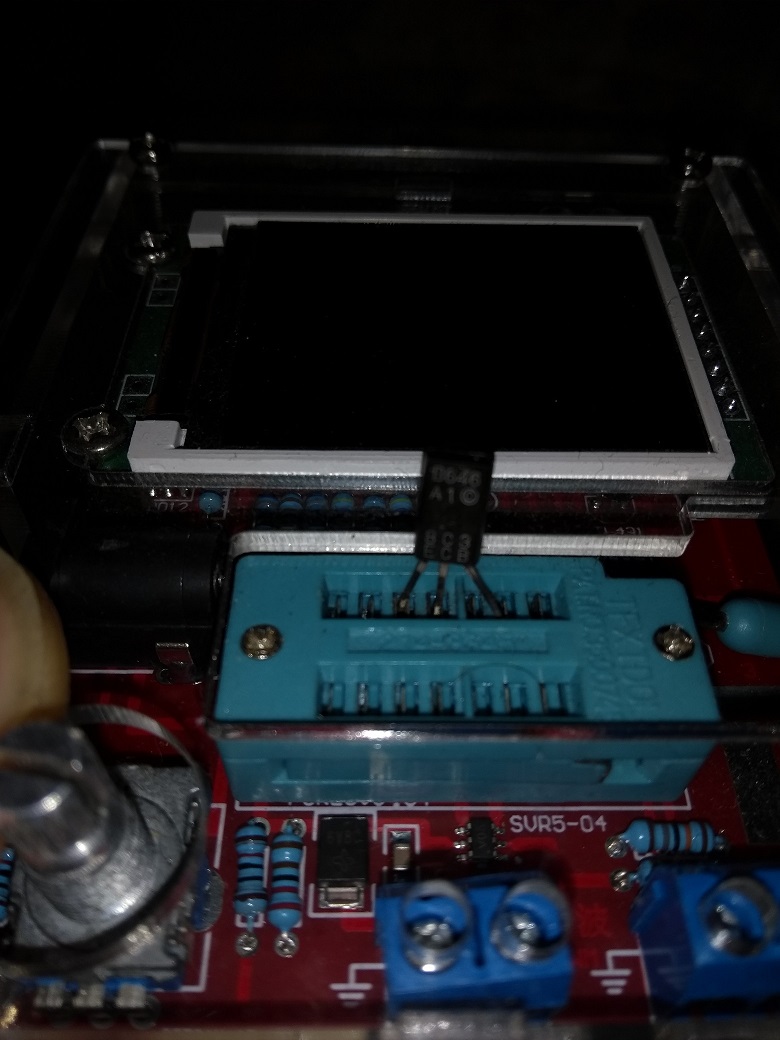

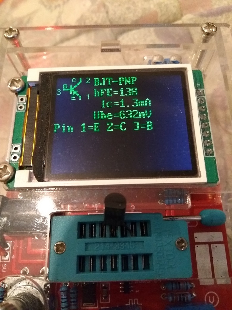

I'm literally about to pull out the transistors.
I only now understand your question. I will put back the transistor and test the voltages

Yes, it's Sampei's schematic. It even found its way into IEEE papers in the 1970s; and it was used in large numbers of amplifiers for years after that.
100mA is approximately the Zero-TC current, so the idle current should preferably be a little higher than that. The ±0.8V bias voltages suggest that they really did mean 200mA, so I would stick to that.
Measuring the bias voltages is the first step.

Its fixed! must have been a bad solder joint!!! put transistors back and touched up a couple of bad looking connections and measure again just to make sure I didn't do more damage and it was fixed!!
Thanks a lot for the very helpful input!
