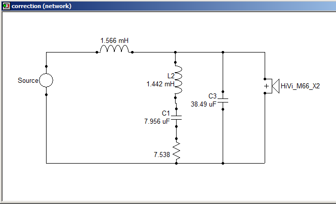

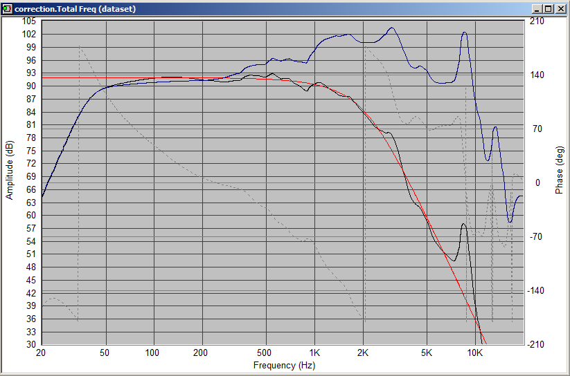

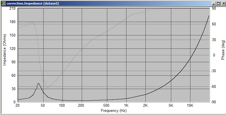

I did a little playing and I don't think it is that bad to deal with. Note Ing you should do your own modeling as I may have made a mistake, as I did it pretty quickly.
What I did was trace the HiVi curve, add baffle step (using your cabinet dimentions (but only one driver) using response modeler spreadsheet. I then spliced in low frequency data based on your cab and tuning using response blender spreadsheet.
I took that and loaded into speaker workshop, set a goal of 4th order accoustic bessel at 2Khz and the below is what came out.
Note that the rise between 50 and 200Hz (over the original response) looks sus to me. but I think it shows that the drivers can be massaged into shape.
note I increased the spl 6db and halved the impedance (to simulate the two drivers) rather than using two drivers as the speakerworkshop optimizer doen't work with more than a single driver. Note I didn't spend much time trying to tweak this so it can almost certainly be improved 😉
Tony.

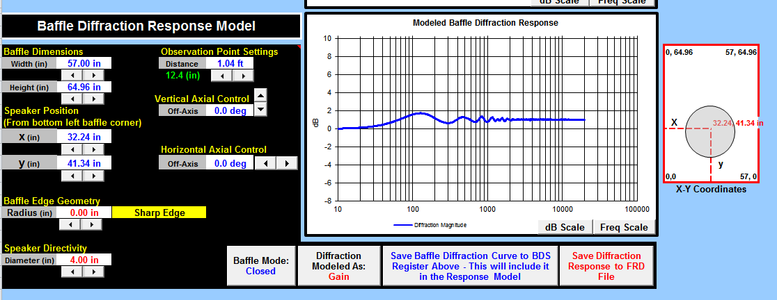

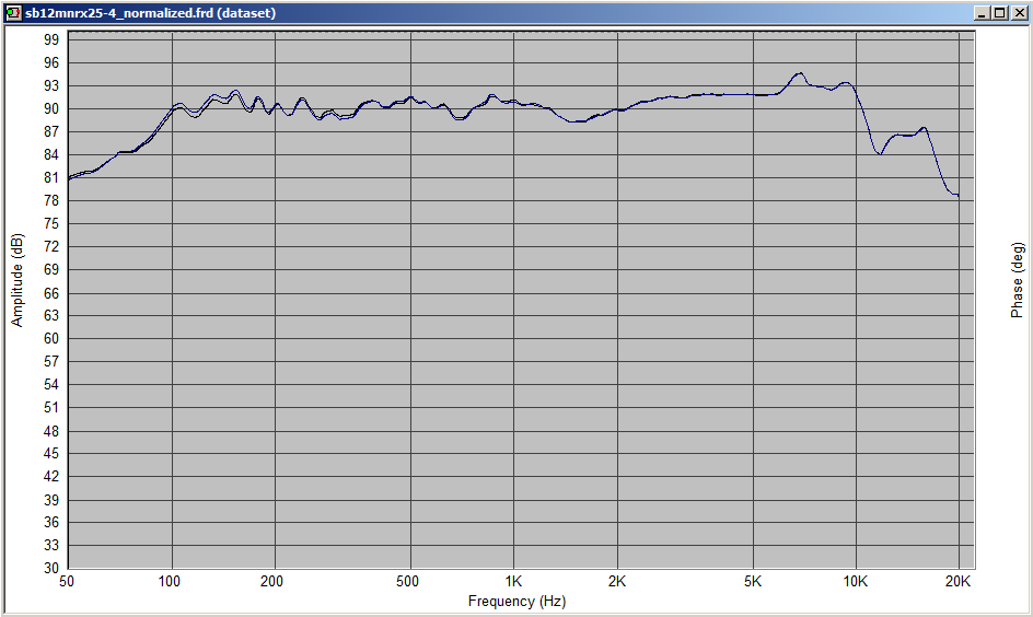

I've just been playing around with it. But I'm not 100% convinced it works as it should. I traced SB12MNRX25-4 spl curve (because I have one) and set up an IEC baffle in the response modeler spreadsheet. (setting the distance as it is specified on the SB datasheet).
The thing that doesn't seem right is that when modeled as a gain it simply increases the SPL rather than decreasing it. The actual baffle diffraction data is not inverted (as I would have expected)..
I applied it as a gain and then loaded the new version into speaker workshop to compare to the original. There is not much difference, but I think the change is incorrect.
Below a screen shot of the SW comparison, and how I set IEC baffle in the response moddeler spreadsheet. The blue curve is the adjusted one. It seems it has just added the diffraction curve to it, not subtracted it.
I suspect that when modeling low frequency with a box modeling program and splicing it at 300Hz or so that the effects of the IEC baffle could probably mostly be ignored.
Tony.

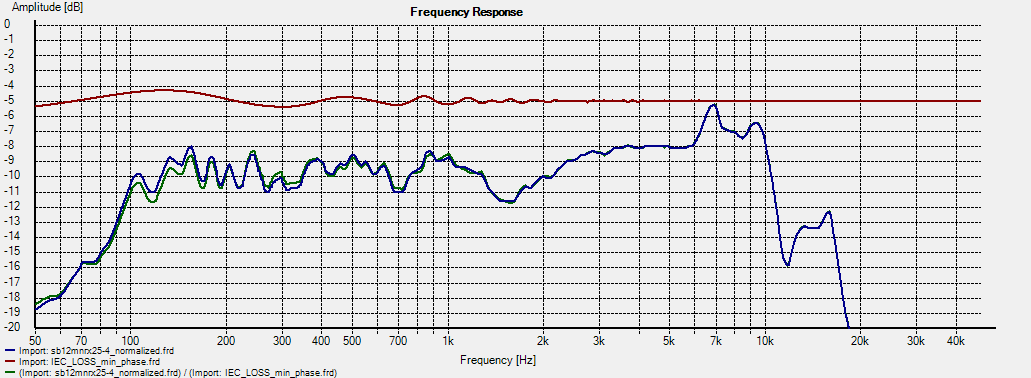

Just for completeness here are the measurements in holm impulse. Ing you do not need to worry about this for your factory measurements of the HiVi as I do not believe (looking at it's response curve) that it was measured on an IEC baffle.
It is possible to do this if you want the best accuracy but if splicing in simulated low frequency response below 300Hz it looks like it will make little difference.
Tony.

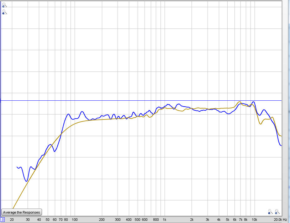

Here is a comparison of the simulated result (using traced manufacturers curve and blended in simulated low end response) compared to an actual outside measurement of the finished speaker (which is 1/6th ocatave smoothed). Blue trace is the real measurement.
I would say that the correlation is pretty good. The nastiness in the low frequencies in the real measurement is due to reflections.
Sorry for the OT Ing, I hope it was at least informative 🙂
Tony.
