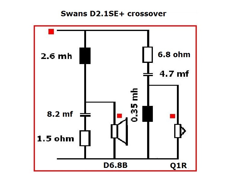

- Тонколони - Направи си сам - Swans - D2.1SE+ KIT. According to the website the crossover provided with this kit is an exact copy of the one in D2.1SE. My crossover modification, which I suggested in my previous post, is based on this one, but with an additional work of my own to tame the emphasis in the high frequency range. More on that later.

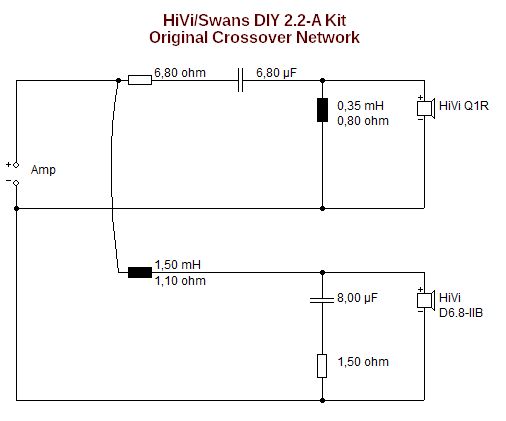

The crossover:

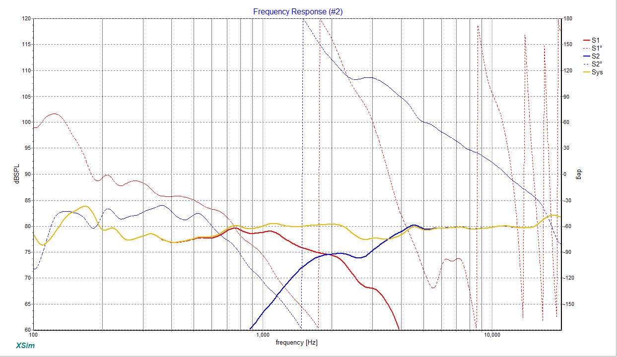

At first glance, the low-pass filter in the original crossover (picture 3) seems a bit odd. It looks as if it’s 1st order with impedance compensation network, but it’s actually quasi-second order. We can see the same structure in the crossover from the D2.1SE clone (picture 4), but with a different inductor (2.6 mH). In my opinion, this is a well working design for these drivers and after some experiments and simulations I couldn’t come up with a better solution. I chose the second crossover variant over the first one by comparing them sonically, but even then I was not completely satisfied with the sound. I could still feel some extra energy in the high frequencies and my measurements only confirmed that. I added an impedance compensation network in the high-pass filter, which smoothed down the tilted response of the tweeter, including a nasty bump in the top end. I also added LCR network to address the hump in the rolloff section of the tweeter’s response. It’s basically a broad notch filter aimed at the resonant frequency. Its effect is hardly audible, but it’s an additional safety for the tweeter as it dampens the resonant frequency even more. It also helps to bring back the phase response to what it was before introducing these two networks. As I mentioned before, the phase alignment is not great, but in my opinion it’s fairly reasonable. On picture 5 you can take a look at the crossover simulation, where the phase shift is also visible.
In conclusion:

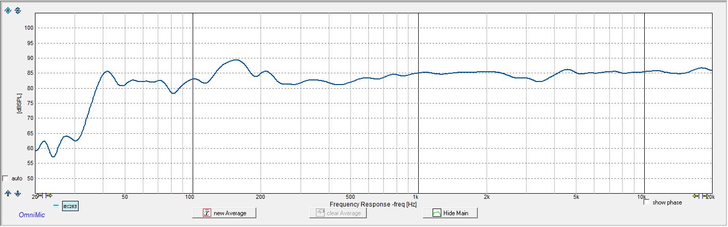

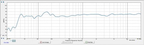

A measurement of the frequency response of the system with the modified crossover is shown on picture 6. Unfortunately, I don’t keep the measurements made with the original crossover and I can’t demonstrate the difference between the two. On axis measurement doesn’t tell the whole story anyway and describing the sound of a particular set of speakers is futile. What is “bright” for me could be perfectly fine for others; a good bass by my standards might be too weak for your taste.
However, there is something interesting revealed by this measurement - the dip between ca. 250 and ca. 700 Hz., which appears to be a baffle step. The online Baffle Diffraction Loss calculator that I usually use suggests a baffle step with -3dB at 563 Hz. This seems to be consistent with the graph, but I’m not very experienced and can’t tell for sure that this is definitely a baffle step. What makes me doubting is the response curve of the woofer (D6.8B) from the manufacturer’s data sheet (the last picture below) where we can see almost the same dip in its response. My assumption is that this is an inherent feature of the driver’s response and I decided to leave it as it is. My listening sessions during the crossover design didn’t give me any reasons to pursue an attempt to tackle it as an issue.
One more interesting observation is the increased area at 42Hz, just before the rolloff, which seems to confirm the F3 claimed by the manufacturer.

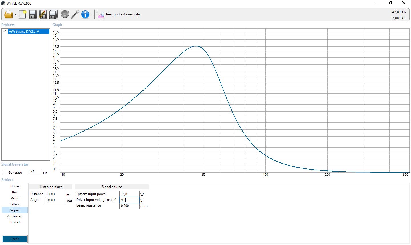

02. HiVi DIY2.2A - Port Air Velocity (WinISD simulation).jpg118.8 KB · Views: 1,653

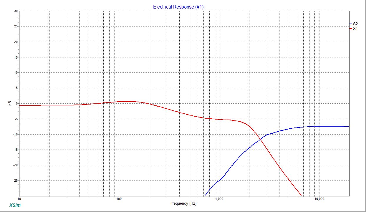

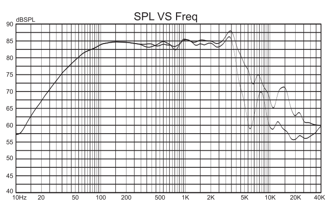

All of this reminds me of another HiVi kit employing the same mid/bass driver (D6.8B), but different tweeter. In the pdf file below you can see the details about this kit and you’ll notice a similar thing - woofer crossed at 2000 Hz and the tweeter at 2500 Hz.

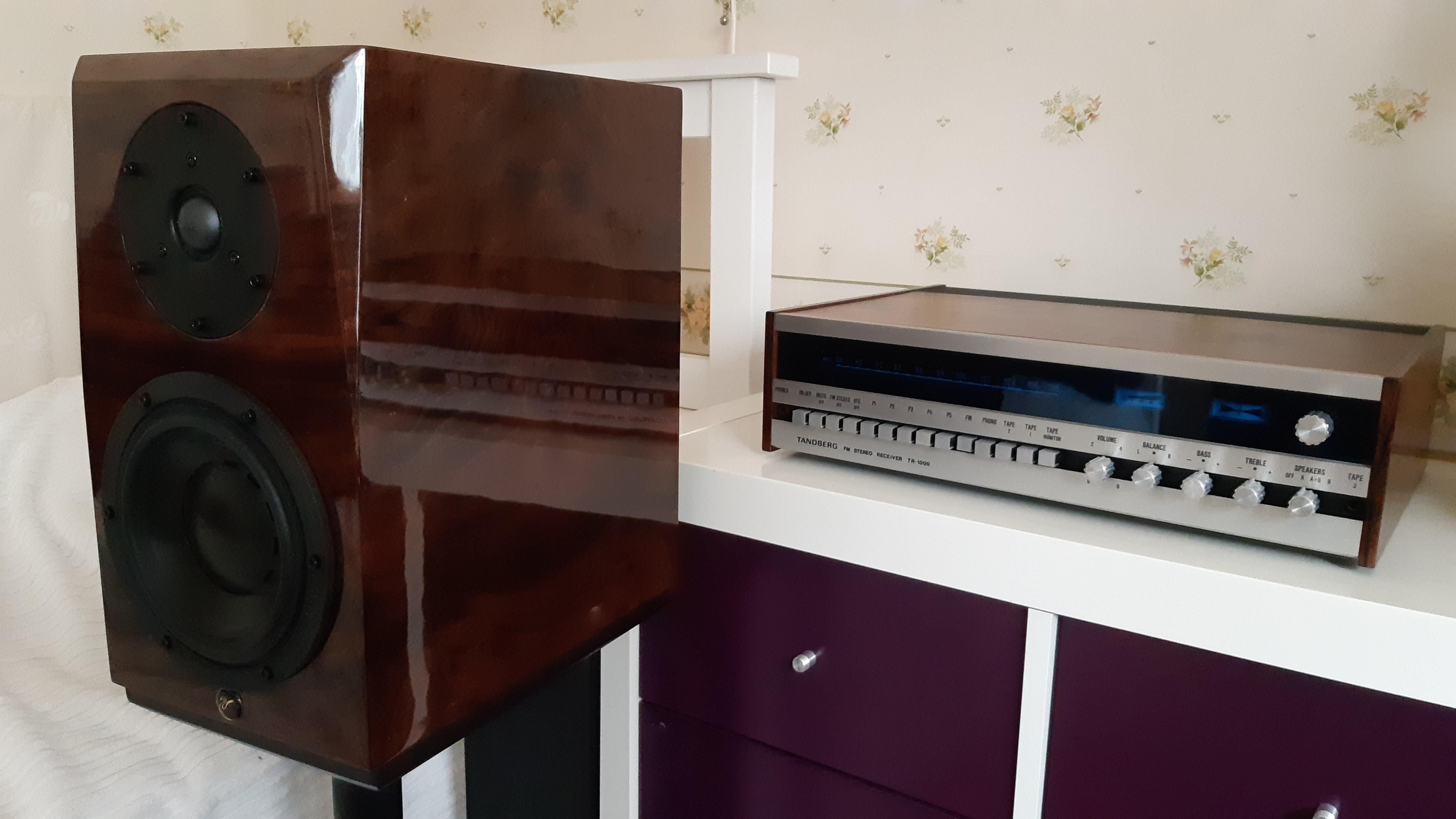

Did a test-run with one speaker, with things not fastened down. Wow, I think these will be great! Reviews have suggested that the DIY 2.2 is the same as a $800 Swan speaker, and maybe competes with more expensive speakers. Initial listening, things were very clear, but maybe a bit bright. I didn’t have it sealed up enough to judge the bass. Will do more detailed testing when completed. For now, I need to finish the cabinet- I plan to paint. Then start the 2nd box. (I wanted to do 1 box now and see if there were gotchas.))
Ok, one speaker completed. Didn’t have much time tonight, so just listened to a few things, and, yeah, sounds bright. I didn’t want to get into test tones just yet, but I do have that calibrated mic, now, so I just used it on some music. Worried that it was weak in the bass, I grabbed the nearest bass-heavy CD near me - Leftfield. Sounds like I hear the bass hits, so it seems to be getting low.

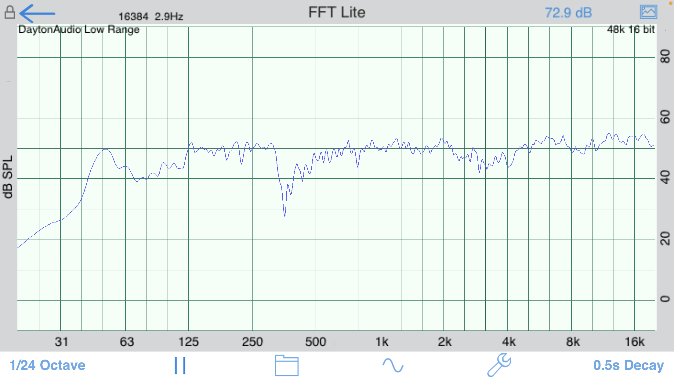

See attached. The noise floor was about 20db in the bass region, down to near 10 for treble. I was trying to keep it quiet to not disturb the household. It doesn’t look overly peaky, at least not obviously so. I mean, it’s playing music, not a test tone, so it’s going to vary, but I mostly wanted to confirm that it’s able to play low bass and that the high frequencies weren’t too crazy. Will test with test tones soon.

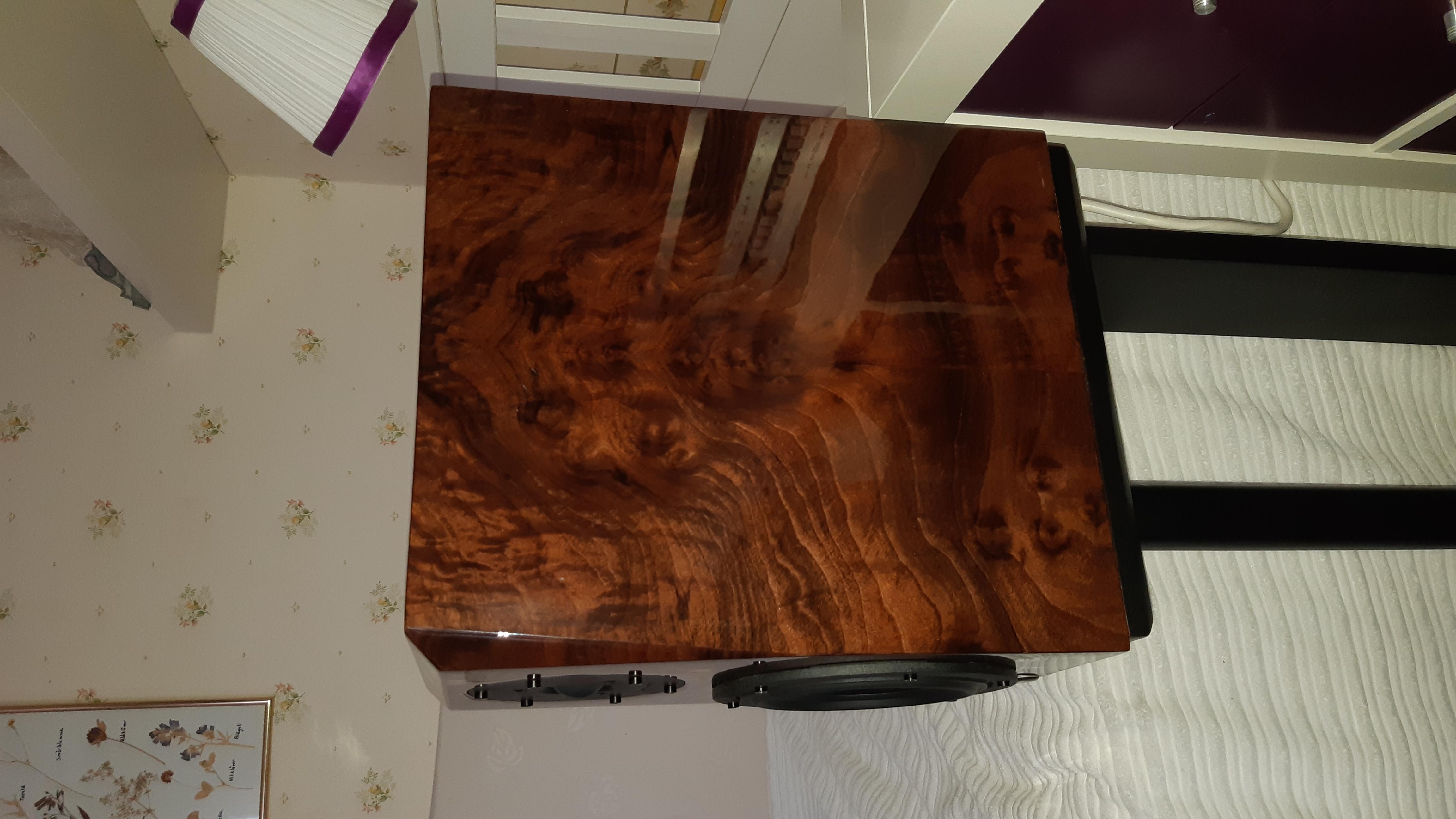

I think painting the speakers was the hardest part of this project. Took me all weekend, and it’s imperfect, but good enough.

Ok, I tested with pink noise from an old test CD. It seems like the area from about 1khz to 2khz is a bit raised, and the lower mids to bass is a tad down, until this big boom at 50hz. It doesn’t look like much, but if it averages, say, 3db down, that’s noticeable.
Based on this, that inductor mod is starting to look good. I was pricing them and the cheaper 18awg ones aren’t a whole lot better in DCR. The thicker wire ones are pricey - $20, $30... but the DCR is noticeably less. But this might explain why this kit comes with what it has - there’s no room for $60 worth of inductors in a kit that already is super cheap!

Joey, I was thinking, if you went with the Swans 2.1SE crossover mod, it would be a good excuse to do your cap upgrade. At a minimum, for each crossover, it would need a 4.7uf cap and 2.6mH inductor, I would think. And just use the stock parts otherwise.
Allex, I’m having trouble finding 2.6 or 2.7mH inductors. I’m thinking maybe a 2.5 would be good enough, combined with a slightly higher DCR (than your 2.7 above). Probably would work out about the same. Starting to be a pricey experiment, particularly when I’m trying to save money on a DIY kit! �� Still, a very affordable kit, so no worries. YOLO
While I was hesitant to rush into mods at first, after testing with the stock crossover, it seemed apparent to me that Allex was right about the bass being weak. The bass was there, it just made the speakers sound bright or thin, I guess. Also, it seemed like the efficiency (loudness) was reduced compared to a different speaker, and I really wondered how much that 1.1 ohms was dragging it down! Now that I was looking for the bass, I wasn’t going to be happy until I fixed that. As mentioned before, I decided to go with the 2.1SE crossover that Allex provided, particularly after Allex incorporated that into his redesign and seemed happy with that part of it. While it seemed like a good idea to play with a simulation, I got impatient and didn’t have the time recently to set one up, and went for it.
Here’s a graph with the changes. Indeed, the bass is now brought up to match the midrange. It looks pretty good to me.
There is still this dip at 3k. I also tried it with the original 6.8 mfd caps, only changing the woofer’s inductor, and that dip was still there. I couldn’t tell much difference between the two, really, but decided to stick with the Swans 2.1SE design, and ended using the new caps. Will listen for a while, but happy to have the missing bass.

I used a 2.5 mH coil with 0.59 ohm resistance. While selection seems to be limited, I probably could have found something with less resistance, but it would have been more expensive (and larger!). As it is, these were pretty pricey, compared to the cost of the kit -- it's like 25% more just to modify the crossover!

The cabinets are made in 19mm mdf with 0.7 mm walnut rot veneer glued to the surfing with epoxy. The surface finish is made with about 0.7 to 1.0 mm of clear epoxy covered with 3 to 4 layers of polyuretan lacquer.
I don't have any measuring equipment, but I can't hear that the speakers lack in bass response. They beat my modified B&W 601 s3 by far in bass and clear sound. But interested in the modifications you guys have suggested I tried to replace the coil for the midwoofer to a 2.4 mH 0.51 ohm coil and I think the sound got a little more laid back in the midrange.
At rather high levels I think there is some kind of distortion in low treble or high mid, so I have ideas of changing the cap for the tweeter to a smaller value, 5.6 uF or 4.7 uF as in the 2.1 se. The data sheet for the tweeter say that the tweeters frequency response is 2500 Hz and up but in a another part of the data sheet say flat responce from 1500 Hz and up. And in some forums people say that this tweeter shouldn't be used lower than 2500 -2700 Hz, do you guys have any thoughts on this?
I got a kit as a Christmas gift, the version without cabinets. I have made my own cabinets and used some of the knowledge mister Gravelsen has shared on his website.
The holes for the d6.8s are chamfered, chamfering driver holes
The cabinets are damped with felt on all sides except the baffel, Cabinet-damping
I have made the bracing of the cabinet a little bit more sturdy than the one in the kit.
