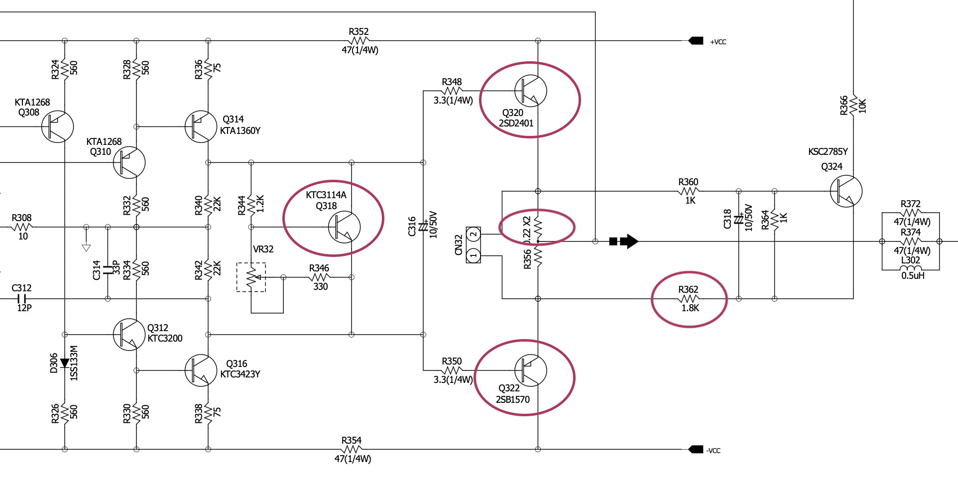

For a friend I am repairing a Harman Kardon HK3490 receiver. One of the channels was dead. After checking the output stage both output transistors, the bias transistor, a safety circuit resistor R362 and one half of the current limiting resistor R356 are broken. I have found and installed replacements but are still waiting for R356.
Does anyone have an idea what could have caused such a pretty big failure? The power supply is ok and the other channel is working. All the other transistors measure ok.

I can't imagine what could have caused but you need to replace the drivers Q314,316 THE BIAS TRIMMER VR32,the Q318,Q320,322,R536.

I have already replaced Q318,Q320,Q322 and R362. I also replaced C316 and C318 just in case. I then powered up the amp and no smoke, no DC on output. I then tried to adjust the bias and discovered that R356 was blown. As this is a safety resistor they are a bit hard to find so still waiting on the arrival.
Regarding Q314 and Q316. These are impossible to find. Any suggestions for replacements? KTA1360Y and KTC3423Y?
Ksa1381,ksc3503.
For each of 0.22ohm resistors you can use 4x1ohm metal film resistors in parallel.You need 8 pieces.

As R536 was broken no current flow and the dc check no sense.

ksa1381 is out of stock everywhere. Any alternatives? DK lists MJE340/350 as options. TTA004B/TTC004B maybe?Ksa1381,ksc3503
Update: I replaced Q314 and Q316 with TTA and TTC. Also replaced the trimmer and R356.
Turned on the amp with lightbulb inline. No smoke but also no bias-voltage.
Turned out R348 was also open. Replaced it and voila! I had bias-voltage, no smoke!

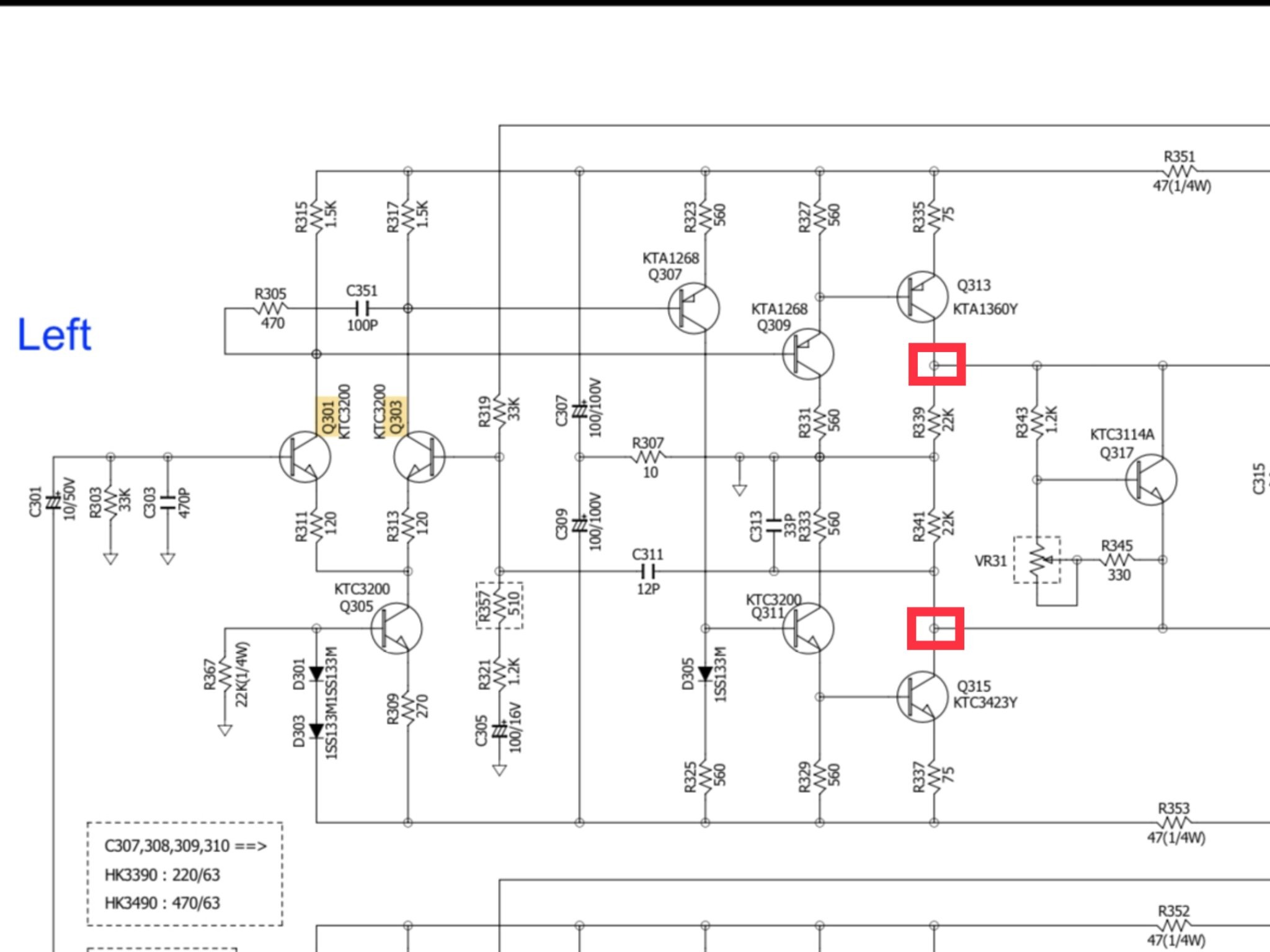

I have one that is in good shape except for an elevated hiss in the left channel. The Pre-out signal is clean, and so is the right channel output, so the problem is somewhere at or after Q301.

The signal tracer has been useful. I am A-B-ing the right and left channels. Noise is present at Q313 and Q315 so the problem is somewhere before that. I was probing Q309 and Q311 when I managed to probe the power supply and smoke my LM386 amp. Further testing is delayed until a new one arrives from Amazon.
Which brings up another issue. How in the world do you do live testing on the main board? The location of the input and digital boards on the rear chassis make it extremely difficult to access components on the main board. If I disconnect those boards I immediately get a “voltage check” error and the receiver shuts down. I suppose HK had a test setup and longer connecting cables so those smaller boards could be of the way.
On another forum a number of people claim to have successfully eliminated noise by replacing the KTC3200s in the offending channel. I must have researched this before because I have a number of replacement transistors that I ordered from eBay a while ago. They are labeled K 708 C3200GR.

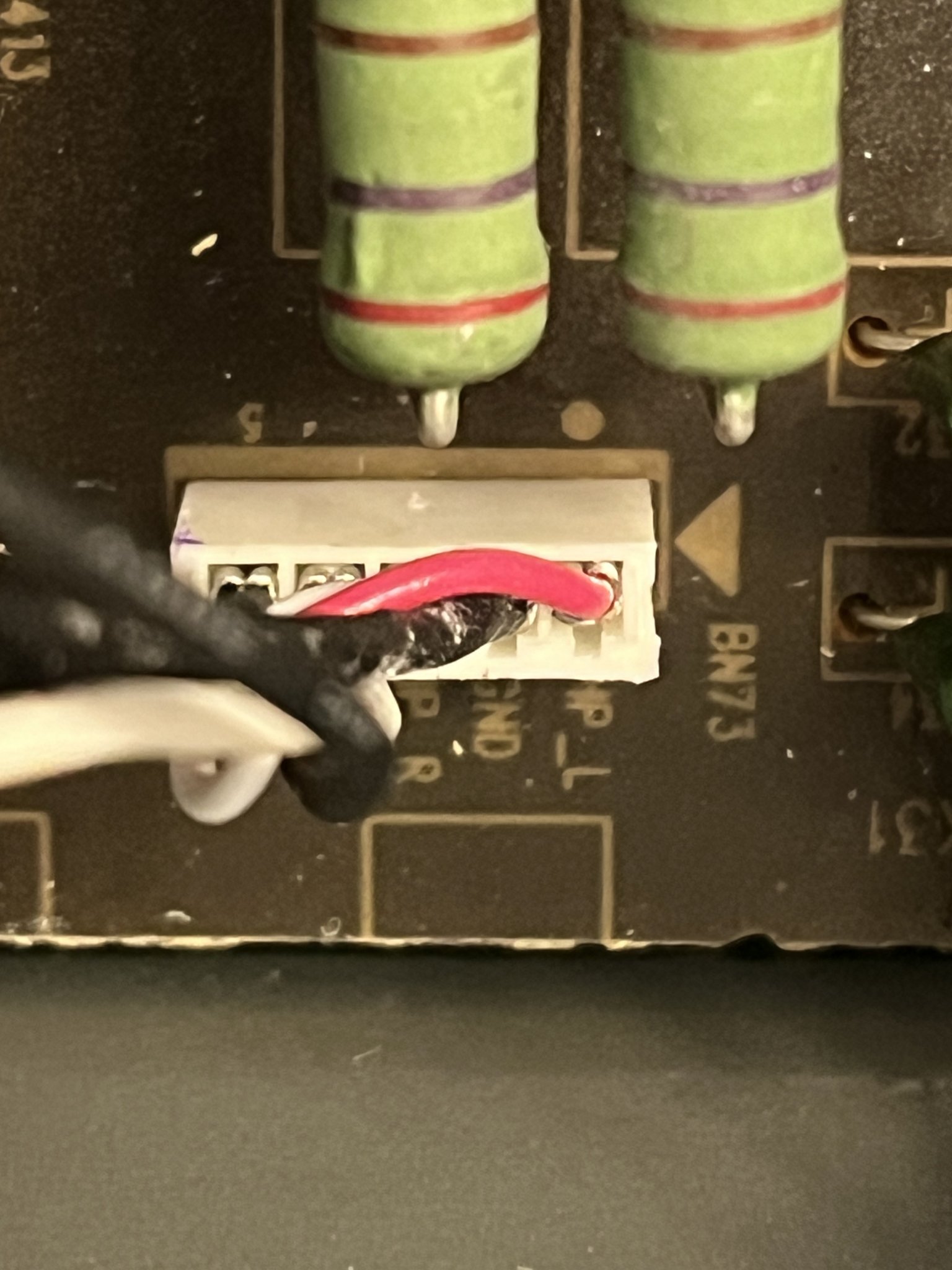

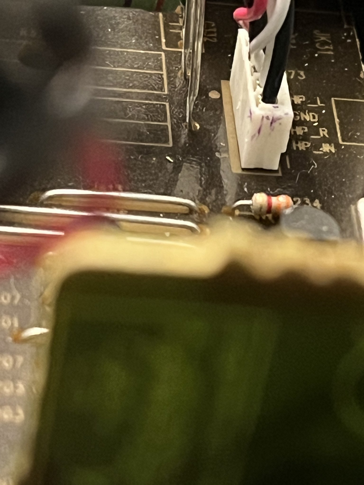

I’ve got the Main Board removed, mostly, except for BN73. What is it? It’s unlike any of the other connectors. Is it a header connector? It is resisting any attempt to lift it off any header pins. It’s in a difficult spot for applying leverage and since I’m not exactly sure what I’m doing I’m nervous about forcing It.
I can work on the back side of the board the way it is but I’d really like to disconnect that cable. The other end goes to the Phones Board and I can easily disconnect that end, but it looks like it routes through a toroid and I’d prefer not to mess with It.

The left channel noise fix involved replacing the KTC3200 Q301, Q303, Q305 and Q311. The left channel is so quiet now that it revealed a similar but much less noticeable problem in the right channel, but that’s a fix for another time.
The KTC3200 failures are a known issue with this receiver. The spec sheet states a hFE range of 200~700. The replacement transistors tested a hFE of 431. The removed Q301, Q303 and Q305 tested hFE between 60 and 86. Q311 tested 214.
