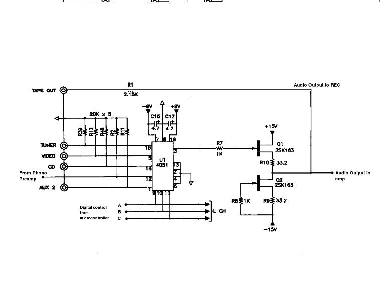

Hello, like AuroraB said, I've been looking schematic of pre-amplifier Hafler.
I have seen the 4051, has connected the audio input directly, without any input buffer. In the output it has a buffer, a FET Follower (is the correct name?).
I modified the schematic to suit what I want to do, is attached. Is that correct? If I build like this, works ok?
As I said I do not know much about analog signals. I can connect "Audio amp output to" to more than one input line of various device at the same time (without loss of signal)?
Another question, a 2SK163 replacement easy to find? I asked in my usual electronics but they don't have it.

I'd use an NE5534A or 5532A configured as a unity gain amp on both the input and output for each switch. Op amp can be inverting - which supposedly sounds better, and will maintain absolute phase since there are two.
this will likely do what you want assuming:
1. you are ok with unity gain (otherwise, you will need a gain stage following)
2. you are not driving low impedance loads. i wouldn't use the jfet buffer alone to drive loads less than about 3K, but that's my choice.
it has been my experience that 2SK163 are easy to find but a detailed data sheet is not.

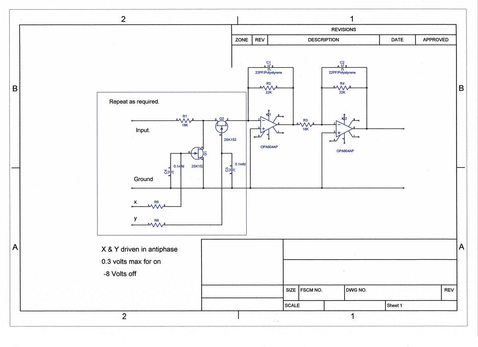

For analogue switching you can't beat this. The FET's are at the input to a virtual earth amp and so see no signal across them. The isolation is far better than any switch or relay... and that is something those 4066 are poor for, due to that stray capacitance etc. The second opamp is just to maintain correct phase.
And this lends itself to full remote control too.
Yes I can beat this with audio relay !

The dual series shunt FET arrangement gives far superior isolation than a single relay, it's cheaper, it's easier to place exactly where needed on the PCB, consumes zero power and is more reliable long term. The secret is to use them correctly so they never see any voltage... hence the virtual earth input stage... and to drive the gate slightly positive which substantially reduces the on resistance, but increase by no more than 0.3v above ground 🙂
