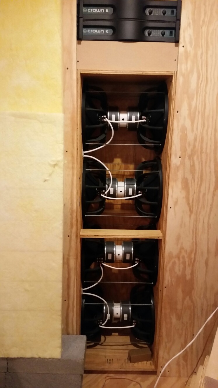

Infinite baffle subs are done by quite a few DIYers for home theaters and hifi. Drivers with a high Xmax and low Fs are preferred along with lots of displacement. You’ll find them built as multi driver manifolds too installed in ceilings with attic space above, in floors with crawl space or basements below or sidewalls with adjacent rooms that won’t be impacted by the noise from the back wave such as garages. Two manifolds with two 15-18” drivers will produce and insane amount of very clean bass. We did an install a while back with 18’s in a room that was adjacent to a garage and a Crown Macro Tech 2400 amp and 4 18’s. It was nuts!
The manifold/semi slot loading cuts down on distortion as well as drops Fs a little and raises Q…..all beneficial if done with opposed drivers well built to cut down opposing forces.

Here's an example. It is my own installation done in 2009. It's built into a jutted out corner with a closet behind it. The closet space is just under 500 cubic feet. It is obviously not portable. It has not been "decorated" as I don't have to follow any sort of WAF. Although, it could be and it should be if the owner/installer wishes to have boat loads of fun. These are Acoustic Elegance drivers custom built for me by John. These exact divers are no longer available. The Fs is 16Hz, the Qt is 0.7 The limit in response is dictated by the size of the room. My room is not HUGE, but it is above average. Essentially 19x21 The quality of the bass simply has no peer, but very few folks will pursue this sort of installation, as it becomes part of the house.

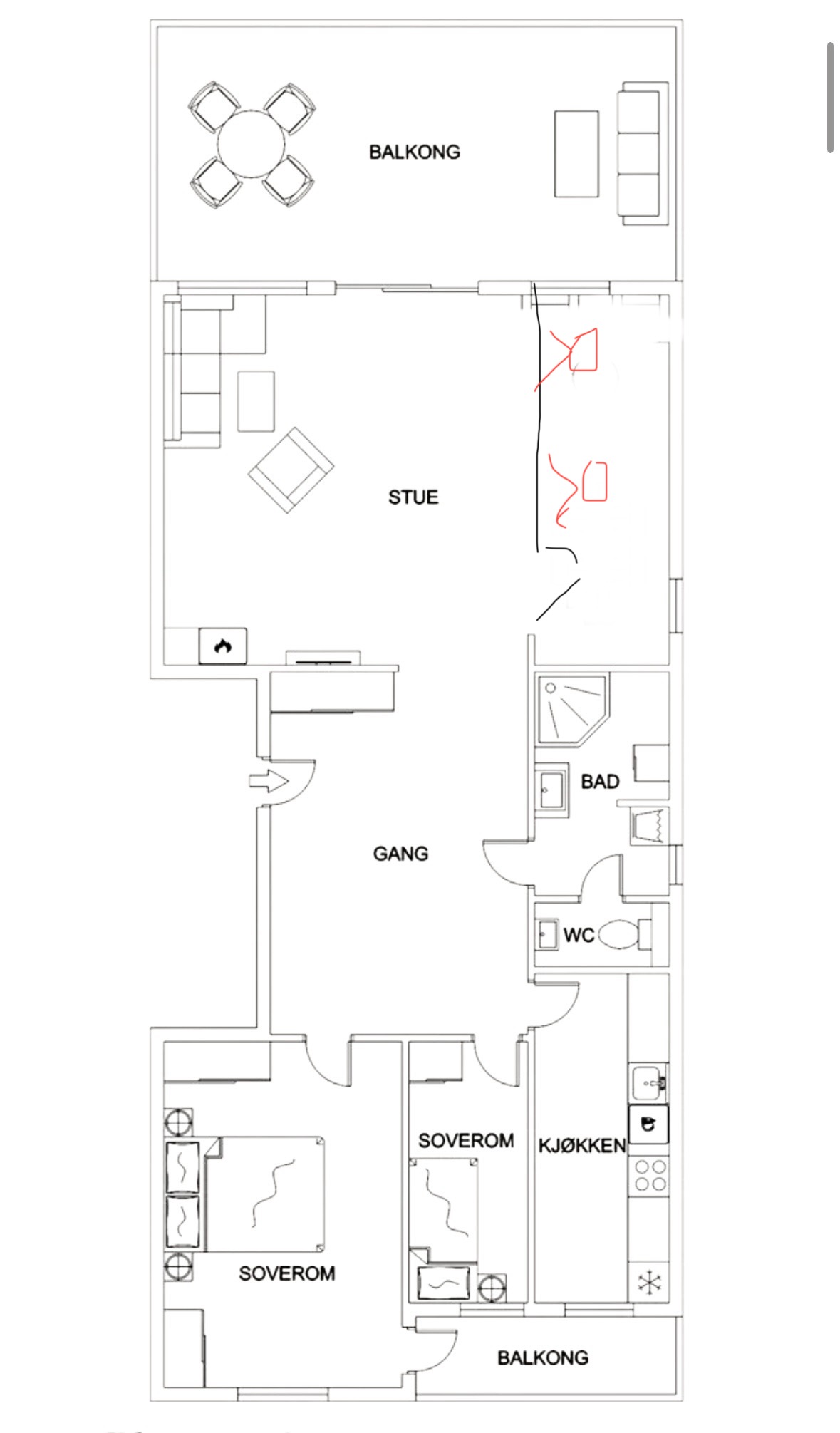

Is it possible to use infinite baffle subwoofers who is open on the rear side in the next room?
Yes.
dave
What about the door between the living room and the room behind the woofers? Will the door act as a bass reflex port?

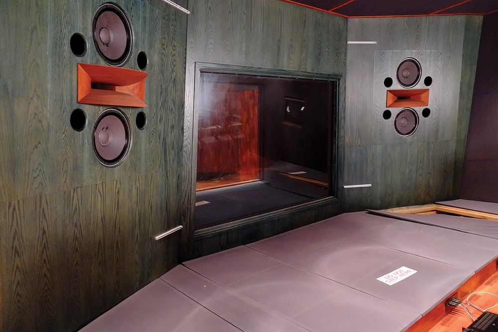

Just watch the door in a mastering studio, or how a drummer has to make his room silent in order to not disturbate the neighbors.
