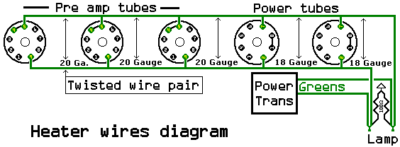

From a non-expert POV. I use:
Phono-stage and preamp
24g for signal input
20g for signal outputs
Amp
20g for signal inputs
All PSU
18g
This is for tube gear.
Amp
All PSU
18g

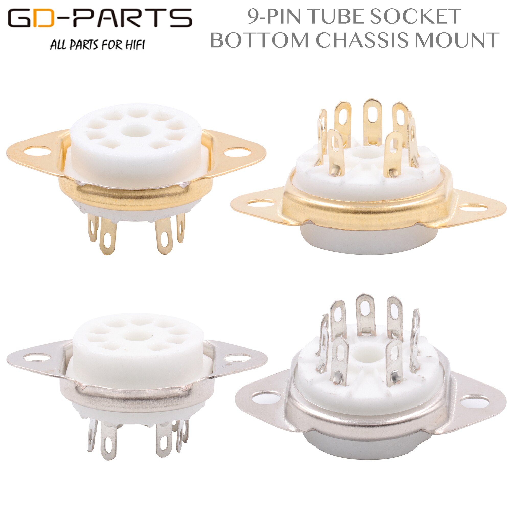

See the opening on the lug of the tube socket?, that's your size of wire you should use...& solid core of course. Some small rounded nose needle-nose pliers so you can make a radius according to the nose of the pliers. You only get one shot at bending the wire to turn it, if you mess it up & try to bend it back because you went too far, consider the wire compromised & start over. That's my take, but that's just me.
------------------------------------------------------------------------------Rick........
The point about the use of wire which loosely slips into a socket hole is spot on, actually. Which is why I am fond of smallish solid conductor wiring, with relatively high-temperature insulation. I absolutely hate it when I nip a clean, tiny bit of bare copper, bend into a hook, attach onto a socket, crimp the hook end, apply solder, and have the insulation pull-and-melt back down the wire. Grrrrrrrrrrrrr!!!!!
I tend toward 22 GA for everything. Filament wiring is pre-made (a moi) with two different colored 22 GA wires; Its a nice skill, but if you take a helper and an electric drill, you can cut a couple of 3 ft ÷ 1 meter long pieces of insulated wire, fit them to the chuck, have the helper hold the end pointing toward you. Wearing cloth gloves, you just pinch the wire near the tip. As it spins, the individual wires rotate axially, which yields a twisted pair cable that doesn't unravel.
Hookup wire never needs to be very long, so once you get the hang of it, just make a half dozen of these things and hang them on a wall or inside a cupboard door. Always useful.
Since I 'star source' my filaments (i really don't like chaining them), having only 22 GA filament runs, even for my 6550s is just fine. Max, 0.5% losses.
