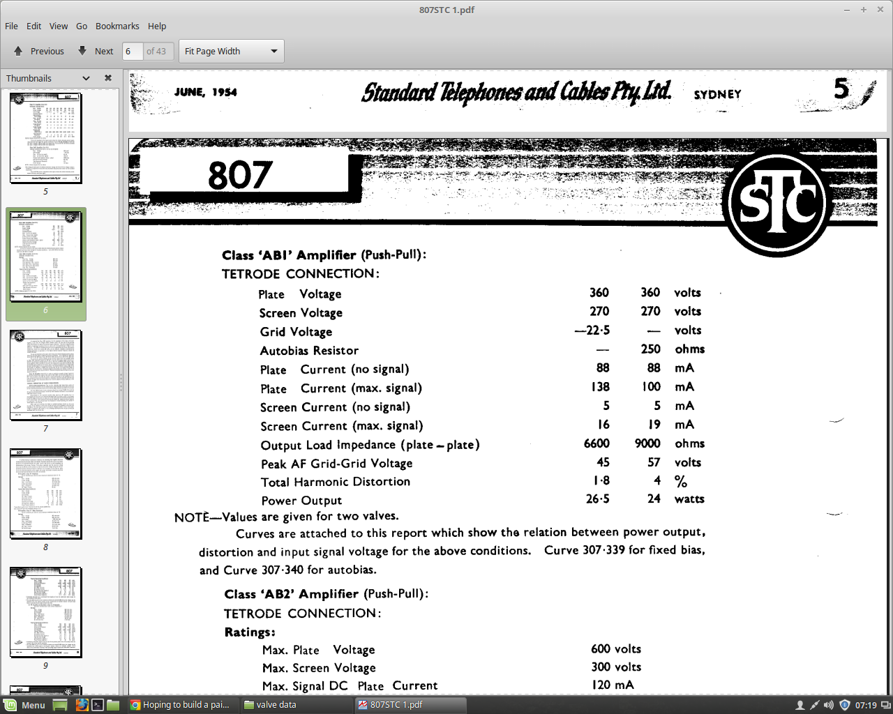

Next I'd start by having a look at this datasheet - http://people.physics.anu.edu.au/~dxt103/audio/807/807STC.pdf which is the best 807 datasheet. If you look at page 5 it says Class AB1 tetrode connection for an Op of 26.5 watts ( you'll have some gain to throw away on NFB) you'll need 360v plate/anode/HT/B+ at a max plate dissipation of 138mA, so call it 150mA times two will give you your mains tfmr specs, IE secondary of 250v (360 divide by 1.414 = 250v ish) @ two times 150mA = 300mA or 75 - 100VA. This is the rough specs of your mains tfmr. The primary if your in the States is 120v AC 60hz.
We can also get our OPT specs from page 5, it says OP load Z (impedance) is 6600 ohm's or 6k6, this is a common value, so you'll need a primary of 6k6. You could go for UL connection, taps at 43% if it doesn't cost much more ( though 360v exceeds the 807 max screen voltage, max screen dissapation is within limits, so you'll be ok to connect UL) The secondary will likely be your usual 0/4/6/16 ohm's with a power capability of 20w or higher. Getting a higher (more expensive) rated OPT is generally a good idea as it will likely be bigger and thus have a better frequency response at lower frequencies. it also gives you some wiggle room.
Once you have your transformers, you can alter your design to to fit. The "front end" and phase splitter are pretty easy to build once you have an idea of the OP stage. See here for lots of great info - How to design valve guitar amplifiers though not primarally a hifi site, it has I think the best info for beginners.
