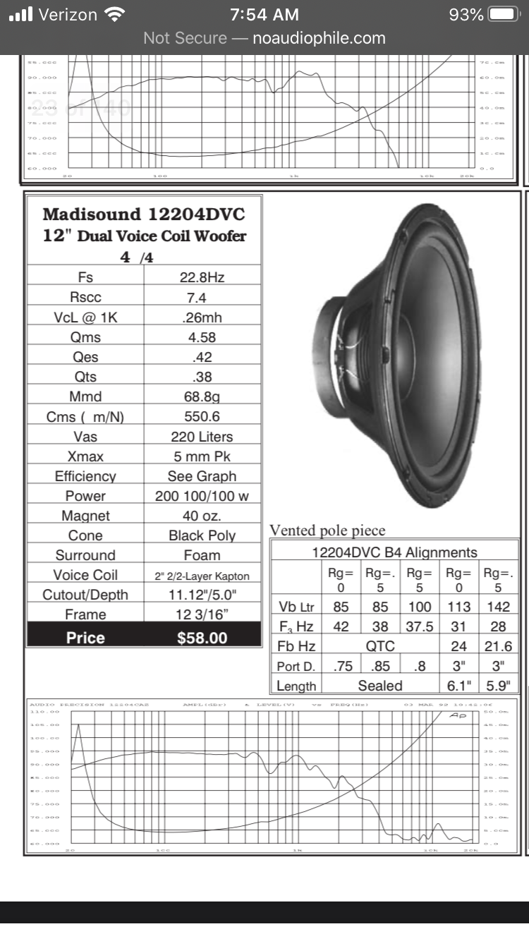

I found the other woofer. It is an old Madisound 12204 dvc. Specs in picture. It has been in storage in attic for many years and it looks a bit saggy. I think it was stored facing up and the spider is sagging badly downward. Is it ruined or could using it again fix that problem. Also are the specs any good for a horn. Thanks.

TH tuning is normally somewhat below Fs, so combined with a huge Vas, low Xmax the C12a will be tuned too low, freaking huge with disappointing output for its size/cost. The 12204 will merely be tuned too low, huge and with less Xmax even more disappointing.
Depends, turn it over and use a hair dryer to heat up its spider, surround or if you live where it's hot outside just set on a flat hot spot outside like I do each summer when I flip some old Altec, Jensen on my sidewalk. At up to > 100 degF., it doesn't take long. 😉 As long as there's no VC 'rub'........
For your app, a ~30 Hz Fs mobile audio or prosound sub-woofer with the highest Xmax, lowest Vas, medium Qts you can afford will suffice'
